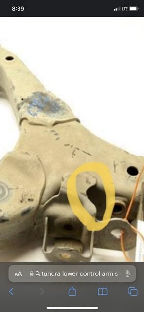

    Hello all,
    just for more input I was at about 3 5/8 inches+ on a 4.6L double cab (light for tundra) out of the box on resi 0-3 model. Adjusted to 1 and 2 threads showing to attempt to get to @AccuTune Offroad recommended sag settings/ride height article suggestions. Could not quite get there but truck looks great at 3” of lift and 24 1/2” from center of wheel to fender and within 1/2” of accutunes recommended ride height( possibly better when vehicle is occupied?). I also noticed fox changed their compressed and extended lengths on the website so not sure if that factors in. Shocks are riding great though.
    Also, I don’t see it mentioned a ton on here but lower control arms hit shock shaft at full droop so I dremeled about 1/4” for clearance and repainted ( fox engineers didn’t test this?). I had to remove shocks again to do so if I had to do over I would do this during install to save work.

  7. Apr 25, 2022 at 7:09 AM
    #97
    AccuTune Offroad
    AccuTune Offroad New Member Vendor
    Feb 3, 2020
    #42130
    322
    El Cajon, CA
    This is very frustrating and will take some time for us to adapt to this. Looks like Fox has changed a few shock lengths and are not measuring from the center of the bolt that secures the top hat to the coilover. Previously they were measuring to the to of the top hat. Not sure why this was changed. For our suggested shock lengths, we will continue to use top hat method since its easier to see and measure to.
    I'm not sure I understand this part. Shock shaft hitting lower control arm? Can you explain?
  8. Apr 25, 2022 at 7:49 AM
    #98
    Jmor6766
    Jmor6766 New Member
    Dec 9, 2020
    #55963
    138
    Jon
    SW Colorado
    2014 White Tundra TRD SR5 4.6L
    had to clearance dremel that radius about 1/4” around whole perimeter. At full droop aluminum shaft or shaft cover of fox 2.5 was binding on it. Just barely but I did not want to risk impacts on shock shaft. May have not been a big deal but seemed like a problem waiting to happen on my brand new shiny shocks.
    equin likes this.

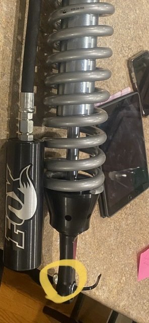

  9. Apr 25, 2022 at 8:17 AM
    #99
    AccuTune Offroad
    Feb 3, 2020
    #42130
    322
    El Cajon, CA
    Ok, you must mean the black anodized rod end, not the actual shock shaft. Got it. I wasn't aware of this issue. Did the truck already get an alignment?

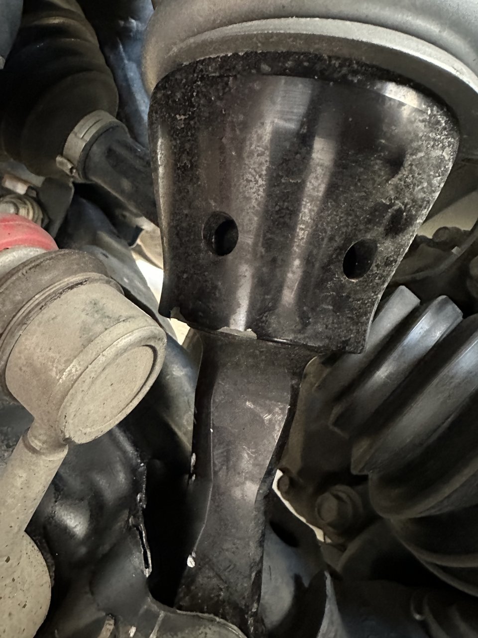

  12. Apr 25, 2022 at 10:12 AM
    #102
    Jmor6766
    Jmor6766 New Member
    Dec 9, 2020
    #55963
    138
    Jon
    SW Colorado
    Here is pic of my shock and where it was hitting. I read somewhere on the forum others having this issue as well but doesn’t seem talked about a lot. It is aligned after height adjustments and numbers came out pretty well. 3.0l 3.1r caster, -.01, -.02camber, .11, .13 toe. Caster was maxed on right side most I could get with JBA uca.
    I agree, thanks accutune! I wish I had bought my coilovers through you guys but found a price I couldn’t pass on. I will most likely try to get some rear shocks through you when I’m ready.

  14. Dec 23, 2022 at 8:01 AM
    #104
    SamuelSandoval
    SamuelSandoval New Member
    Mar 13, 2022
    #75764
    15
    Samuel
    Northern CO
    2019 Tundra SR5 TRD Sport
    Custom Dual Exhaust YotaWerx Tune S&B CAI Fox 2.5 Coilovers Fox 2.5 Remote Resi Rears w DSC Icon Rebound Pro Wheels 285/70/17 Duratrac Tires Tonneau Cover
    My shocks were also hitting on my lower control arm as well as on the sway bar links. I got my 2.5 non-resi coilovers installed about a month ago and noticed that on turns I seemed to have metal to metal contact. I ignored it for a bit, thinking it was a normal sensation because my setup was breaking in. About a week later I got down and saw my shocks were chipped pretty bad. I had to take the truck to another local shop so they could grind about 5/16” off the lower control arm. It’s probably just a cosmetic issue but I’m still pretty bummed.
    I called the shop that installed them. They said they’d never heard of that problem. They contacted Fox. Fox said they’d never seen that issue. It’s very hard for me to believe that a 4x4 shop and Fox haven’t heard of this. Turns out it’s due to improper alignment. Since the shock is thicker, the camber has to be adjusted in the lower and pushed back so the shock does contact the lower.
    I’ve since had it realigned at another shop and it seems the metal to metal contact is no longer an issue, though I’m still somewhat flustered and am constantly trying to hear whether there are any more clunk noises or sensations as I make turns.
    This leaves a sour taste in my mouth. The coilovers are not cheap, and though it’s probably just cosmetic damage, those expensive coilovers are chipped and I’m the only party that took a hit.

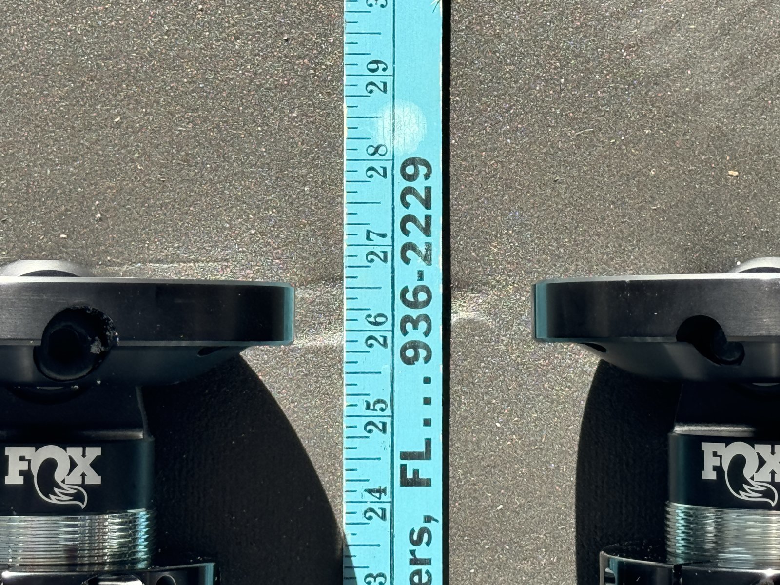

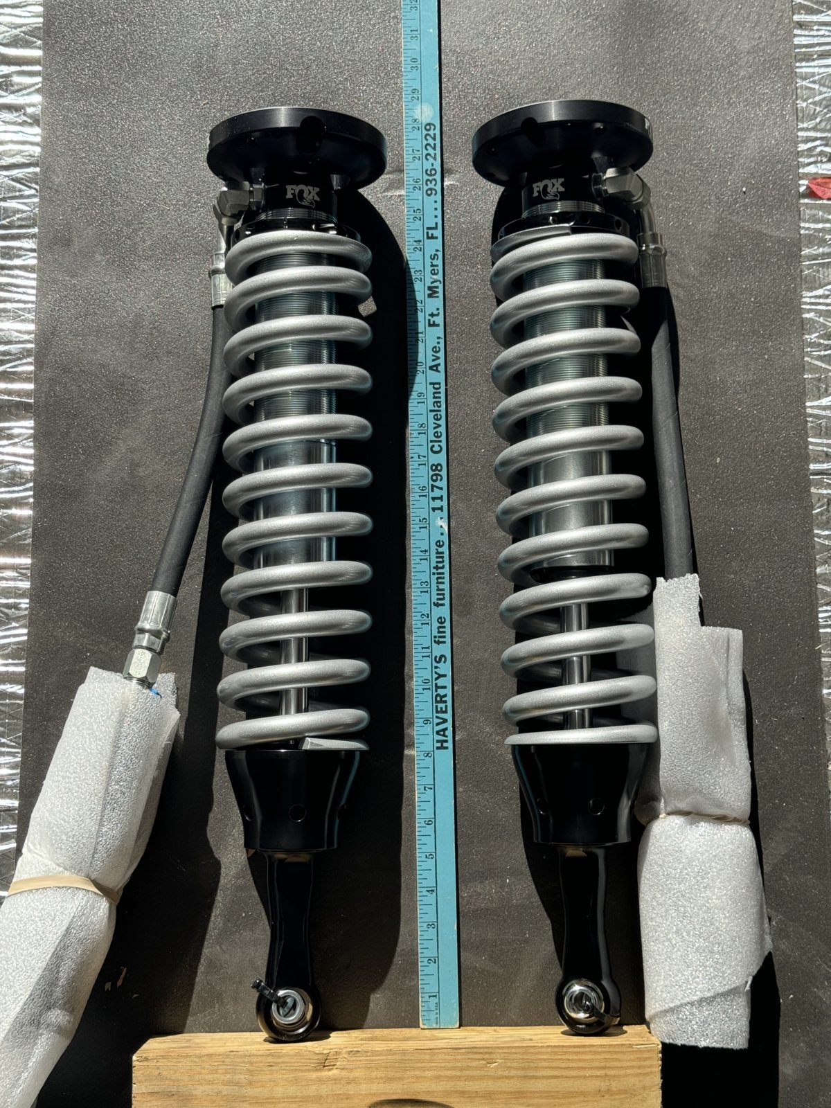

  15. Apr 4, 2024 at 5:33 PM
    #105
    TundraDude772
    TundraDude772 Shake N’ Bake, Ricky Bobby
    Apr 8, 2018
    #14307
    104
    Eric
    FL
    2010 & 2020 SR5

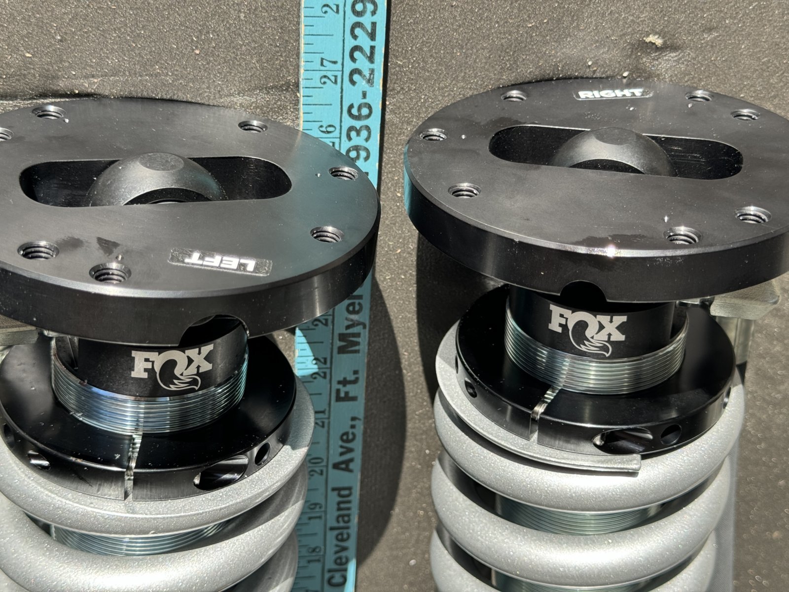

    2010 SR5 CrewMax Silver Sky Metallic 7” BDS/Fox 17x8.5 Method MR705 40x13.50 Toyo M/T Transfer Flow 46 gallon ICI Magnum front bumper PML Transmission Pan Hooke Road 18” bed rack Nature Nest Hard-Shell RTT Ironman 4x4 awning Coachbuilder upgrades SuperPro LCA Bushings Total Chaos UCA’s Energy rack bushings Moog LCA Cams 2020 SR5 Double Cab Voodoo Blue 40/20/40 Front Bench TRD Pro Grille TRD Pro headlights 17x9 Vision 351 285/70 Toyo A/T3 PML Transmission Pan RCI Skidplates eBay bumpers TRD rear sway bar
    I just picked up Fox part number 880-06-947, 2.5” with RR and DSC. When I was researching I found mixed results, some vendors saying 0-3”, others saying 2-3”. Now that I have the physical box, I see mine are stamped 0-3”. What would the difference in 0-3” and 2-3” be? Is the 2-3” shock longer overall? Or do they just change the preload from the factory?
    I only want 2” of lift just to level the front. Possibly some coach builder shims for the lean, and +1 shackles to bring up the rear a little higher.
    Judging by all the previous posts, it sounds like I should spin the preload collar all the way to the top to keep it as low as possible (lowest amount of preload). But since I bought 0-3” would that mean 0” of lift??? Post #53 shows the least preload but still managed some lift, so these coils can’t possibly provide 0” of lift.
    Anyways I’ll provide some pictures of the new shocks with some measurements. Mine appear to be evenly loaded from left to right, showing maybe 7 or 8 threads.

  16. Apr 5, 2024 at 5:14 AM
    #106
    monaco730
    monaco730 New Member
    Apr 24, 2017
    #7382
    957
    16 Inferno Tundra
    Fox shocks, TRD Exhaust, TRD grill, TRD shift knob, weathertech floor/bed liners, ARE topper, FrontRunnerOutfitters cargo rack, Relentless cargo bars, color matched front bumper/side mirrors, fuel wheels, nitto RGs, K&N intake
    Mine are set with the least amount of threads showing that i could and i still have at least 3" of lift. The 0-3" is very misleading. If you have a heavy front bumper then you could maybe get the front end to sit lower.
    equin and TundraDude772[QUOTED] like this.
  17. Apr 5, 2024 at 7:05 AM
    #107
    AccuTune Offroad
    Feb 3, 2020
    #42130
    322
    El Cajon, CA
    Fox made changes to their shock lift height descriptions. It just hasn't rolled out to every box on dealers shelves yet. On their website (and ours) it says 2-3" lift, but as you saw, the box says 0-3" lift. As long as you are looking at the same part number, they are the same shock. There was a 1-2" lift version of this shock, but that is being discontinued. Likely due to low demand. The mechanical differences btw those two shocks included internal spacer to limit extended travel and a shorter length spring. The 2-3" likely has that description bc the minimum lift height may be around that 2" lift mark. This means that even with the preload collar all the way unthreaded to the top, you may still be at around 2" lift (depending on weight). This is restricted by the spring rate and shock lengths. If you are not able to achieve the 2" lift height you want, then we could help you with swapping springs to achieve that. Hope that helps.
    DO NOT to shims, the coilovers are designed to be adjusted.
    Preload does not equal the amount of threads showing. More info on preload and coilover set up can be found [HERE]
  18. Apr 5, 2024 at 7:26 AM
    #108
    TundraDude772
    Apr 8, 2018
    #14307
    104
    Eric
    FL
    2010 & 2020 SR5
    No heavy bumper for me, so I’ll probably follow you and just adjust the coils. Did you compress the spring to adjust or did it spin pretty easy without any compression?
  19. Apr 5, 2024 at 7:55 AM
    #109
    monaco730
    Apr 24, 2017
    #7382
    957
    16 Inferno Tundra
    Didnt compress. Jack up the truck, spray the threads with wd-40, use a 3/8 (I believe that's the one, it's been a while) punch from harbor freight to turn the collar. Just be careful not to bring the set screw out too far or youre in trouble (as you probably already know).
  20. Apr 5, 2024 at 8:00 AM
    #110
    TundraDude772
    Apr 8, 2018
    #14307
    104
    Eric
    FL
    2010 & 2020 SR5
    Thank you for all that info.
    So I shouldn’t try to keep the shocks adjusted to the same amount of threads showing, and then add shims to the driver side to compensate for the lean?
    If I adjust the driver side to show more threads (more lift) wouldn’t that make the driver side ride stiffer than the passenger? Or is that a misconception?
    I’m hoping to not need to change coils, but if I can’t keep the front end lower than 2.5” of lift I’ll probably have to. I’m trying to keep the geometry at a safe angle and 3” seems like it’s really pushing it.
  21. Apr 5, 2024 at 8:04 AM
    #111
    monaco730
    Apr 24, 2017
    #7382
    957
    16 Inferno Tundra
    Don't add a shim, In my opinion. I just had a couple more threads showing on the drivers side to compensate for the gas tank. Those couple threads are not gonna make any difference in ride comfort vs the passenger side.
  22. Apr 5, 2024 at 8:15 AM
    #112
    TundraDude772
    Apr 8, 2018
    #14307
    104
    Eric
    FL
    2010 & 2020 SR5
    My coils are not installed yet, so that’s probably the most ideal time to adjust them.
    I’m going to try to muscle the collar as much as I can, I don’t want to accidentally loosen the set screw too much and have the collar jump threads or completely pop off.
    I’ve just got to decide if I want to leave the threads showing (I keep wanting to say preload, but I know thanks to accutune that threads showing does not equal preload) on the driver side to account for the lean, or use a shim instead. Did you do anything to counteract the driver side lean?

    So I’ll raise the passenger collar as high as I can, and leave maybe 1/4-3/8” of threads showing on the driver side. This way I don’t have to mess with shims.

    Correct, 100% do not use shims. It is perfectly fine to adjust the coilovers to compensate for the lean. Its the ideal method honestly, since you can literally dial it in to a specific height vs a one height spacer. Adding preload doesnt make the spring stiffer, that is also a misconception. Spring rates do not change when you add preload to them.
    I would agree with your thoughts on lift height and angles. If you run into issues not getting the height you want and no more threaded shock body to use, let us know.
    We highly recommend against adjusting preload with shocks on the vehicle. Yes, it can totally be done, has been done and will continue be done. Just keep in mind if you were to skip threads and damage the preload nut or shock body, its a very expensive fix. Proceed with all the cautions
