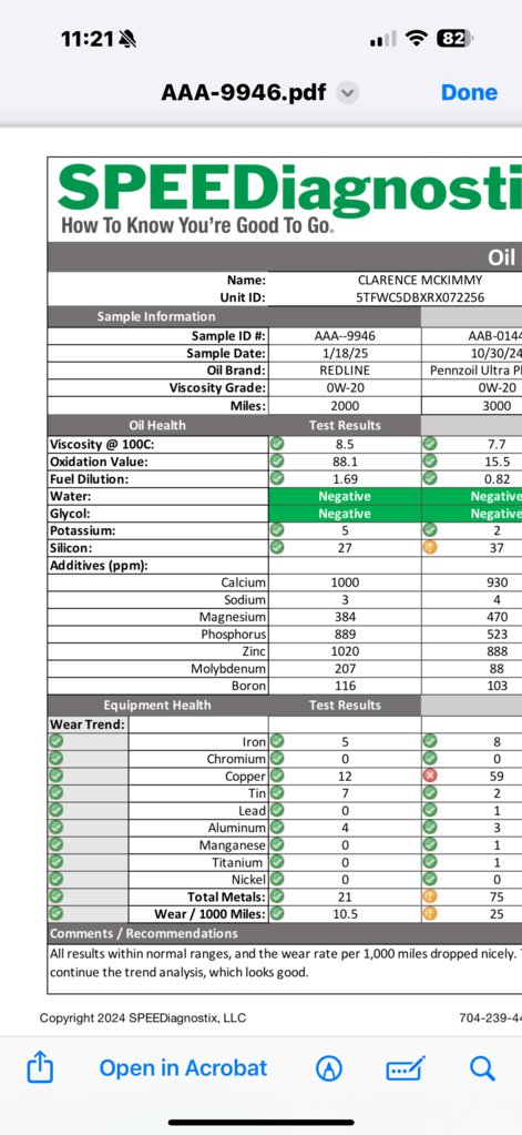

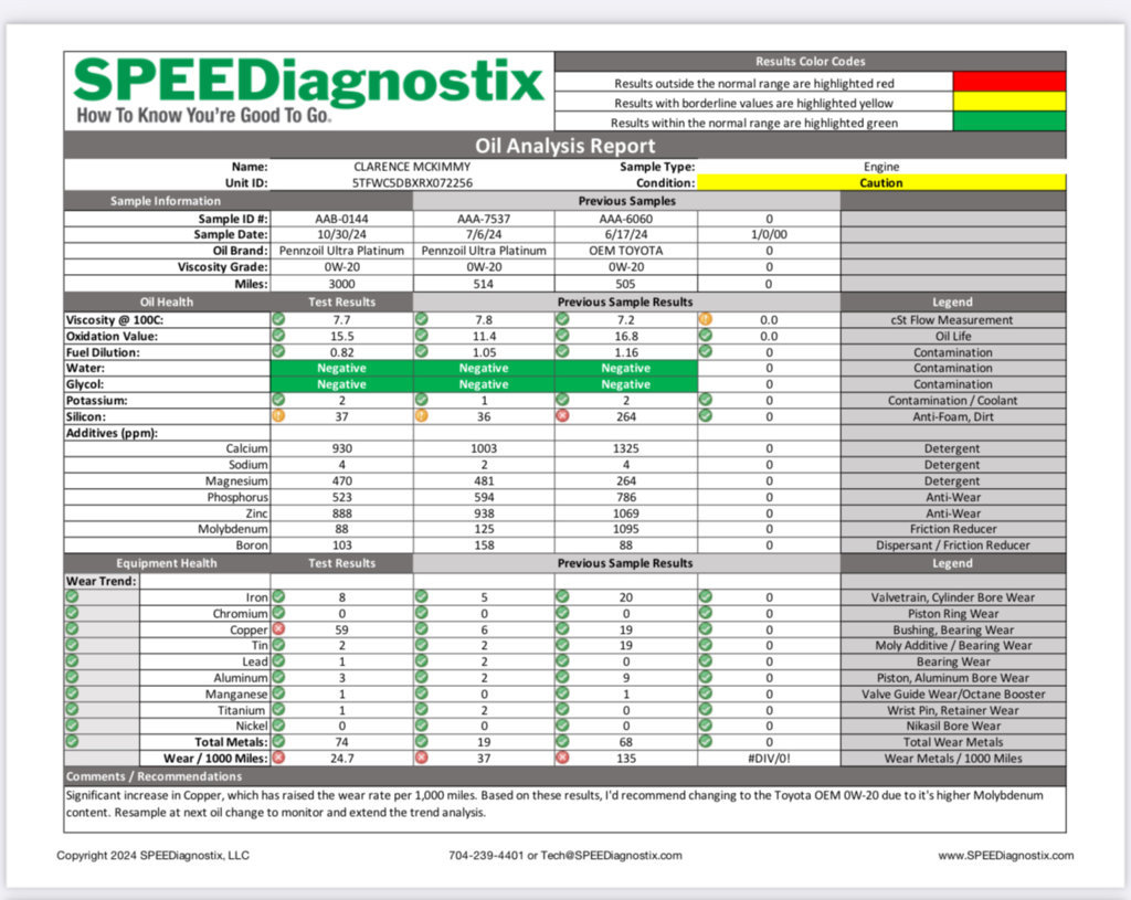

    Pennzoil Ultra Platinum and Platinum are one of the better oils out there, only reasons n I switched was needed higher moly oil according to Lake Speed.

    I think all these oil analysis are all over the map and you cannot generalize them and think that one brand of "an approved type" is significantly better than another. If you think having an oil with more Molybdenum in it is going to lower your copper content think again. Just go through the thread that was created to post oil analysis results and you will see cases where higher Molybdenum resulted in both lower and higher copper content and vice versa. Look at the one below I extracted from that thread. The Molybdenum content was going down after every oil change and so were the copper levels.

    Well according to a certified Tribologist Lake Speed, to help with my high copper reading, I needed to use an oil with higher moly than Pennzoil, and it went from 59 to 12 ppm.

    One test result does not make it fact. How much does a decrease of 47 ppm really going to make in the scheme of things? I'm not a believer but if you are satisfied with it, then that's what counts.
