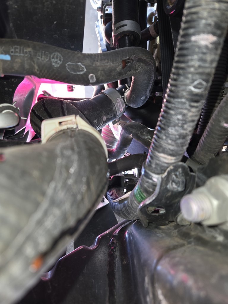

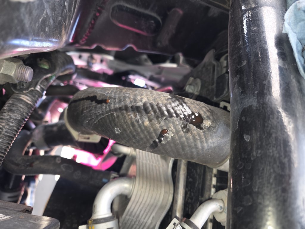

    I have put about 3500 Miles on the truck since the engine replacement, changed the oil for the second time today (will be 10k from now on but truck was at 90140 and that puts me back on the 5's and 10's for service, yes ocd...). I found I have a radiator hose leaking and the overflow tank is very low. It is engine side, not intercooler side. I will stop by the dealership in the am and see what happens.

    2023 1794 CrewMax
    Well, that sucks. Hopefully it's something minor like a hose clamp.

    wonder if this is a old school hose clamp situation vs this quick clamps they use now
    good luck, report back

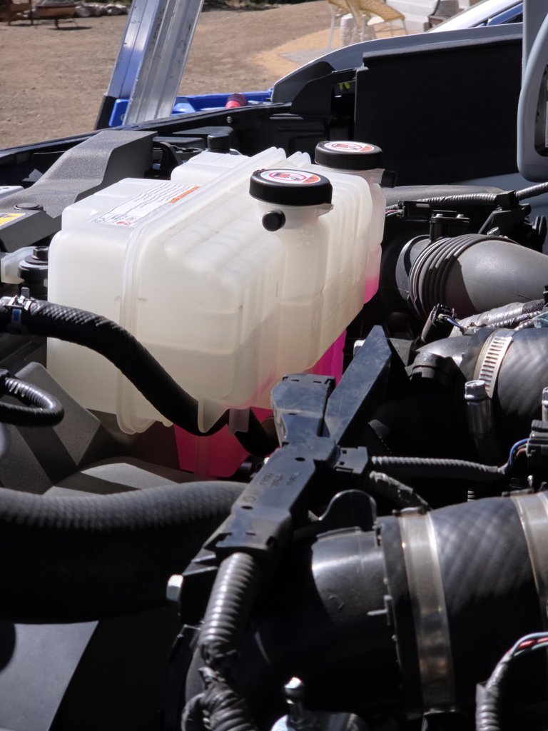

    Ok, again big shout out to Toyota of Santa Fe!
    Stopped by this am, brief talk with the service advisor, they took the truck in on the spot. Less than 30 minutes later I am on my way. Turn out the leak was above where I thought and was the connection on the bottom of the engine side overflow tank. It does have a worm drive clamp but the hose wasn't straight.
    I will keep an eye on the tank this week.

    Glad it was a simple fix.
    But I don't think I've seen a worm drive hose clamp on a modern engine for years. Sounds like the techs who did your swap cut a corner.

    want to make sure they didnt over tighten that style and cut the hose also

    THIS
    Should probably be an oem constant tension clamp

    The tech probably misplaced the proper OEM clamp, so he just used what he had in his tool box.
    I absolutely despise the old worm-drive hose clamps.

    More than likely because the hose for the intercooler overflow tank is the new style. I will just watch tank but for now it is fixed and noted for warranty purposes.
