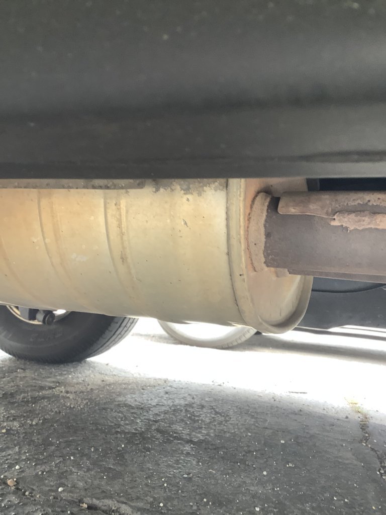

    i’m not sure what picture you’re exactly talking about, but I went ahead and took a picture of my exhaust for you. Is this not an OEM exhaust?

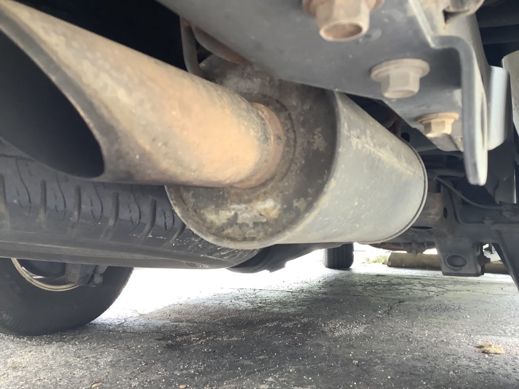

    Sure but that's only a part of your exhaust. I'm speaking of the one you posted that had a non-oem roundish looking CAT with a oxygen sensor in place.

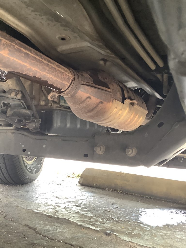

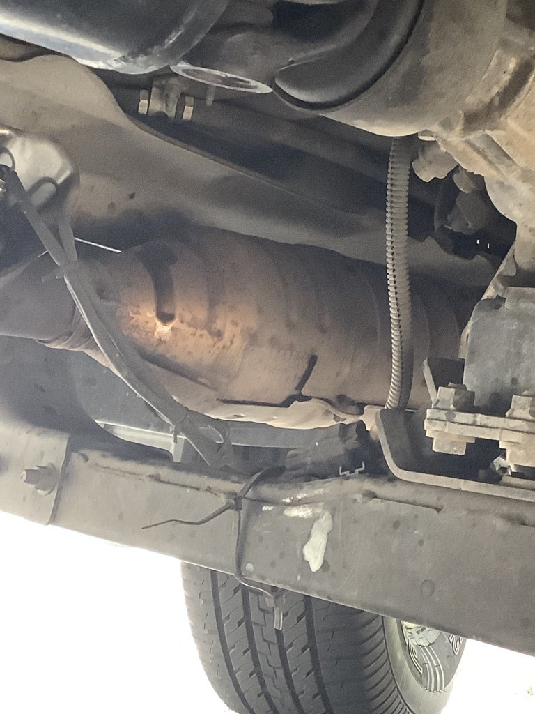

    is this what you were talking about? This is the rest of my exhaust….if this is different from what you saw, you might be confusing me with somebody else. Either that or I was using a picture from Google images for reference to something else. (You might be talking about a picture I got from Google images when I was asking about every rear main seal leak)

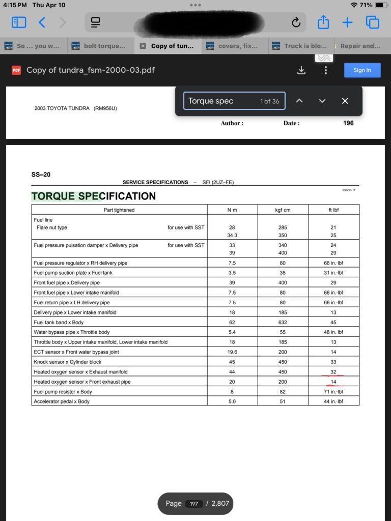

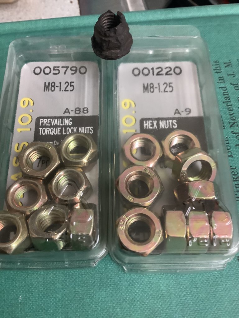

    I hate to ask this, please don’t crucify me. But which one of these is the torque spec for the upstream O2 sensors?

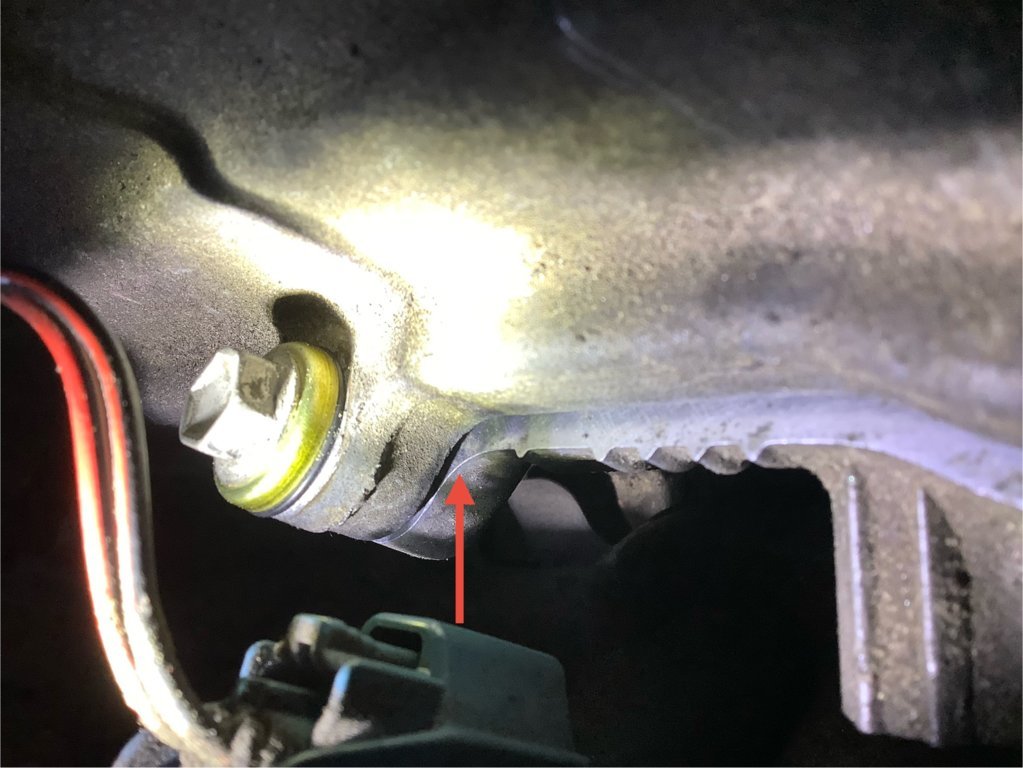

    Upstream is often called "air/fuel ratio sensor".
    I don't see any sensors in that list, but I'm partially blind.
    Speaking of seeing. It looks like someone spooged on your crossmember. What sensor is that zip-tied to it near the spooge mark?

    That's the speedo sensor that plugs into the output shaft housing. But you already knew that, didn't you ;)

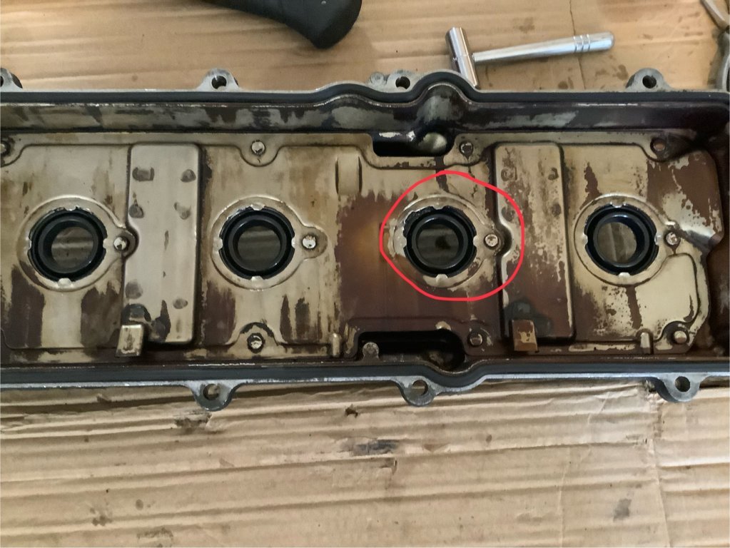

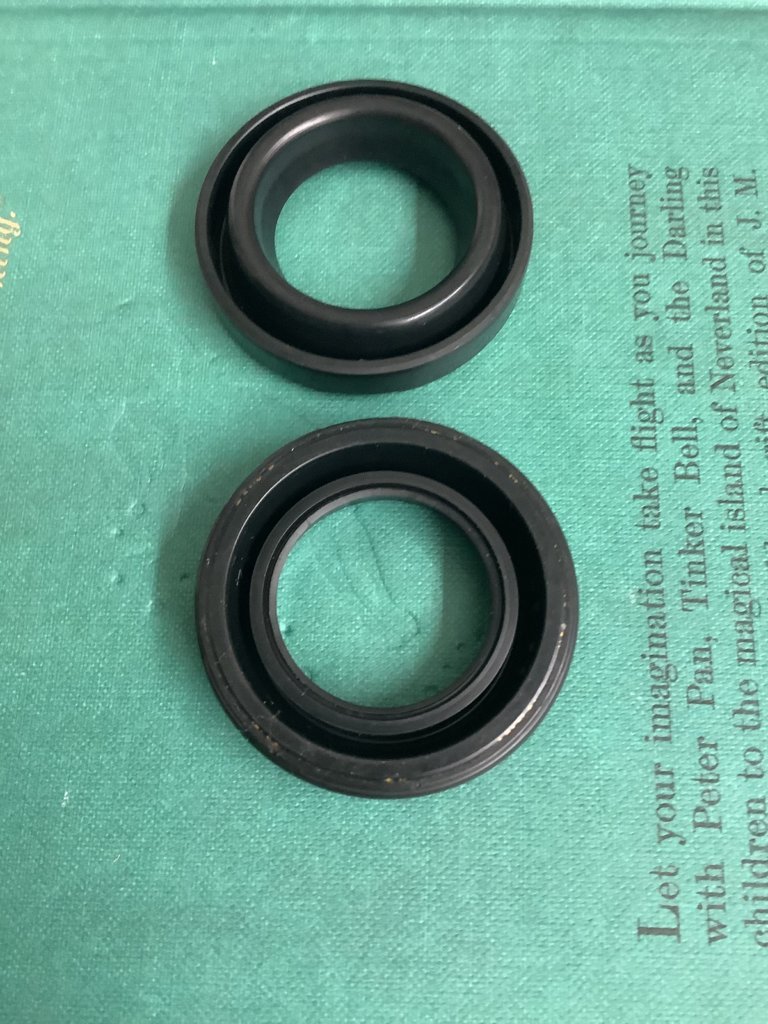

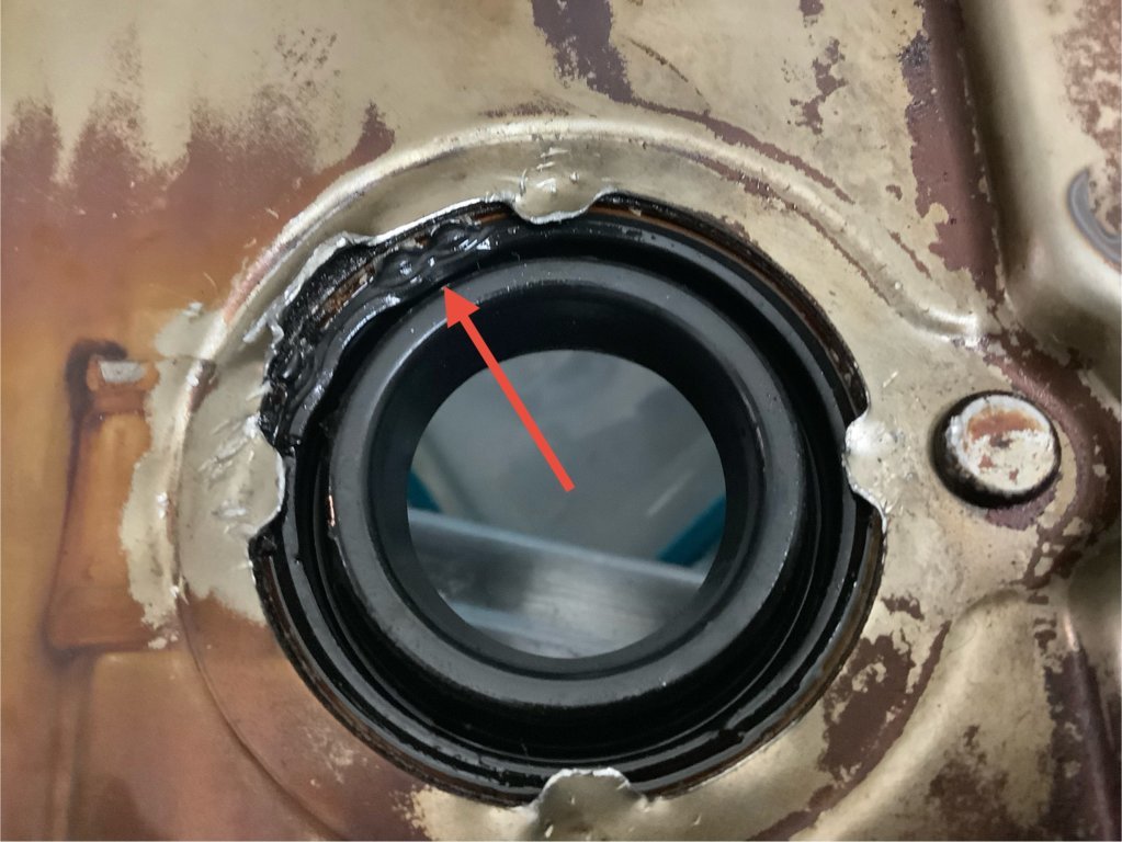

    IMG_0051.jpgWhich way do I put the spark plug tubes into the cover? Mine look different than every YouTube video that I’ve seen so far. It’s a little bit concerning, but what do I know… IMG_0052.jpgalso, which one of these nuts should I use for my downstream O2 sensors. I went to every store in the area that sells hardware and not for the life of me track down the correct flang Style bolt. So now I am left with either putting the originals back on or putting on one of the two packets. They are all the same size, but the two packets are labeled as “Prevailing torque lock nut”, “ hex nuts”. The original one is pretty beat up, but at least that one has the built in washer
  14. Apr 11, 2025 at 7:19 AM
    #104
    shifty`
    Jun 20, 2020
    #48239
    31,537
    ATL
    '06 AC Limited V8/4WD
    Inspect the old before you install the new.
    Raised part of the coil pack seal points inward toward the engine, like you see here, and this thread is linked from the 'how to do your valve cover gaskets' post offered up prior: https://www.tundras.com/threads/wha...-gen-tundra-today.2558/page-1294#post-2692231
    Avoid scoring/scratching the inside walls where the gasket mounts to, between the fat red lines here, the honed surface. And you'll need to clean out any dirt/debris before installing.
    A large socket, with the "butt" side sitting on the round gasket with a small hammer may help tap it into place. I used some wooden curtain-rod dowel (I think?) on mine, when I helped another member recently I think I used a 32mm socket which fit the outer ring nicely.
    Note the raised portion in the center of the seal, pointing inward here:

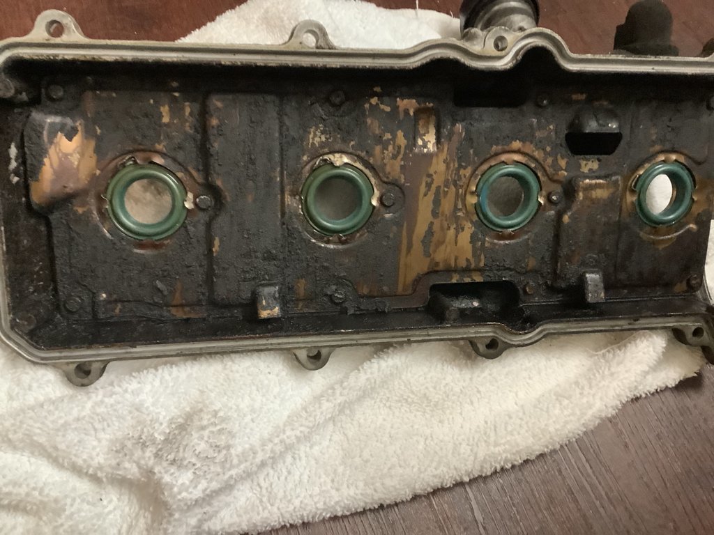

    Well this is concerning, the left valve cover is caked up in soot. The other side didn’t look like this at all… with Synthetic oil changes religiously at 5k miles, im a bit shocked it looks this bad… and yet again i see the previous person to do the VC gaskets did some shotty work, the metal is all knicked up around the tubes.
    would I be right to assume that it’s all caked up due to a clogged Pcv valve? Or is something else causing this?
  20. Apr 15, 2025 at 11:14 AM
    #110
    eddiefromcali
    eddiefromcali New Member
    Mar 14, 2022
    #75818
    3,252
    Eddie
    2022 Tundra Platinum
    100% Stock
    yep...bad pcv flow. I would not run the cover as is. Either clean it up real good, making sure its nice and clean under those baffles or just get a new one.
  21. Apr 15, 2025 at 11:27 AM
    #111
    shifty`
    Jun 20, 2020
    #48239
    31,537
    ATL
    My driver side looked like this. Most driver side covers I’ve see look like that to a degree.
    hagrid likes this.
  22. Apr 15, 2025 at 12:17 PM
    #112
    hagrid
    Dec 5, 2018
    #22645
    2,379
    Spraynard
    Pittsburgh
    K1600GTL ZX-14R
    paynuss stretchers
    OP's cover is the result of 5K mile oil changes.
    I've advocated for years a 5K yard oil change interval. Oil is cheap, valve cover gaskets are too.
    lol...

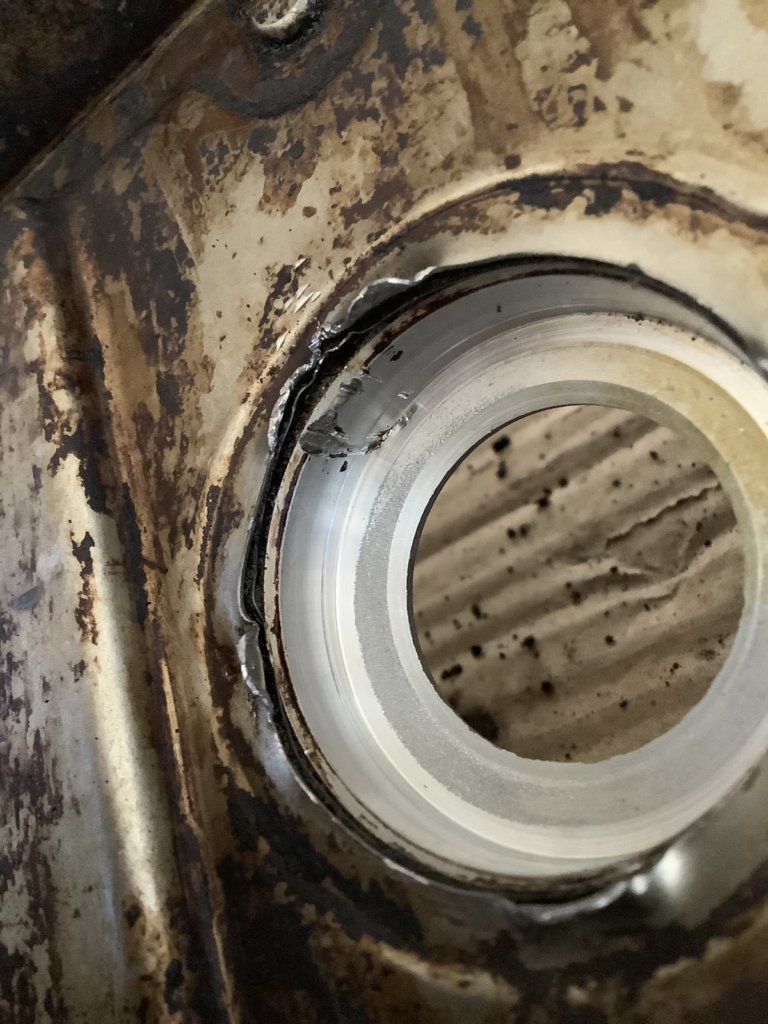

    what do you think about the metal being all butchered up on the tubes? Should I be worried about it affecting my truck? Also did you see my post up above how one of my tube gaskets has the small 2 bubbles on it?
    looks like whoever replaced these last was in a rush

    If it seals it seals. You’ll know soon enough. As long as the top flat section is good, you’re probably good. But yeah, exactly what I recommended you to avoid, I see the last hamfist in there couldn’t be bothered.
    Meanwhile, if you find it doesn’t seal, buy one from a junkyard, used.

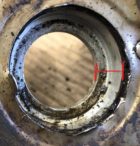

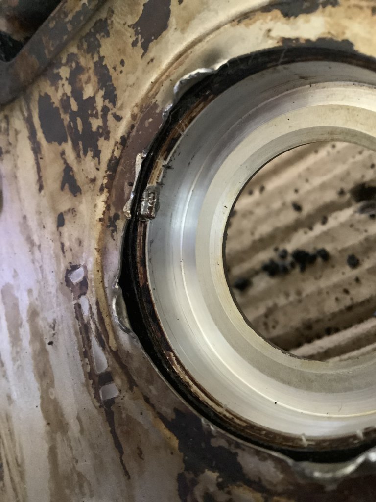

    Im pretty PO’d right now. Look at these 2 holes, with cuts into them that are probably going to make my cover leak. I’d like to have a stern conversation with the last person who worked on these…
    correct me if I’m wrong here, but thats exactly where you DONT want any knicks or scratches.
  26. Apr 15, 2025 at 3:57 PM
    #116
    w666
    w666 D. None of the above
    Dec 17, 2019
    #40020
    1,853
    Maryland
    04 Access Cab SR5 V8 4WD
  27. Apr 15, 2025 at 5:17 PM
    #117
    WhiteSR5
    WhiteSR5 New Member
    Oct 18, 2024
    #124457
    251
    SC
    2021 DC SR5 4x4 (guess the color)
    knock the burr down with a de-burring whip or abrasive stone. It’ll be fine.

    It’ll likely be fine. Toyota’s FIPG I think said to give no set time, but give an hour before starting the engine, or up to four hours? I forget. I let mine sit for like 2hr, then moved the truck into the garage. If you think the dealer service garage is waiting 4 hours to move a customer car out, then bless your heart :rofl:
    That gouge on that one vertical wall isn’t great, but it’s also not the end of the world. The flat is still
    Intact and will probably seal just fine against anything passing by. This isn’t a high-pressure area or anything.
