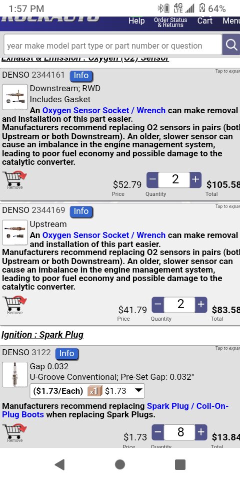

    Screenshot_20250404-135739.png Screenshot_20250404-135759.png This is my shopping list so far from RockAuto ... How does it look? I tried to go with the Best brands possible as recommended by you guys... I drive a 2002 Sequoia rwd,
    Is this everything that I will need? I already have MAF spray cleaner, and a seafoam throttle body cleaner as well so I don't think I need to add those to my shopping list because they're still pretty full. I already know how to clean the MAF, but I would love a video on cleaning the throttle body out, I'm afraid I'm a damage the butterfly

    Do the Denso part numbers match what you get at www.densoautoparts.com using their lookup tool?

    Thank you for showing me that. Looks like I got it right! I’m excited to get started on my little project.
    Besides the parts im ordering, is there anything else, that is considered “easy” for a beginner, that I should go ahead and change out? I already changed the PCV valve the other day, so that’s out of the way. I also plan on flushing out my coolant/radiator. Doing a full flush with the distilled water, but I wanted to ask if I should buy one of those “coolant flushing additives” or will distilled water be enough? I plan on usuing the zerek brand of coolant, I heard that’s what Toyota uses in some of their shops.
    thanks again everyone for all the help. You guys are a serious life saver for people like me who can’t necessarily afford to go to the mechanic for every little thing. Plus it’s fun fixing on my truck, I have found a new life long hobby. This forum is starting to feel like “home”

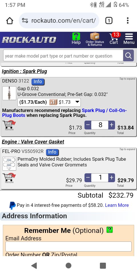

    I have somebody that is recommending the “Mahle” brand for the valve cover gasket over the “Felpro” brand. But I wanted to get you guys’s opinion on that first. They told me the Mahle is a closer to OEM fit, and cheaper (I always like it when the cheaper brand out preforms the expensive)
    EDIT- which brand of RTV sealant do you guys recommend for valve cover gasket job?

    Whoever recommended MAHLE is probably into VW or BMW or P-cars. They're a really popular gasket for that scene. It's a solid brand.
    Fel-Pro is a really popular gasket in the American and muscle car scene, which is where I'm coming into Toyota from a lifetime on this planet. It's a solid brand.
    You won't be able to beat OEM. I would just remind you. Your OEM gaskets currently installed are probably original, and they're lasted, how long now? 22 years? So I'd ask: Why in the fuck wouldn't you just buy OEM again, knowing it may last you another 22 years?
    Here's the one thing I'll tell you: MAHLE, Fel-Pro ... they can and will change their material sourcing at any time, without any customer notice. This is what Moog has clearly done, Moog has been outsourcing everything to the cheapest bidder going on 10-15 years now, and their part quality has gone down the shitter, despite all the people still gushing about how great their stuff is. Toyota has pretty strict guidelines on their part manufacture, and they rarely ever change any of their material sources, they are expected to maintain the quality of their part out of necessity (brand reputation). Their rubber is known to outlast 5x over the Chubber (Chinese rubber) many cheaper parts are using these days, which will dry rot and crack within a year or three.
    Everything is in the thread I linked. Reply #59. 2nd comment. Click the link. Process and RTV reco is there. All OEM part numbers are there too.
    That FIPG is good for multiple jobs on our trucks.

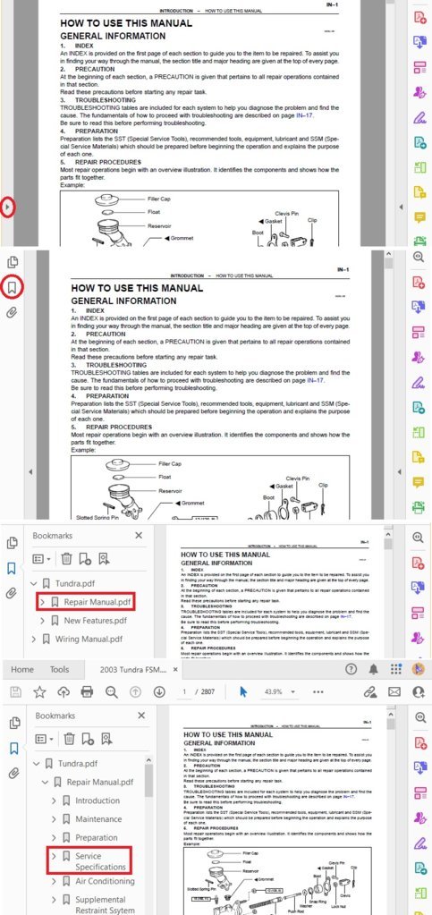

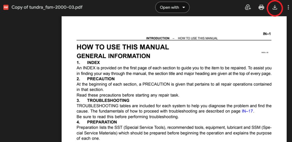

    How in the world do I navigate the FSM from that link? It only lets me go through it one page at a time, and with over 2,000 pages thats a lot of scrolling.
    Surely im missing something, there has to be a better way to read the FSM other than just scrolling down by the individual page

    Grab you a dose of "want to".
    All pdf's such as our FSM's and EWD's come with a "Table of Content". Start by clicking on the little direction arrow, then the bookmark tab....etc.
    In the 03 FSM, follow the buttons below and you'll find the section you'll need to look in...."Service Specifications". Yes, it does not spoon feed you all the way to the actual torque specs you're interested in but it's close enough if you're really interested in finding what you want.
    Find a pair so you can maintain your Sequoia without someone having to hold your hand.

    If what Bubba said isn't the problem... and it's a matter of "stuck online flipping through pages", then I'd say you and everyone else should be doing this to download a physical copy to your computer.
    • Click to open the FSM using the link in the megathread.
    • At the supplied link, once the file opens in your browser, click this little circled icon to download the PDF.
    • Go to your file downloads, and open the PDF file; if you don't have a PDF reader on your computering device, Foxit is free, safe, and better than Adobe.

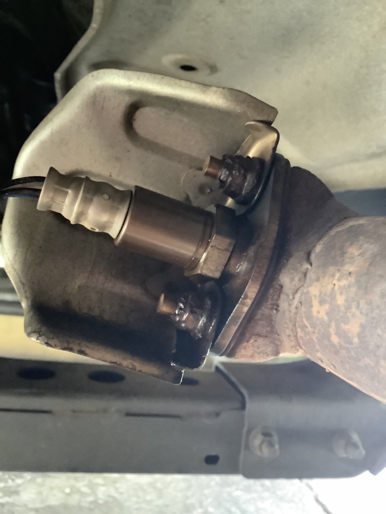

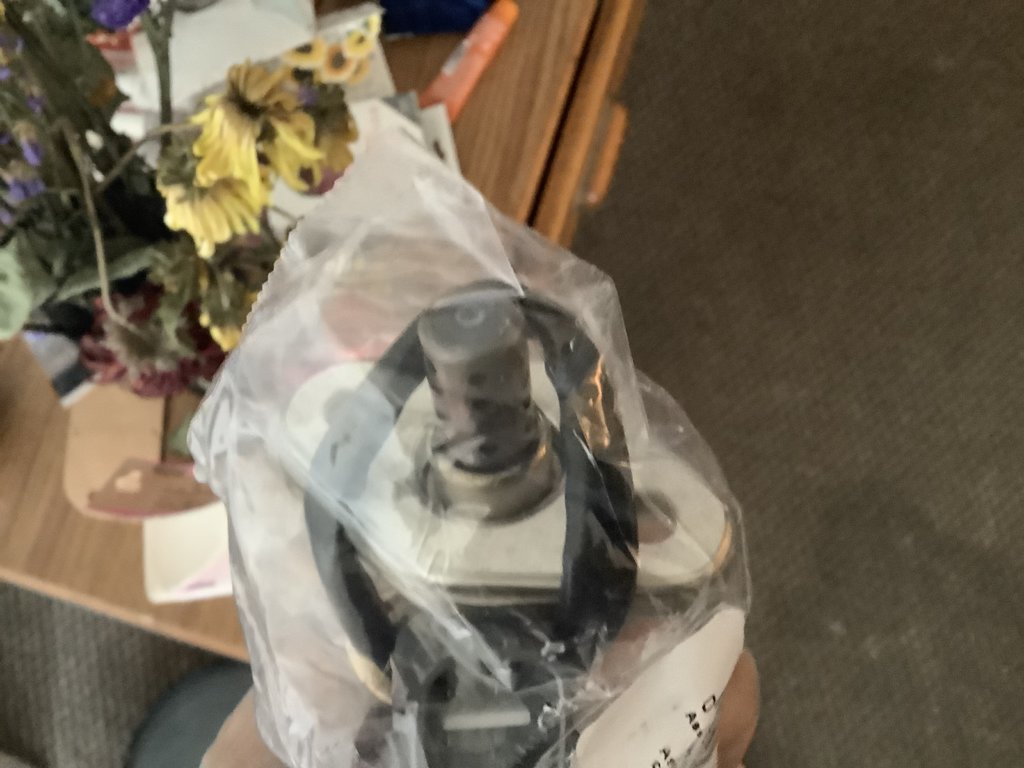

    so I just got my order from rock auto and it looks like my downstream O2 sensors are the wrong ones… I double checked on the Denso website to make sure the part number was the same as what I was ordering on rock auto. I double and triple checked, and confirmed with about two or three other people that I was ordering the right stuff according to parts numbers when I’m looking at the downstream O2 sensors on my truck, a 2002 Toyota Sequoia RWD, it does not have the gasket like this one in the picture from rock auto. I’m learning a hard lesson to always look at the part I’m ordering before I place an order. But what is going on here? Why in the world do all these websites say my downstream is supposed to have the gasket when it doesn’t? Is there something I’m missing here? Denso doesn’t even sell the “correct” ones on rock auto from what I see. I just hope that rock auto’s return policy is easyIMG_0037.jpg
  20. Apr 10, 2025 at 10:52 AM

    Looks just like my downstream sensors did.

    I must be missing something here? From the way I’m looking at it. My upstream and downstream look exactly the same

    Yeah I’m an idiot, I need to SLOWWWWWWWW down and take my time. Once I really looked at it I figured out just what I was missing. It looks like everything is OK and I have learned a good lesson of just taking my time and not just jumping shit as soon as a new little inconvenience, pops up

    Is that not exactly what you showed us you received?

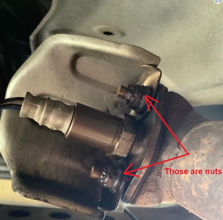

    That is the old one that is on there in that picture. The reason it scared me is because it has the bolt on it and the new one doesn’t but I’m guessing that bolt comes off and I just put it on the new one right?

    The new one does not have that what I circled in the red and that is what scared meIMG_0038.jpg

    It's not needed, take the nuts off to remove.
