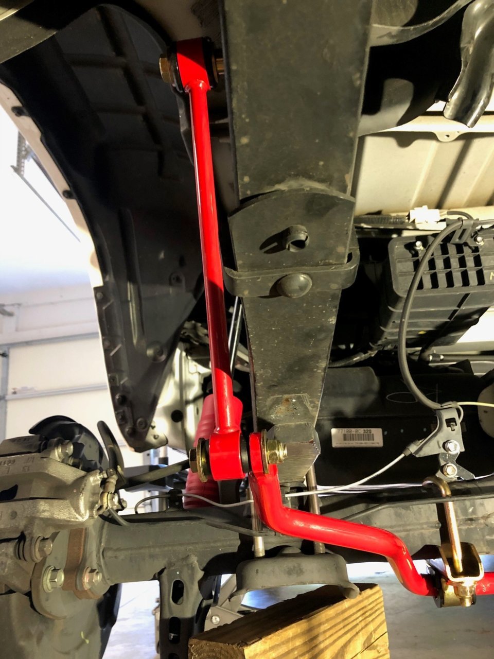

    As information, the rear sway bar will contact the rear leaf spring when close to full articulation on one side:
    Wynnded and Oey12 like this.
