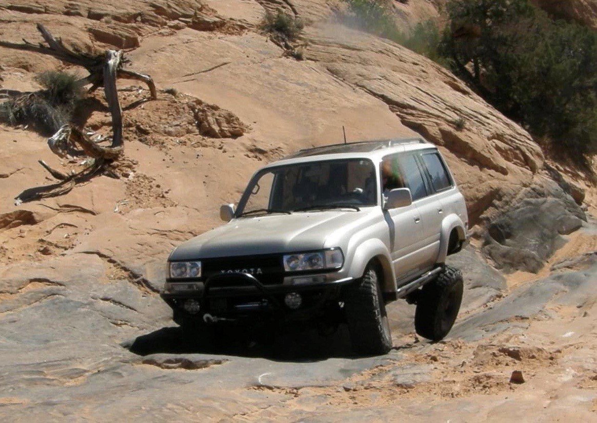

    As I said it is all personal preference, some like driving with the windows down some do not. I hope you decide on what you need and hopefully someone will have a setup similar to what you are wanting to do so you can feel it first.
    FWIIW This is a pic of me driving my LandCruiser through the Wedgie at Moab. The rig has stock sway bars in front and rear

    You're saying the trd sway bar is for a stock truck only? That's weird. Based on the pic above that land cruiser (assuming it has at least some lift) is killing it with that bar in place.

    Looks broken. :eek2:

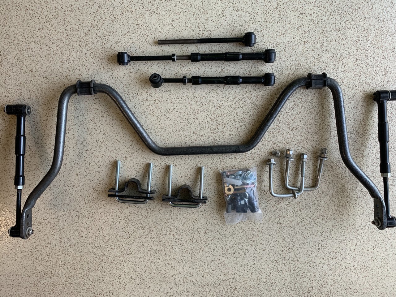

    If you take in consideration what goes into the Engineering of designing a sway bar when the truck is lifted the dynamics change. The reason the LandCruiser is killing it is because when I put the lift on I also modified the mounting points of the sway bars to move them in a position to perform more like the stock ride.
    The beauty in the Hellwig sway bar is that it comes adjustable and covers from 2”-4” lift
    You can see in this pic the adjustable links on the side and also the 3 holes at the end of the sway bar for a soft, medium and firm ride adjustments
