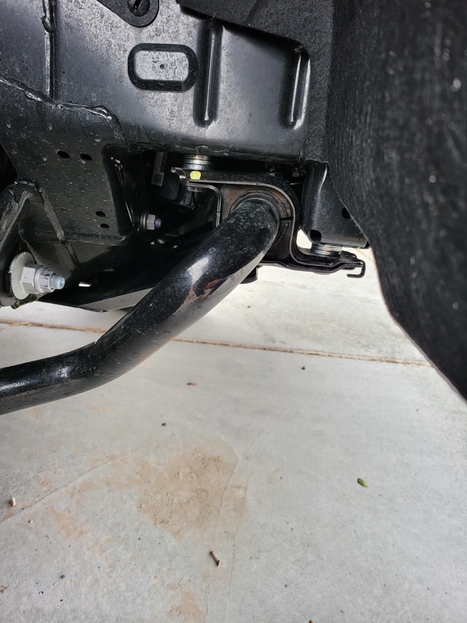

    SR5 got mine done today and could not be happier. Also that sway bar is supposed to go under the skid plate. At least that is how they did mine.

    Pretty sure he meant a pic how the sway bar was installed. I'm guessing they left out the sway bar spacers.

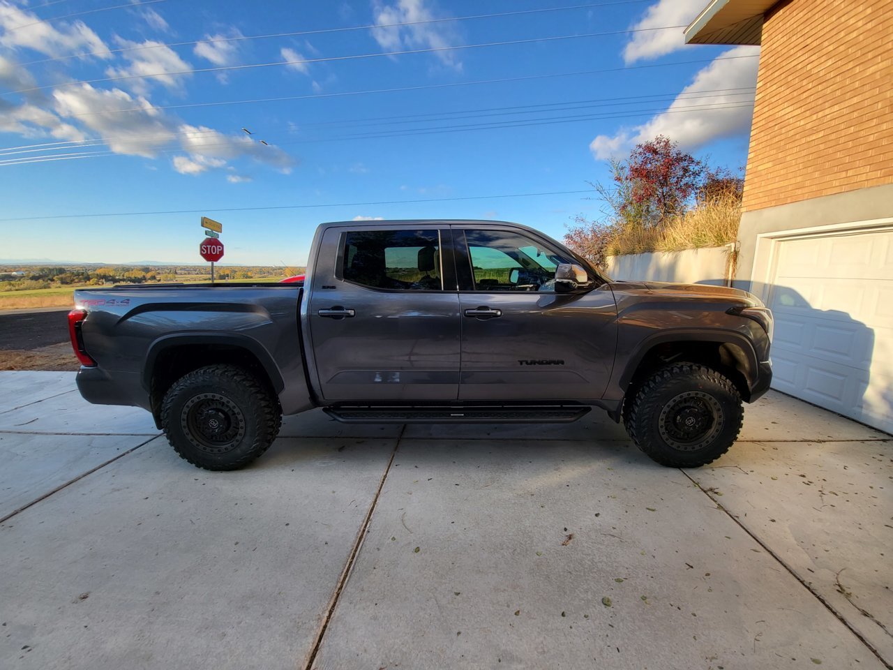

    I went with the Yokohama Geolander M/T g003 285/70/18 Wheels are Black Rhino Abrahams with a 12 offset. Rubbing before yes, rubbing now no. Rubbing was not bad and would have stopped once the tires wore down a little bit.

    Yeah, this is a completely different skid plate but interesting either way.

    Looking at the photo it does not look like the spacer included with the kit was used at all. It looks like it’s position the same way as the stock one.

    This dealership 100% did their own thing with this sway bar. It doesn't look like they used the block drop brackets from the kit and instead went with smaller shim/brackets similar to what Icon/Fox/King does.

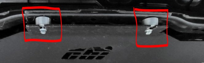

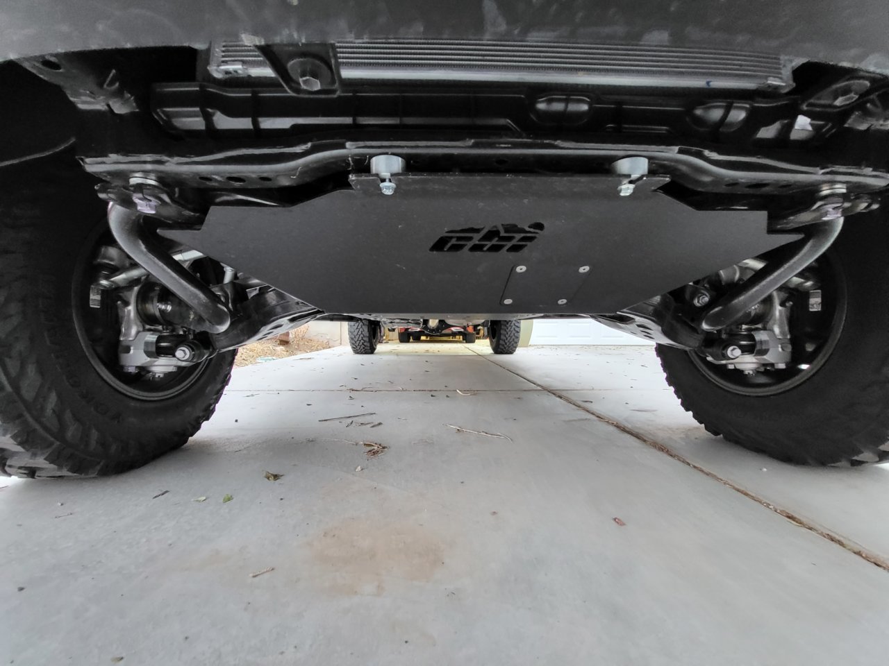

    On a side note: After talking with @romanlegion and directly with Icon...I'm planning on shimming my TRD skid plate in the same fashion as this to retain the sway bar protection.
    Icon's tech team said their sway bar bracket drops it by .75" and thus would require the TRD skid plate to be shimmed by the same amount to prevent clearance issues.

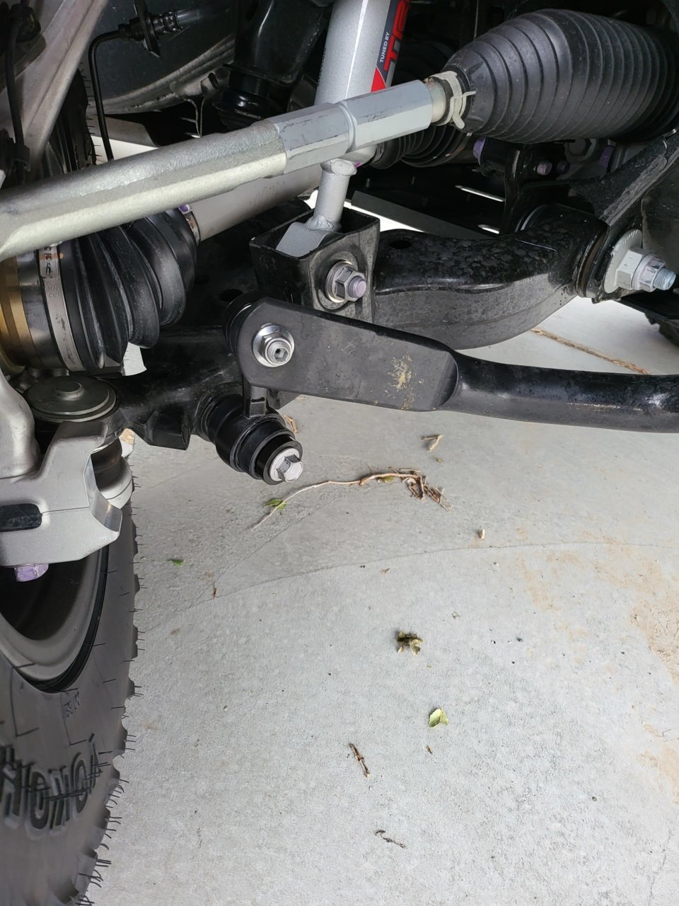

    Hope that helps

    To be honest I bought that mechanic lunch and asked him to be super careful with my truck. Plus its their first lift at this dealership and they used mine to take pictures with so I expect that this is not the norm.

    There's a reason the aftermarket uses full plate brackets instead of just washers. It's spreads the lateral forces out across a wider area. Structurally...washers aren't the soundest option, but I'm sure it'll work ok for most applications.
