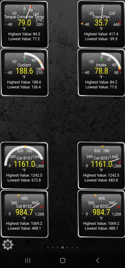

    I tried these settings on my 2020 but I don't think it's working right. My converter temp didn't move much, and my pan temp was all over the place. Plus my O2 sensor temps seem really high.

    You probably have the converter and pan reversed. With that said, the temps are much too low, they should be closer to the coolant temp. My guess is that the math is wrong.
    Regarding the cat temps, I don't believe that they can be measured with a scan tool if at all. What I've read is that the computer estimates temp base on some algorithm.
