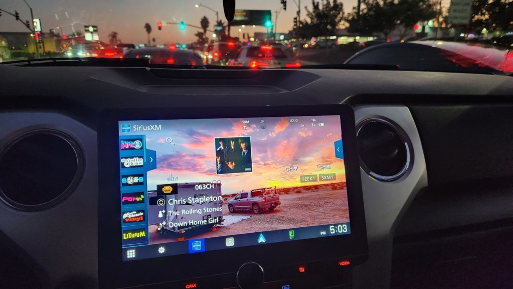

    I have read through all the threads and posts, installed the new HU so I can monitor temps, and thus far I'm pretty happy with the numbers.

    I will say the whole trans temp thing was a great way to help justify the cost of the super cool Kenwood. "Honey, a new transmission is like $7K! This stereo could save a catastrophic failure! Plus you can watch Netflix on the way" :rolleyes::thumbsup:

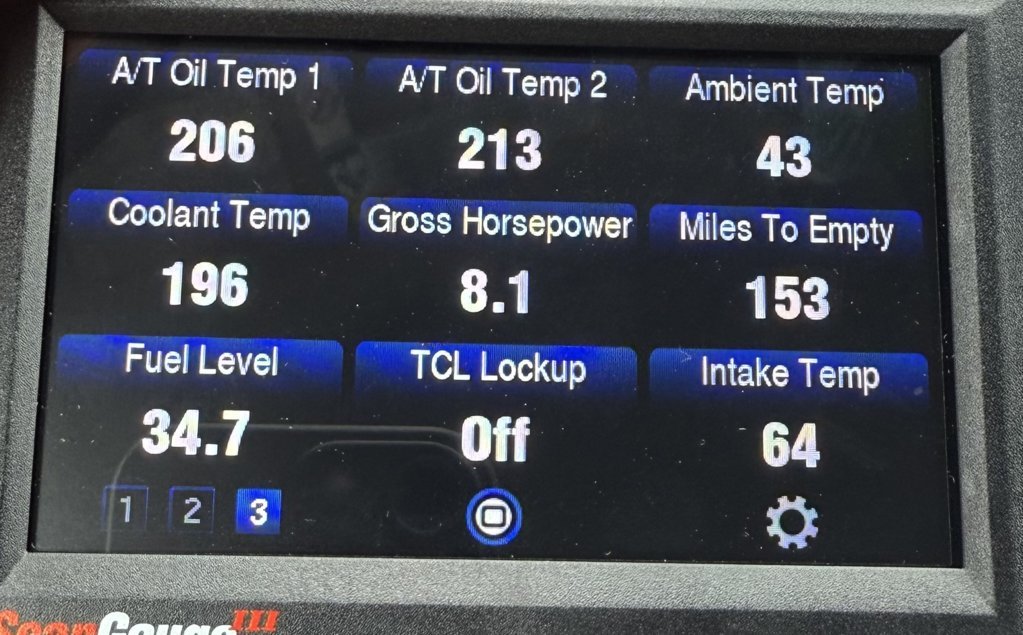

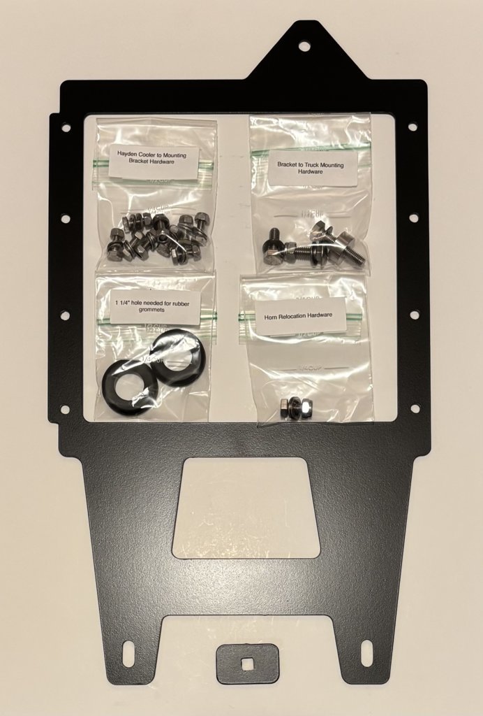

    I guess from my research they changed the transmission shift points to help it cool more.
    Here are my temps from just driving around town today, ambient temp is 45 degrees F and raining. I go up and down hills all day.
    Thoughts?

    The one kit by Sebus is sold out for a while, might piece one together and use the Hayden kind. Just went for a trip and noticed pan temp reached 215 degrees and TC at Peaks at 250 at hill climbs. Can’t imagine when warm or if hauling. Definitely a good idea. I’ll probably buy all the pieces and do myself when weather improves in my area.

    Please read Ahead of installation the 3 Ways the cooler manufacturers recommended installation locations and which is most and least effective at cooling.
    Most effective is straight up against the A/C condensor - next most effective is behind the radiator (who knows why someone would put it there) and the LEAST effective is to mount it a few inches in front of A/C condensor.
    So choose whichever mounting location you want but there are differences in effectiveness depending on just how much cooling you are after.
