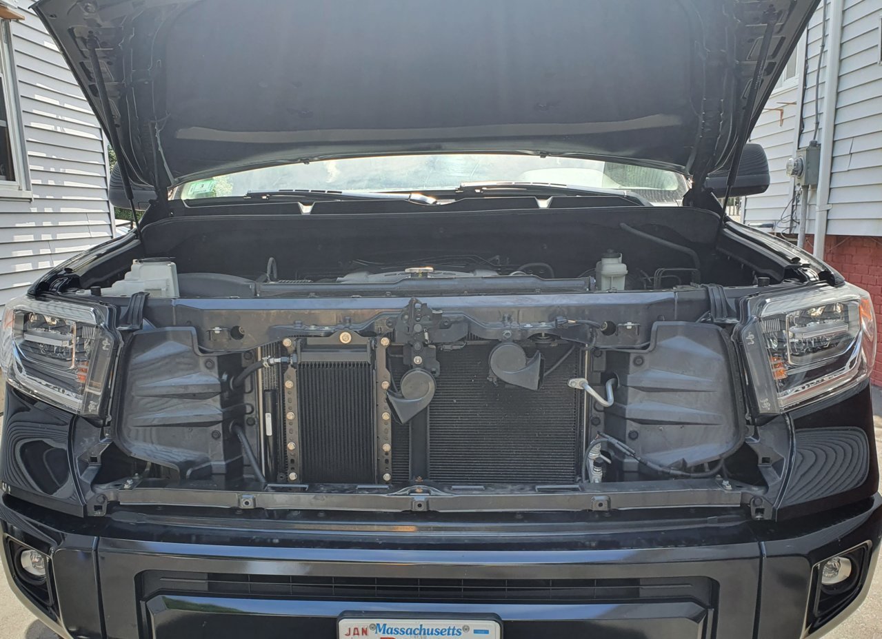

    vtl
    vtl New Member
    Mar 23, 2020
    #44238
    2,944
    Boston 'burbs
    2019 Red SR5 DC 4x4
    2019+ have a coolant-ATF heat exchanger, but not a transmission cooler. Cost me around $600 in parts to reintroduce the cooler.
  18. Nov 15, 2023 at 4:56 AM
    #48
    Eaganite
    Eaganite New Member
    Apr 5, 2020
    #44669
    440
    Gary
    Eagan, Minnesota
    2020 Limited TRD
    The thermostat is designed to keep the temp at 195, if you remove the thermostat (pinned) your going to run cooler.
    If you were to remove the engine coolant thermostate the temperature of your engin coolant would fall below the themostats temp setting.
    Thermostates are designed to maintain a set temperature, pinning it open efectivly removes it from the system.

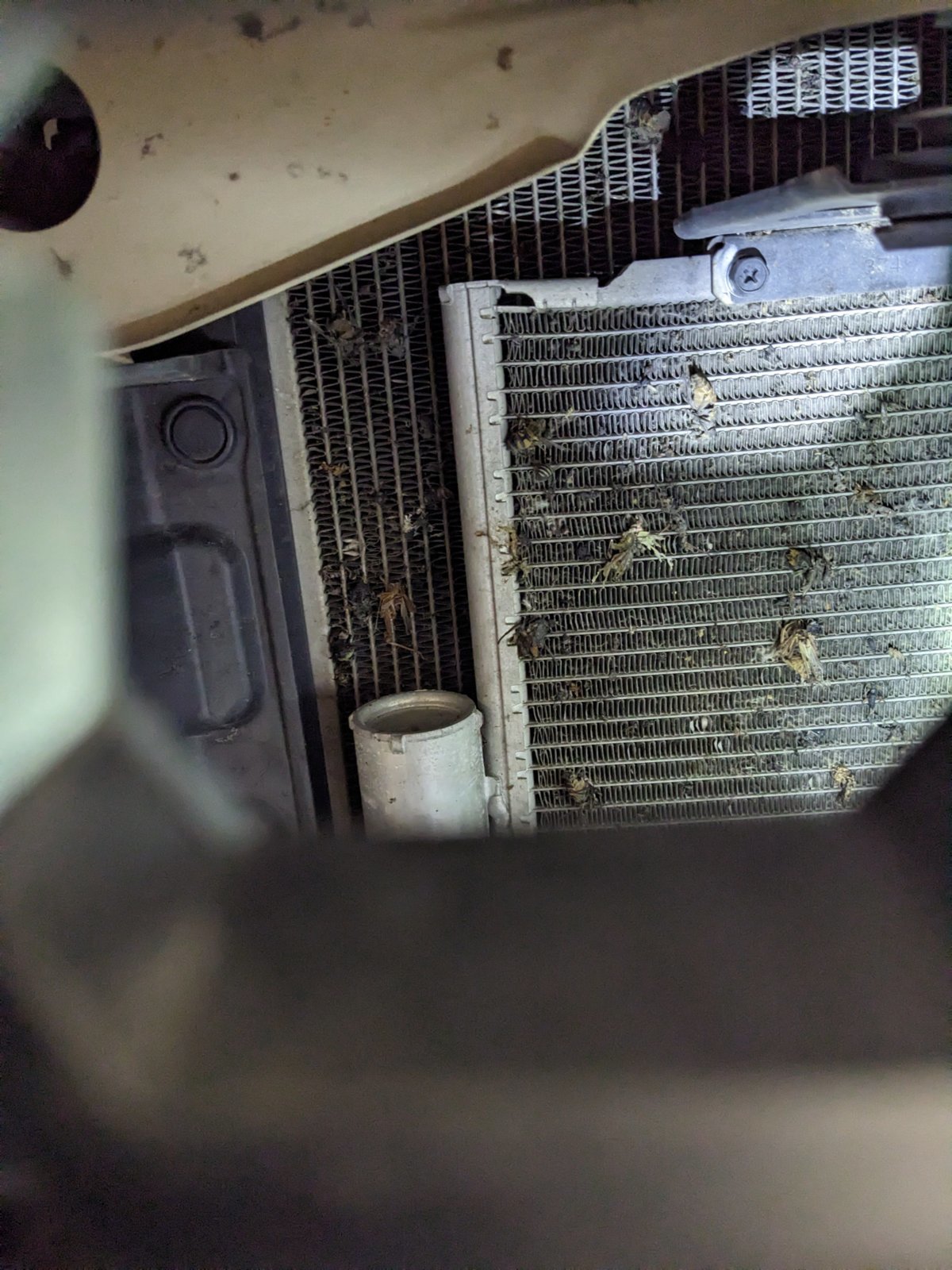

    Texas2Alaska
    Texas2Alaska New Member
    Nov 14, 2023
    #106946
    24
    2020 Tundra SR5
    Thank you Joe333x. I was hoping the smaller silver radiator in front of the larger black radiator in this picture was the transmission cooler. Looks like the dealership and Toyota hoodwinked me. At least I made it, but probably should have gone with the Super Duty for this towing job. Let's see if I have any transmission problems.

    vtl
    vtl New Member
    Mar 23, 2020
    #44238
    2,944
    Boston 'burbs
    2019 Red SR5 DC 4x4
    That is your AC condenser, the tube attached to it on the left is its dryer.
    Drain&fill ATF. If it's brownish/dirty, do another d&f in a few hundred miles.

    Joe333x
    Joe333x Member
    Apr 4, 2019
    #28632
    1,915
    Boston
    2019 Tundra CrewMax Platinum
    Don't worry everyone with a 2019+ got hoodwinked. If your atf high temp light came on the fluid should be drain and filled a couple times like stated above. A drain and fill one exchanges about a 3rd of the fluid. Grab a cooler from @Genuine Cooling Systems and you shouldn't see that light again.
