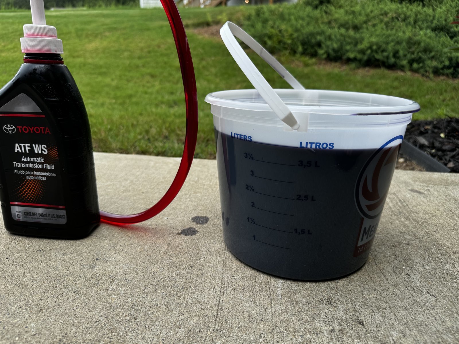

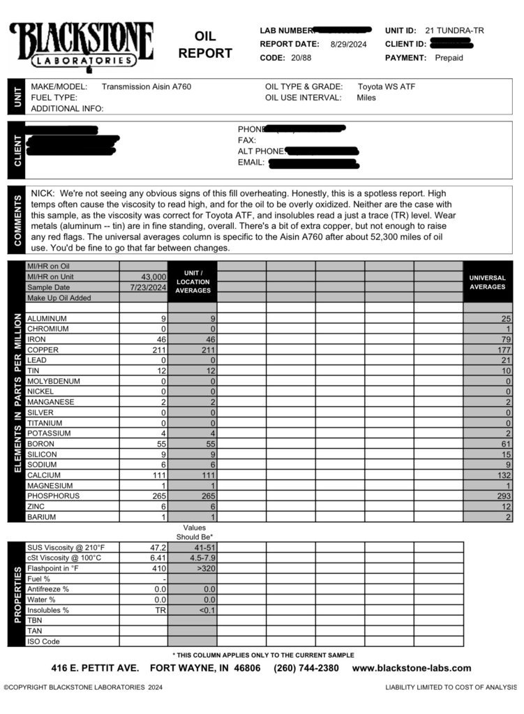

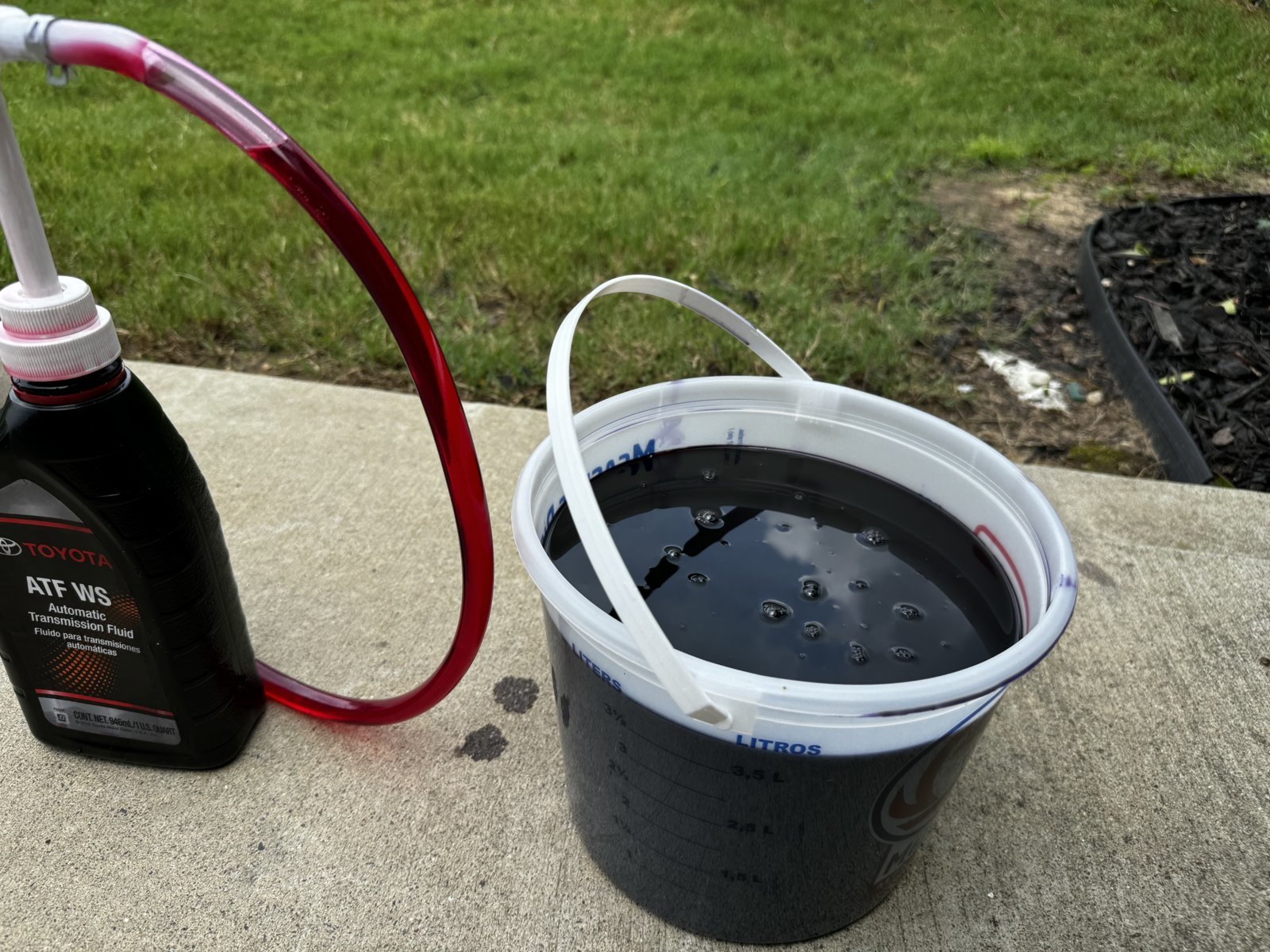

  19. Aug 29, 2024 at 4:22 PM
    #919
    bucketlintels02
    bucketlintels02 Newish Member
    Apr 30, 2024
    #116160
    120
    NW Georgia
    2021 Tundra TRD-Pro Crew
    RAS Road-Active Suspension System HD. 2" (estimated) Spacer and Block Lift . S&B CAI - closed VLED Footwell lighting MESO Customs Interior Lighting 285/65/18 KO2 Gator Hard Cover Tri-Fold AJT Designs interior trim CSU 9 - year ceramic coating Rigid Amber Fog Covers Full Tint (70% Windshield) 20% all others.
    blackstone report back today. I guess looks aren’t everything…
    Terndrerrr, mverkaik, _none_ and 3 others like this.

    Good for you and your transmission, very nice. Cracks me up how they try to make the response seem so natural.
    I am putting on a cooler soon.
    Wondering if I should drain and fill first? I heard Toyota factory oil is crazy expensive...what is your experience with that?
    I kinda want to see what is on the drain plug because I was in a rear ending that totaled my tundra and I bought it back. Just did rear diff and got a single small shaving from a gear. Curious as to what is on the Trans Plug or in the oil that will come out. I only have 22K on her('21).
  21. Aug 29, 2024 at 4:52 PM
    #921
    bucketlintels02
    Apr 30, 2024
    #116160
    120
    NW Georgia
    The Toyota ATF WS fluid was about $15 a quart. Not too bad. I installed the cooler as a precaution since we tow a good bit.
    Pig Rig and ATV25 like this.
  22. Aug 29, 2024 at 6:04 PM
    #922
    _none_
    _none_ Poser
    Mar 23, 2023
    #94306
    482
    2020 DC SR5 4x4
    Good report! Thanks. Have you checked your thermal degradation number yet?
    I'm curious if it is only thermally related or has other factors (such as time). My '20 was at 60k miles and just had the cooler installed when i checked it. It was at 3699 at that time. I'm 7k miles later now, pan temp has not been over 200F again, i need to check the number again to see if its changed.
