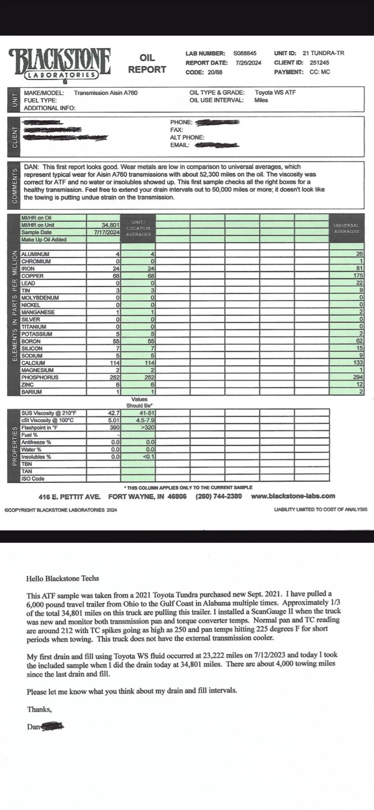

    I just got my transmission fluid test results back from Blackstone. I'll try to post tomorrow after I blot out certain information to protect the guilty.
    I will say that my transmission isn't being hurt by the amount of towing I'm doing and can extend my drain and fills out to 50,000 miles. I'll still do it every other year if I continue to tow 2k a year.

    Here's the report and my letter to them. Don't know why my letter got scanned and saved twice.
    So it look like the transmission doesn't mind a little work now and again. I normally make one trip down and back each year but had to drag the trailer home in January only to go back in February. So I'll continue to do the D&F every other year if I do the once down and back.

    What fluid are you using
    I can’t get the download on my phone
  7. Jul 27, 2024 at 7:44 AM

    Good old Toyota brand WS.

    See if this helps

    @mverkaik it's good to have you here and speaking for the forum, having you share your knowledge is greatly appreciated.
    What are your thoughts on the aftermarket deep transmission pans that hold an additional ~ 3 qts ATF?
    My sister who also owns a Tundra has a Doctorate in mechanical engineering specializing in heat transfer. Next time we talk I'm going to get her opinion on the benefits of the additional cooling of these pans. I have a feeling I'll get a lot of "It depends on ..." from her.
