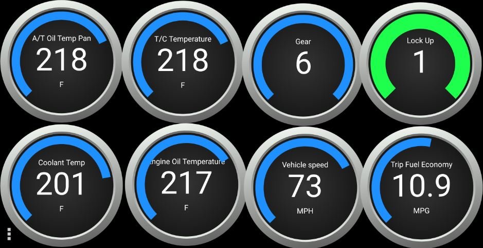

  3. Oct 31, 2020 at 11:06 AM
    #363
    Asimov2025
    Asimov2025 Not Sure
    Feb 19, 2020
    #42850
    977
    Trent Woods, NC
    2019 TRD 4x4 Sport
    Non-stop mods
    Used the app towing my boat this morning in drive. Nothing of concern to me. ATF Pan temps shadowed the engine oil temps...every time.
    Pan temps never got near 250 although TC temps would spike when downshifting out of lock but dropped quickly back to engine oil temps.
    Beginning to think the engine block and transmission case acts as a cooler. :) I await @hagrid guidance on the level of panic I should have.
    Allrsdup, hagrid and Cpl_Punishment like this.
