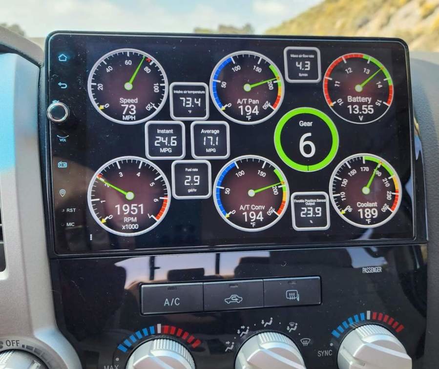

    Sounds like you have everything you need. Like Tsm503 said, you will need to cough up the $15 for the enhanced diagnostics. Then just add away with the different parameters you want to monitor. You can see I have both the pan and converter temps in my setup. This is on my 08 5.7L. There is good information in this thread and where I got the visualization that I am using. https://www.tundras.com/threads/obd-thread-pids-apps-dashboards.60459/page-9

    It is a 10.1" Joying Android head unit Model JY-TQ167N4G-B made specifically for the 2007-2013 Tundra. It plugs right into the factory wiring. https://www.joyingauto.com/joying-2...inch-ips-screen-android-car-audio-system.html I did not need to install Maestro. The head unit supports the factory steering wheel radio controls (I believe you have to use an app on the radio to map the controls) although my truck does not have steering wheel radio controls.

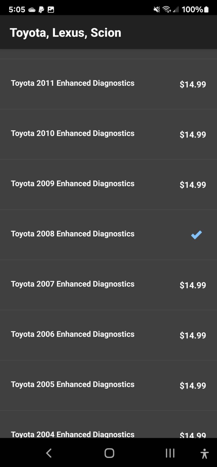

    My 2008 5.7 Tundra shows transmission temperatures using OBDII. When I go to add a gauge in ODB Fusion, I find the transmission options under Toyota,Lexus,Scion, Engine and Electronic Controlled Transmission, A/T Oil Temperature 1 (and 2). A/T is just after the many A/F options.
  13. Mar 2, 2024 at 2:34 PM
    Ricklesgolf
    Ricklesgolf New Member
    Mar 2, 2024
    #112940
    7
    2008 Tundra
    Here are my options at that point in the PID listing under Toyota,Lexus,Scion, Engine and Electronic Controlled Transmission. So frustrating.....

    Same as mine. I even tried two different scanners: Veepeak and Elm327. No tranny temp options anywhere.
    I tried the custom PIDs and tripled checked my programming. SOL.

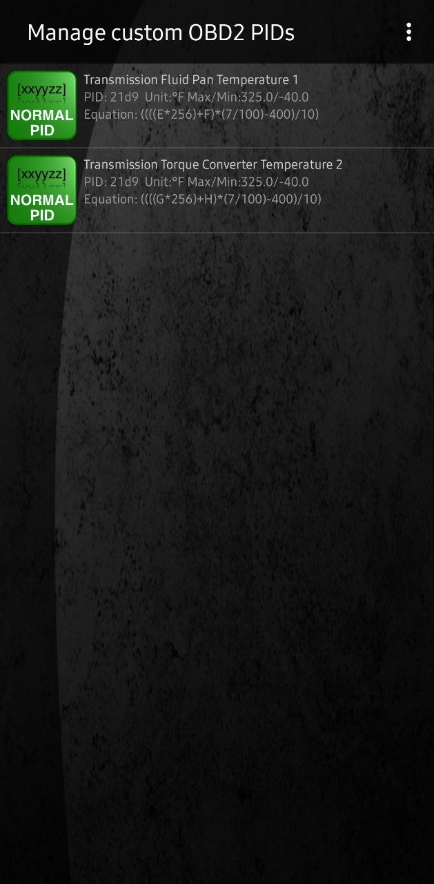

    @mtucker if you have Torque Pro here's the Info to get the Transmission temp Pids to show up.
    This you will get to by going here in Torque Pro (or just download the CSV file attached to this and add it into torque pro app)
    Settings --> Manage Extra PIDs/Sensors --> MENU --> Add custom PID
    For the Toyota 6 speed transmission.
    For sensor 1 (Transmission Pan Temp):
    OBD2 Mode and PID:
    21D9
    Long Name:
    Transmission Pan Fluid Temp
    Short Name:
    TFT 1
    Minimum Value:
    0.0
    Maximum value:
    220.0
    Scale factor:
    x1
    Unit Type:
    °F (there is a degree symbol in Torque)
    Equation:
    ((((E*256)+F) * (7/100) – 400)/10)
    OBD Header to use:
    left blank
    For sensor 2 (Converter outlet temp):
    OBD2 Mode and PID:
    21D9
    Long Name:
    Transmission Torque Converter Temp
    Short Name:
    TFT 2
    Minimum Value:
    0.0
    Maximum value:
    220.0
    Scale factor:
    x1
    Unit Type:
    Equation:
    ((((G*256)+H) * (7/100) – 400)/10)
    OBD Header to use:
    left blank
    With PID # 2182
    Pan temp
    ((((A*256)+B)*(7/100)-400)/10)
    Torque temp
    ((((C*256)+D)*(7/100)-400)/10)

    Downloaded the CSV file and it works with Torque Pro and the VeePeak...thank you so much! Interestingly it does not work with the Elm327 OBDII dongle.
