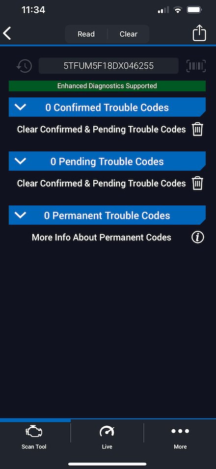

  4. May 5, 2025 at 8:53 AM
    bradleydavidgood
    bradleydavidgood [OP] New Member
    Feb 2, 2025
    #129760
    27
