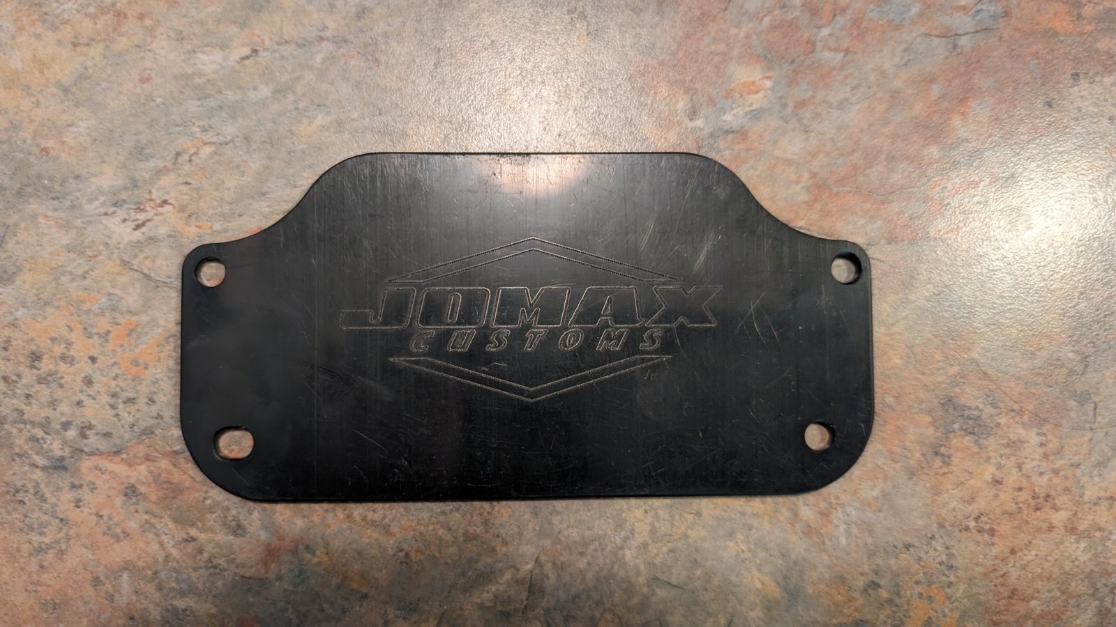

    Yes, Jomax is very hard to find. The only way you will fine one is if you run across another member who is selling one. The company will not provide any info what-so-ever on it. It was a big issue as to why production was stopped on them a few years back. I have pictures that I can send to both of you. The biggest issue that you will run into is the cover itself. It was a special material that worked with the sensor. I'm not positive but i think it was a type of Macralon or something to that effect. There are a couple of members that have extra covers for theirs but you would have to post a "WTB" to see if you get any hits.

    I have an extra Jomax cover I'm willing to part with.

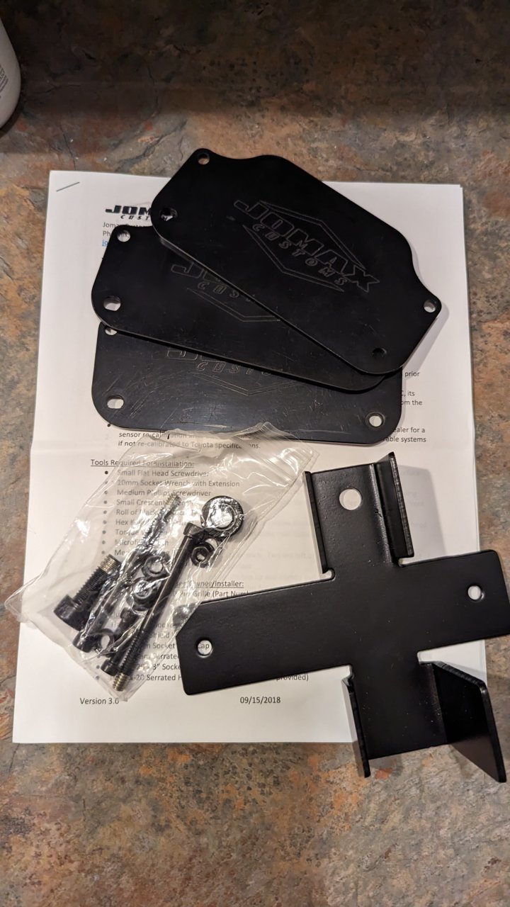

    I bought the bracket and 3 covers because I wanted back up just in case.

    No clue. This is what I bought from Jomax years ago. Brand new, never installed. Not willing to sell the bracket at this point.
