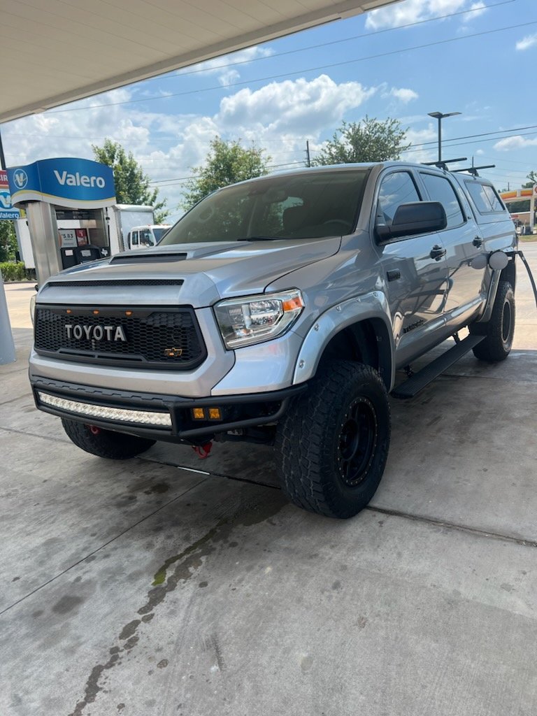

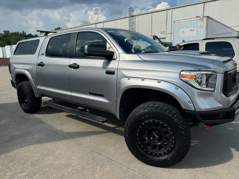

    Hello Yota fans
    Im located in TX, Houston area and I just bought a 21 tundra with lots of mods. My brother has a 1st gen tundra also with lots of mods and he's a member here so I wanted to join since he says it's a great community for information and help with our trucks.
    I wanted to see if anyone recognized my Tundra. Just wanted to see if previous owner was here. It has some little issues that I'm hoping I can fix easily or just have to bite the bullet and go to the stealership.

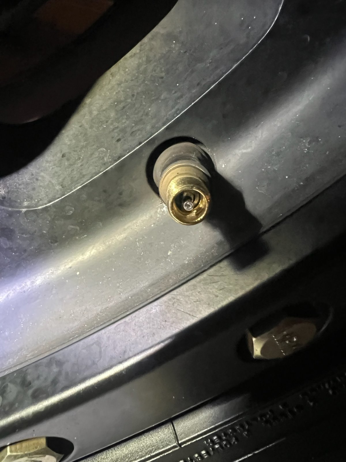

    Post a pic of one of the valve stems. If the sensor was unplugged you would have multiple errors and lights. Follow the connector from the top of the grille area and see where it is mounted to start with.

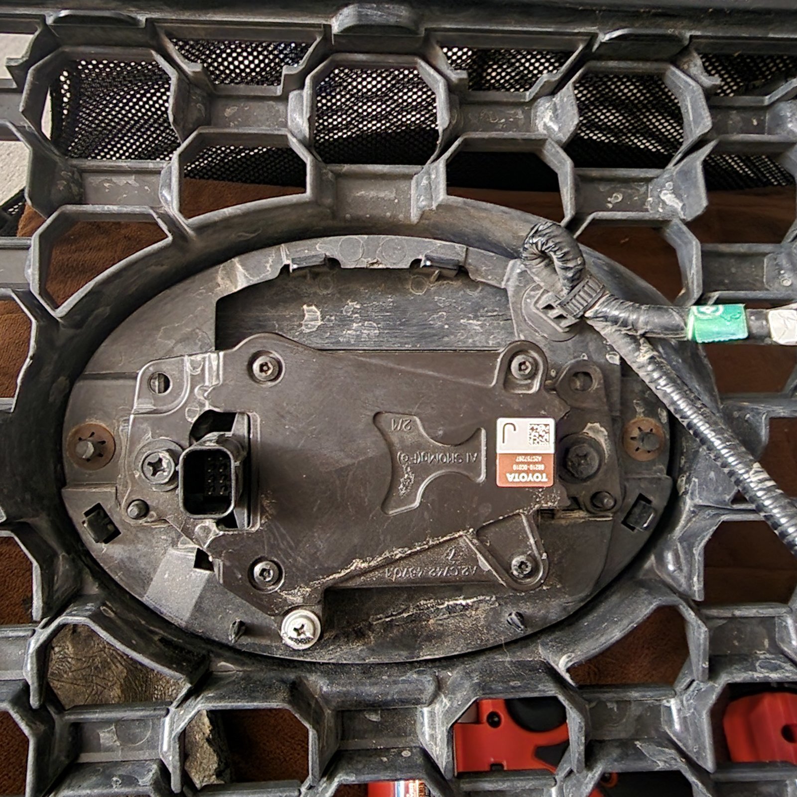

    The TSS sensor is definitely part of the original Toyota emblem so either previous owner removed it completely or check behind the lower part of the grille to see if they epoxied it to that. You should see the plug under the small panel on the top part of the grill.
    Avoid the dealership at all costs!
    Edit: here's what the sensor looks like mounted to the Toyota emblem.

  9. Jun 10, 2024 at 8:19 PM
    ScenicRoute
    ScenicRoute New Member
    Jan 22, 2021
    #57970
    795
    2021 Tundra CM Nightshade
    Eibach stage 2 (JUNK), SmartCap, Airbags, CoachBuilder Stuff, Bora spacers, 35” falken AT3W tires.
    99.9% sure that’s a regular valve stem.

    Figured that, also I was reading that 20/21 are very picky with TPMS. Some say only OEM works and there are different sensor for steel and aluminum wheels.

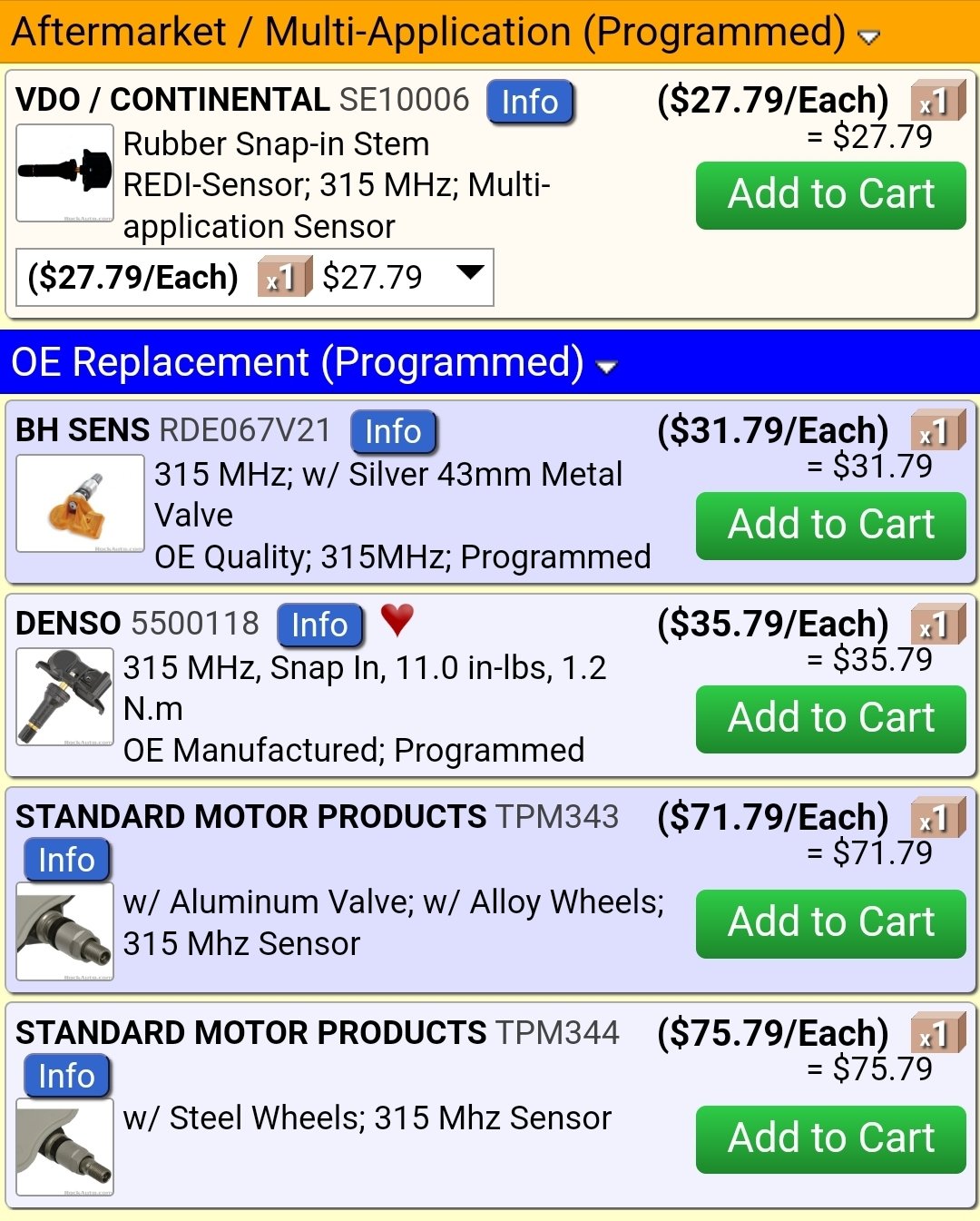

    Thanks for the clarification, I have to get new rubber so I'll order new TPMS to give to tire shop. I see rock auto has some deom $27- $75 all are 315MHz. I looked up oem and I believe I saw them around $85. I'm assuming that's the best bet.

    I had the older versions so I can't help with that part. I know several members here have swapped wheels and TPMS sensors to have the info.

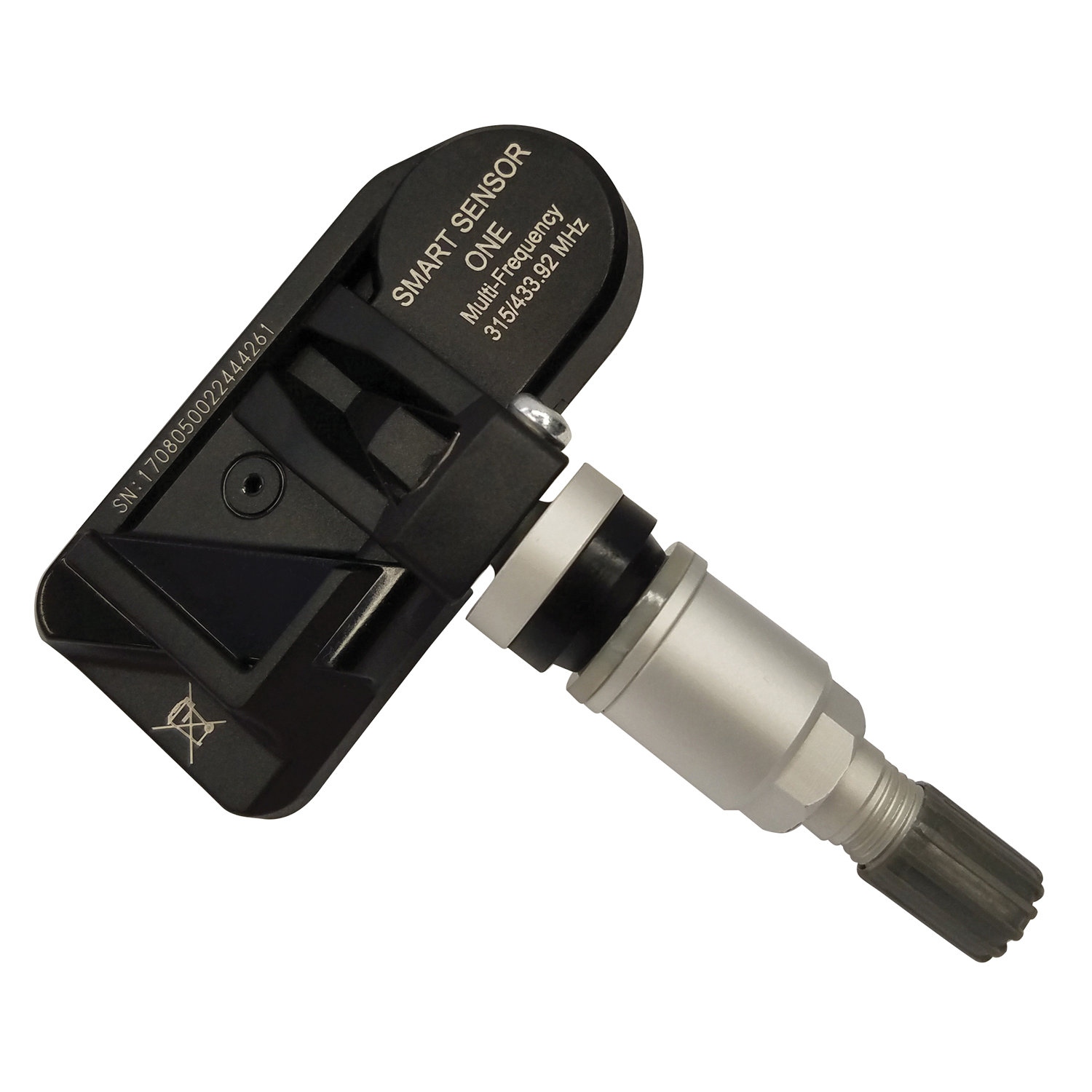

    Correct ....that is a regular valve stem. TPMS sensors will have a mounting sleeve

    I also thought that but I also saw some on Rock auto without metal sleeves.

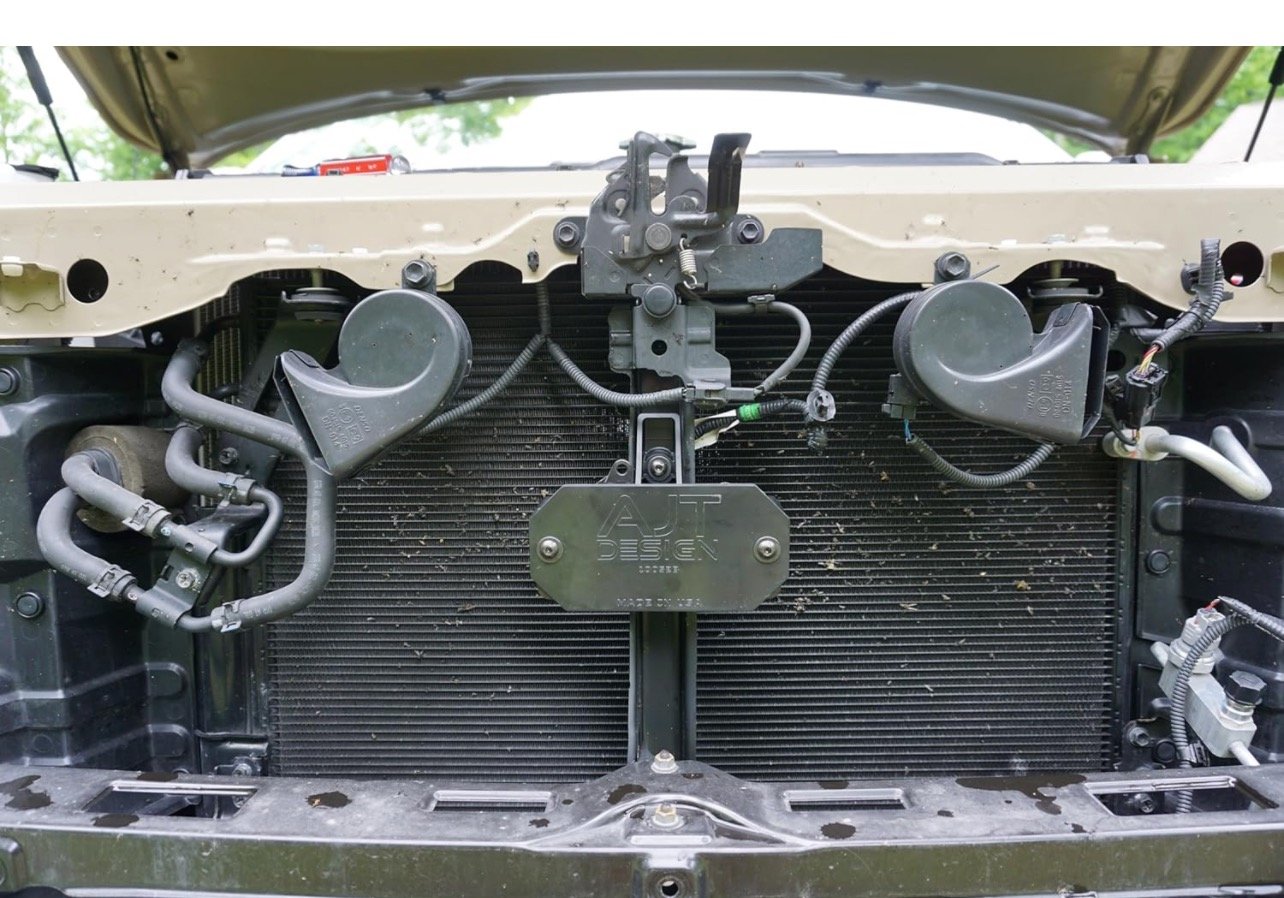

    Also I was digging around and trying to find the collision sensor and found the previous owner used a AJT relocation bracket. So my question is maybe the sensor is dirty if so how do I can it?

    The AJT relocation brackets are hit or miss. My bet is that it has nothing to do with dirt. It COULD be that the letters on the grill are blocking the sensor and you may have to move it down a tad. Some have never had an issue following relocation and some have gotten consistent errors. I tried the AJT and it was always throwing errors so I switched to the Jomax and have never had an issue. Sadly, they don't make them anymore. Many people have tried to figure out the issue but have been largely unsuccessful, going so far as shaving the top plate down, etc. You might want to try to fabricate something but may need to get recalibrated.

    Since you have the orange light it's a very good chance that those are the regular valve stems. Swing by a tire store and they can scan one to see if it picks up a sensor. On another note, the 2020 and newer are very sensitive to what sensors work. Most aftermarket will not so OEM is the best way to go.

    As mentioned, the AJT kit is the culprit. Moth of them do not work. It has a very thick cover plate but even a thinner cover usually doesn't work. You can try moving the kit down a little but it's a hit and miss. Jomax is the holy grail and are very rare to find. I got lucky finding one myself.

    No need to disconnect the battery. Those errors clear when the cause clears. The grille is not affecting the sensor. Its that AJT kit.
