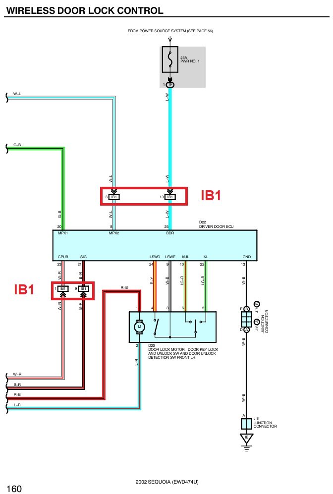

    Ok I've got a 2002 Toyota Sequoia and need to find the door unlock and lock trigger wires for a keyless entry system that trying to install.
    Any help would be greatly appreciated

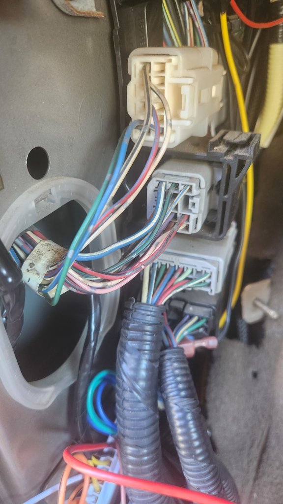

    I've traced the wires from the driver's door actuator to the gray 13 pin connector.
    Testing with a multi meter I believe pin #2 Red-Black is unlock and pin #10 Blue-Red is lock but no matter what I do I can't seem to manually actuate them.
    As far as I know they are ground operating wich is how I have my keyless entry system set up.
    Any ideas?

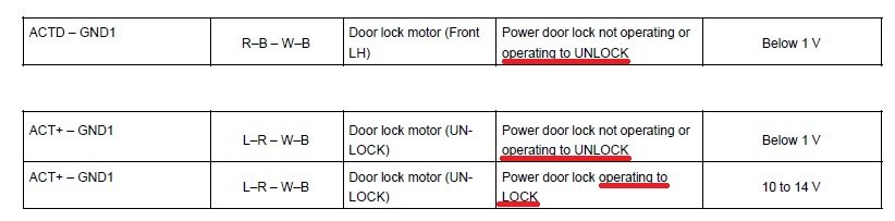

    Driver door is different from the other doors as far as the signals coming from the Body ECU to lock/unlock.
    Whether it's window or door lock motors, Toyota simply reverses polarity.

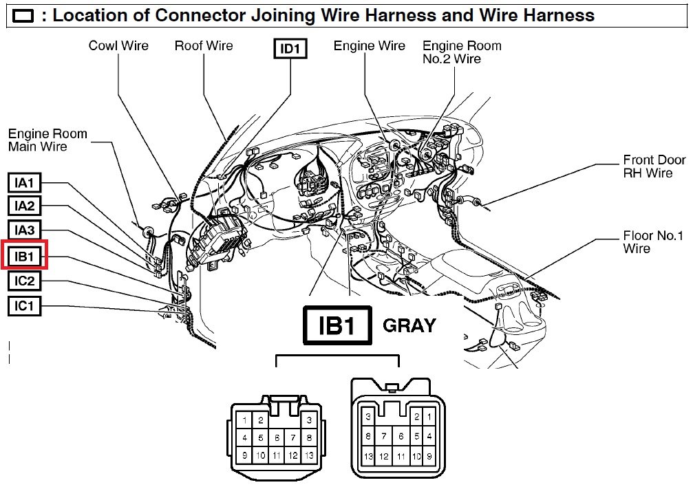

    As for the IB1 gray 13 pin connector, Pin # 2(red black) is the ACTD signal from Body ECU....Pin # 10(blue-red) is the ACT+ signal from Body ECU.
    This should be the voltage check results at IB1 grey connector.....
