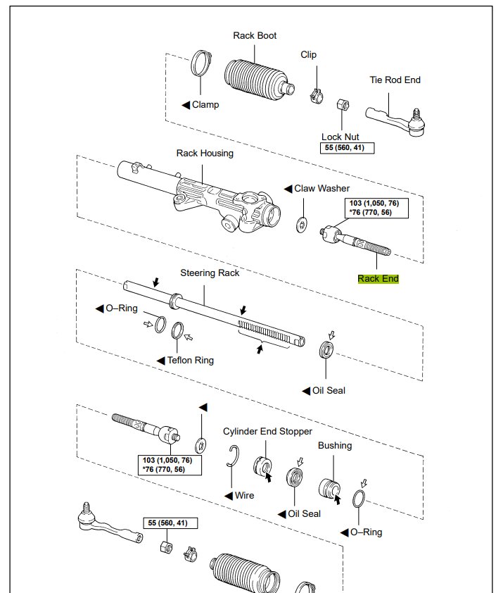

    Anyone know the torque for inner tie rod to the steering gear? Thanks

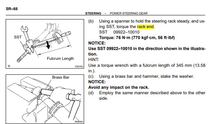

    Thanks for guiding me to the FSM. Page SS-81 has the tie rod locking nut at 55 ft/lbs, but no reference to the inner tie rod end torque. It has all other torques for the outer tie rod end. I’m looking for the inner tie rod torque, and am using the long tie rod tube extension tool for removal and replacement of the inner tie rod end.

    That's because in the FSM it's referend to as "rack end".

    Bingo thanks! The ole rack end. Slippy slappy samsonite….I was sooo close.
