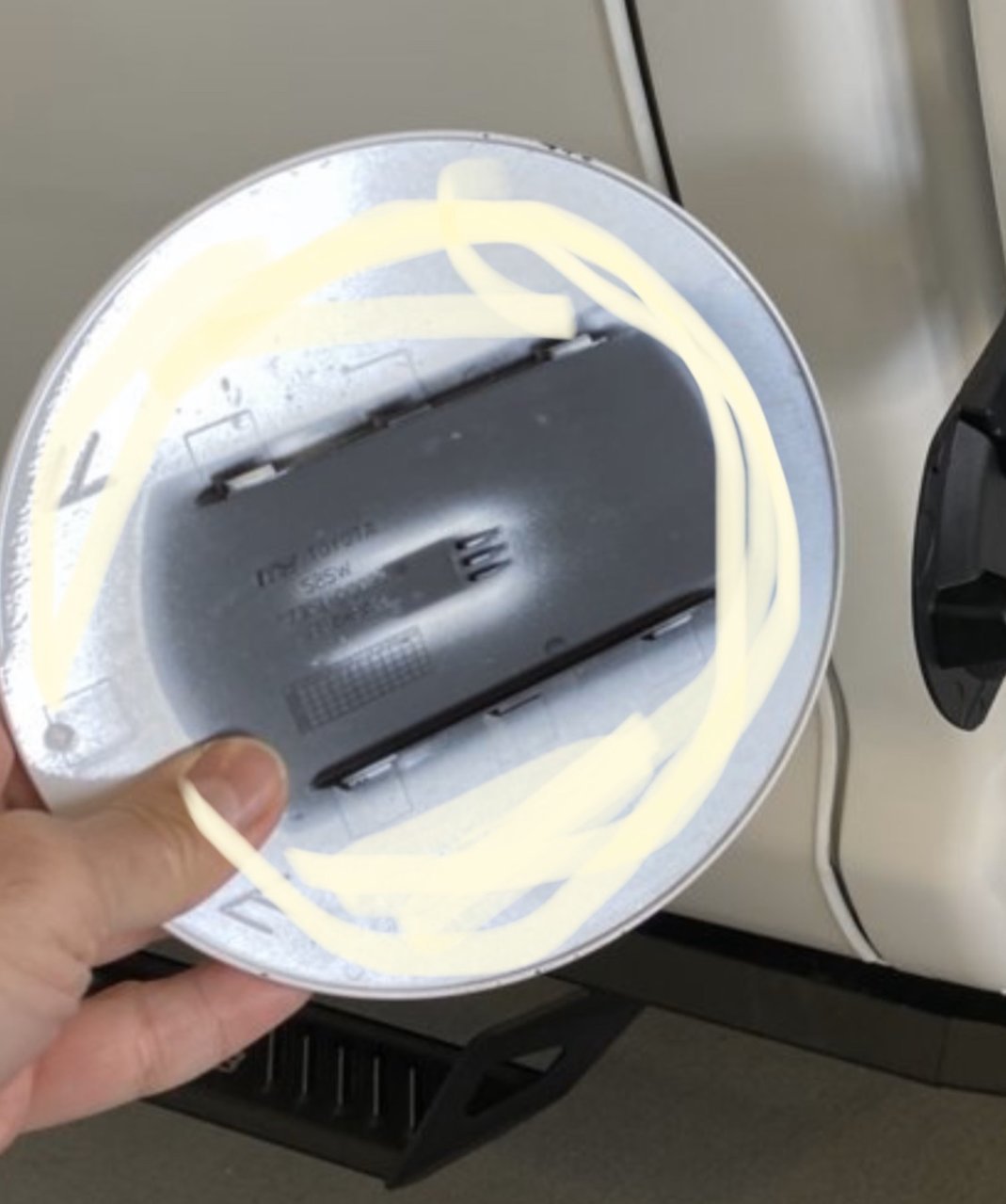

    I think it’s just the way they are made. It’s all plastic, and then the factory just paints it after it’s assembled. Break yours off... I’m sure it’ll look identical.
    And to the individual who thought the truck was in an accident before I bought it, highly doubtful. I saw it roll off the delivery truck into the yard. And they don’t have a body shop in house. But the world is crazy, so who knows... :)

    I think most people are seeing what I’m seeing, which sounds like what we are seeing is incorrect.
    The colored/marked up area doesn’t look like factory gloss paint, but I’m guessing it is? LOL :D
    We understand underneath the broken off part isn’t painted. But everything else should be factory, nice, glossy paint.

    Definitely something wrong here. I just checked my gas door cover and it is finished the same front and back. Yours seems to be unfinished and scratched up. That is not a 1300 mile gas cover.
    More to this story but I don’t really give a hoot. Lol.

    Truck is brand new.
    Had it for less than 2 months.
    It’s an iPhone pic taken indoors at the dealer with interior garage lighting.
    Enough with the conspiracy theories...

    It’s just “that” hard to believe this happened!:p LOL! Which is a good thing. Shitty picture, I get it lol.

    I think we are all seeing the "halo" effect from the lighting. I'm no professional photographer, but I did stay in a Holiday Inn last night.

    The truck is parked inside, the white over spray part near his hand is the reflection of natural light coming in the garage door, the black under spray is the reflection of the black plastic.

    Actually that is not according to Toyota's design. That is a QC screwup...or a very poor on-site repair. The factory fuel door is painted without the hinge assembly, and the painted door is snapped onto the hinge arm on the assembly line, OR, the fuel door assembly is provided to the plant by a supplier already pre-painted. Many manufacturers install color-matched, pre-painted plastic parts from suppliers with incredibly good color matches.
    Not sure why the door didn't stay on the hinge, but it's definitely not properly painted. That should have been flagged, but plants hate stopping assembly lines. Maybe the half-ass assembly indicates the line guy wanted it to fall off. Final inspection should have kept it from ever leaving the plant.
    I have observed Toyota will leave protected areas, like inner fenders in the engine compartment and some door jambs without clear coat. I'm not sure if your white is a single stage product, but the back of my fuel door (MGM) is fully base coated and clear coated. The back of your fuel door appears to have been primered only. The color of any protected areas will always be the same base coat (or single stage) paint used on the exterior surfaces, plus it should have full coverage. Yours is primer only, not even close to color match.

    I just went out and examined my fuel door on my 2020 and it 90% painted but at the end of the hinge, it is like op's door. but not nearly as bad.

    OK, on closer exam, I find my fuel door is actually NOT fully clear coated. What I thought I saw as clear is only clear overspray on top and outside edge. The lower half and inside portion is not cleared. I do have full coverage of the MGM matte base coat, like underhood.

    74BAAFCB-6A8A-466A-A4BE-BF34135E9369.jpg So maybe I’ll start a trend. Blacked out fuel door to match black out badges. LOL.

    The dealer is planning to leave it like that? :eek:
