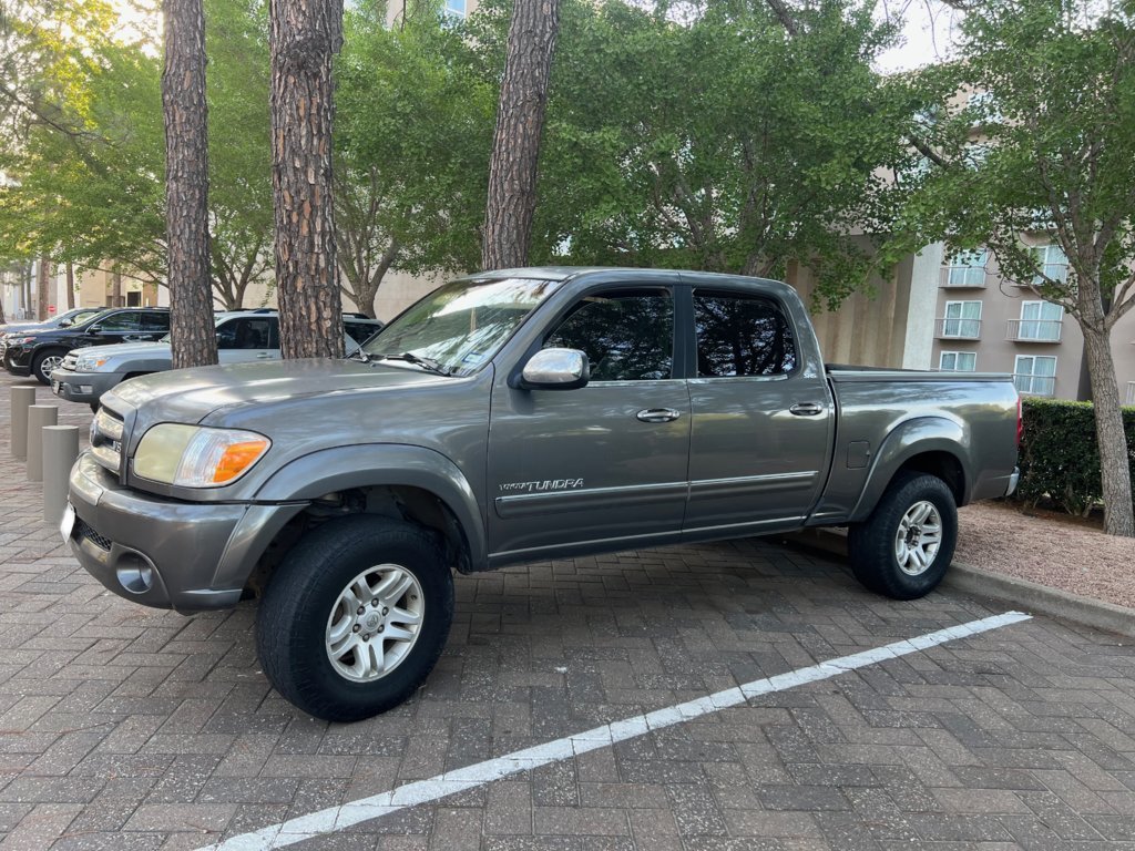

    I have a 2005 Tundra 4x4 with 405k miles. It's my daily driver, me/dad are the original owners, it's been my first and only truck for the last 12 years. I really love this truck, I'm sentimental about it and I don't want to lose it. I want to keep driving it for as long as possible, so I am looking for advice on general maintenance, suggested parts to replace and any other tips.
    I have a Haynes repair manual and do the standard maintenance myself, but I feel like I should be doing more to preserve this truck. I'll also list a few known mechanical issues/concerns below that I haven't gotten around to taking care of yet. I'm open to any and all general advice, comments and suggestions! Thanks in advance for your time.

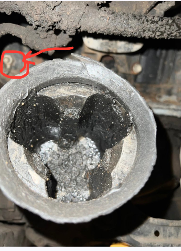

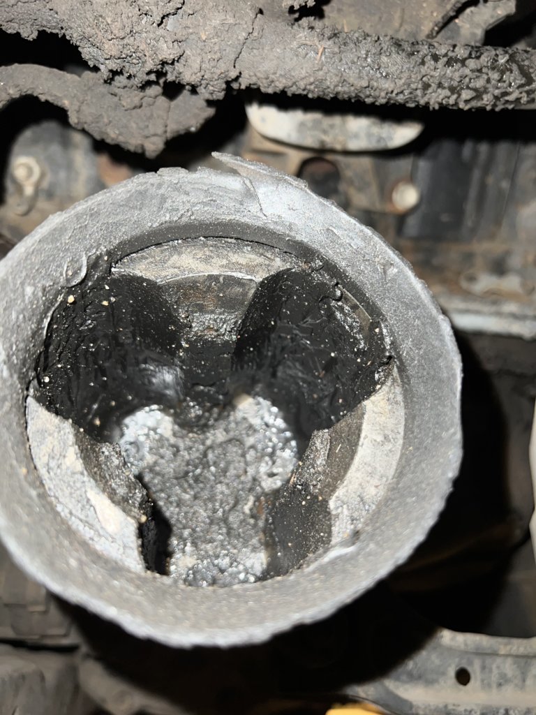

    3. Front passenger side 4x4 axel missing
      • The little axel that connects into the passenger wheel area fell off last year due to the rubber joint cover breaking and allowing dirt inside and literally fell out of place.
      • I still have the axel, I haven't replaced it because it didn't seem to affect the driving, but I'd like to have it fixed because I know I can't use my 4x4 until then. Should I attempt to replace myself? What kind of skill is needed for something like this?

    3: WTF? With no axle what's sealing your front diff? How long has it been like that? Can you get a pic of the diff housing on that side? But yes, that needs to be put back in ASAP.

    #3, the work is not so hard. I'd recommend going with OEM. Part number is 43430-0C010 and I can help you get it locally for cheaper than normal, probably 20-30% less than you'll pay at the dealership parts counter.

    Thanks for the invite, that's pretty cool! I'm in Roanoke, north TX. I'll probably take a stab at trying to replace the axles myself first, I'll see how it goes.
