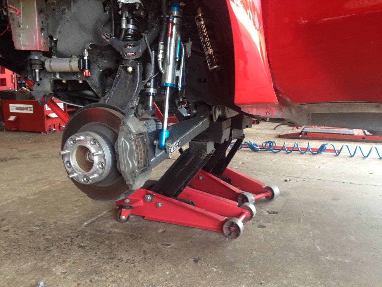

    Got this pic.

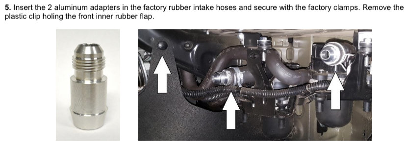

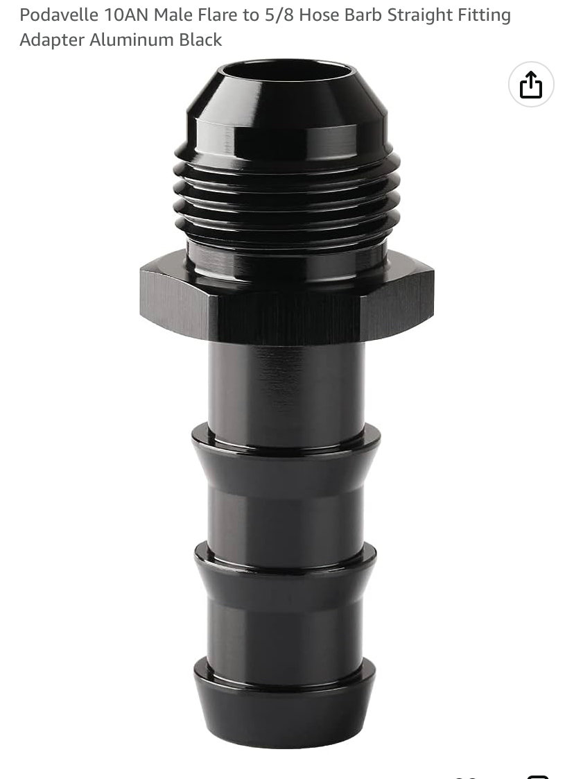

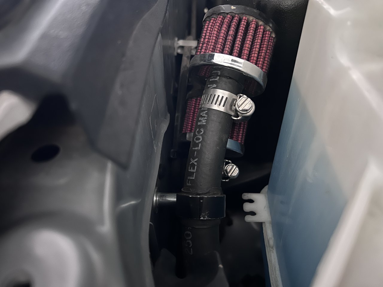

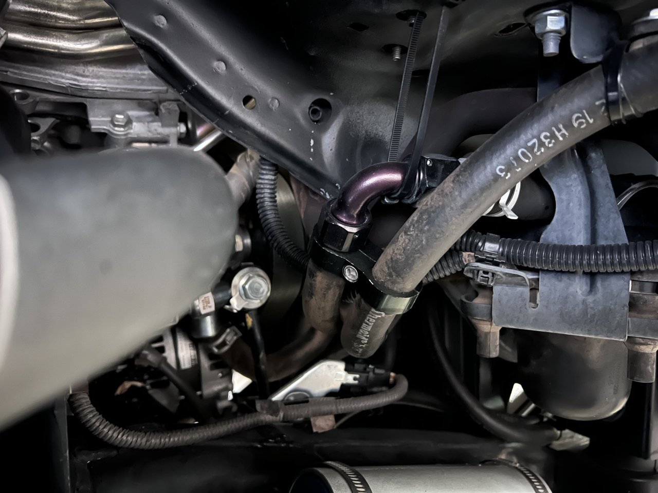

    Has any one ever made your own secondary air pump relocation kit? I don’t feel like spending 400 bucks for a a couple 5/8 hose and some -an fittings.
    I’m having an issue for the adapter from the pump to the hose. I’ll post a picture of a -a fitting I found that is close and the one that is provided by a company that sells the whole kit. Just seeing if the one I found online would work

    This is how I did mine, and what was used.
    *edit* Also used the hose separators linked below to secure/attach the hoses, and zip ties.
    https://www.amazon.com/gp/product/B08DHTK2GQ?ie=UTF8&th=1

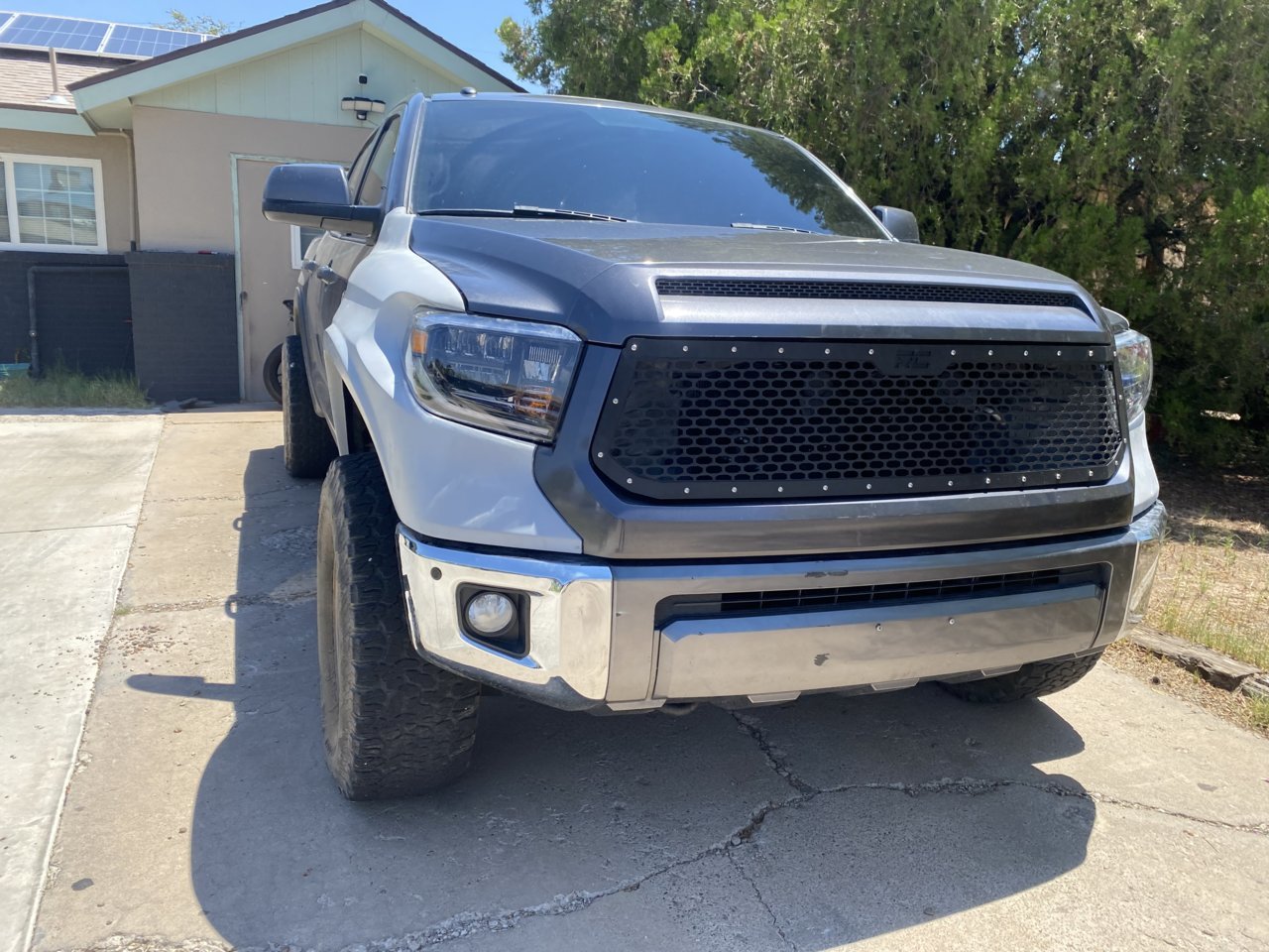

    Got the front fenders on today. I’ll do the rear on my next days off hopefully. Also my new 37s should be in on Thursday!

    front glass looks good. did it fit straight on or did you have to work the fiberglass a bit?

    No it was pretty much straight super minor trimming around the headlights and that was it

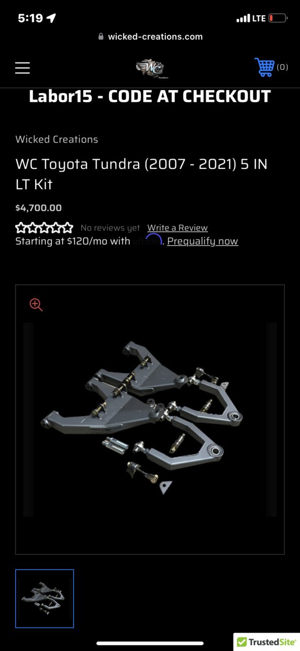

    They are having a 15% sell, with axles and discount code its 3900 dollars pretty good price for a bolt on kit that 5inch extended more comparable to lsk’s bolt on kit

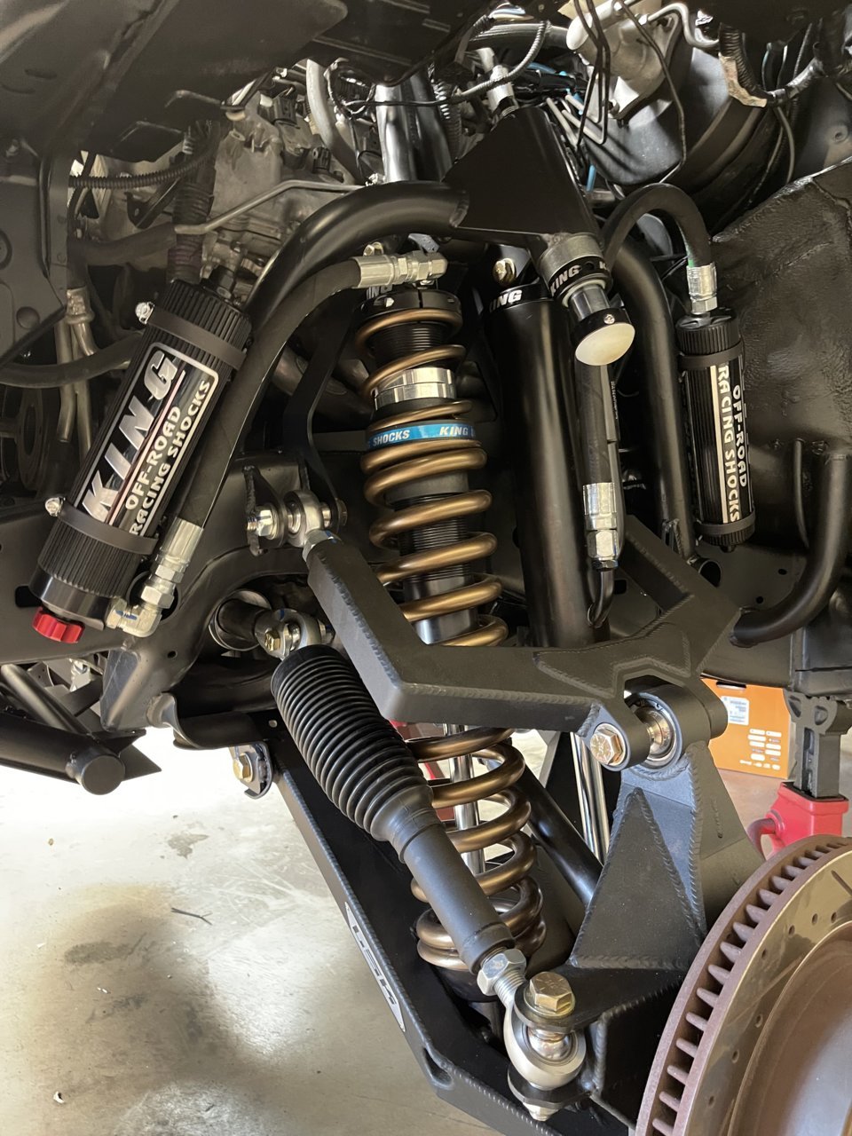

    You’re not gaining anything travel wise. Again the limiting factor here is the length of the shocks and clearance you’ll have the same travel.. to really take advantage of any of these kits you need to cut a ton out of the wheel well like this picture

    The farther you move the wheel out the bigger the lever. Meaning: Huge increase in stress to the shock tower and twisting motion applied to the frame. You HAVE to have a brace from tower to tower over the engine and likely tie the frame together beneath the engine. Fully caged engine bay would be better. But, that's just my thoughts, I'm certainly no expert. I have had to have my shock towers pulled back into place though and I'm only +2.5"
