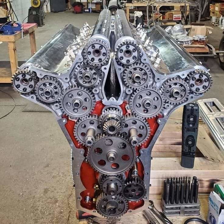

    My 2mm wrench brain just became a 0mm. Truly I know nothing and respect that knowledge even more now.
