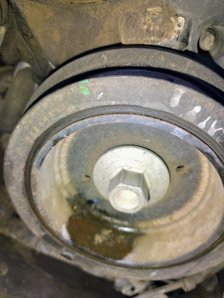

    Well I got stuck on a compressor bolt I'm gonna round off with out some more stuff. I was just gonna throw the parts on and see what happens.Tbh I don't think it's the job for me, I need something now cause work is out of town a bit and I can't wait. I'm thinking I'll try to sell it and see if anyone bites maybe someone else can fix it. Sad day

    Bummer, maybe a motorcycle for backup transportation, depending on your particular situation. I've always had a MC I could commute or get to the store on, just in case.

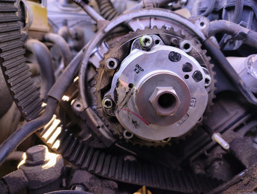

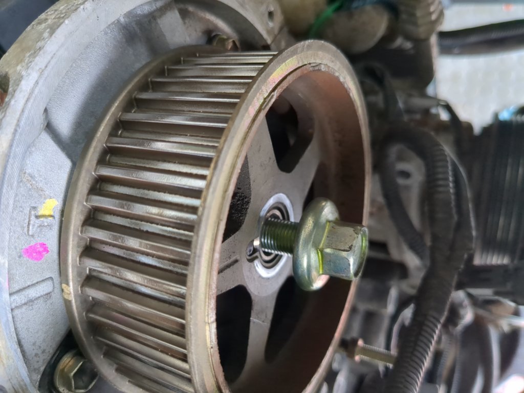

    Well a friend at work who's a diesel mechanic on the side thinks we should be all good to get it back up so I'm gonna go ahead with it this weekend. Here are some pics for the crank and cam positions. The cam on the right side if looking at the engine has a small divit you can barely see on the image. It's at the bottom of the flange part of the cam. I think those are the indicators for position. IMG_20250609_172624838_AE.jpg IMG_20250609_172707599_AE.jpg IMG_20250609_172652708_AE.jpg

    Maybe someone with a vvti truck can comment, but this is what the non vvti cam mark looks like

    Well that made me think and I saw a pic somewhere on here, mine is a vvti.

    Hmmmmm, it may not be that far out of time if I am reading the video right. But I am definitely no mechanic so....

    Yeah, and VVTi has had more cases of engine magically turning into a boat anchor after TB snapping than the non-VVTi. The non-VVTi are far less convoluted.

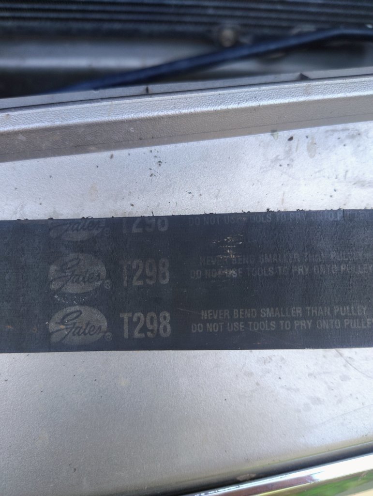

    Montana
    2002 AC 4wd V8 Limited

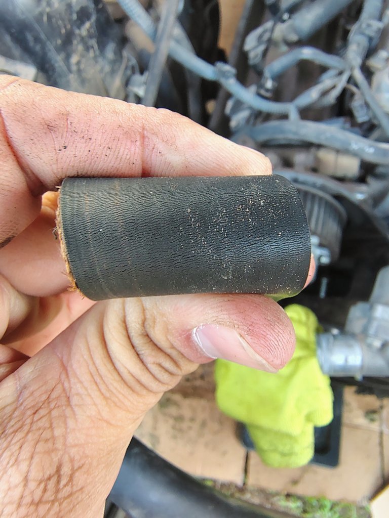

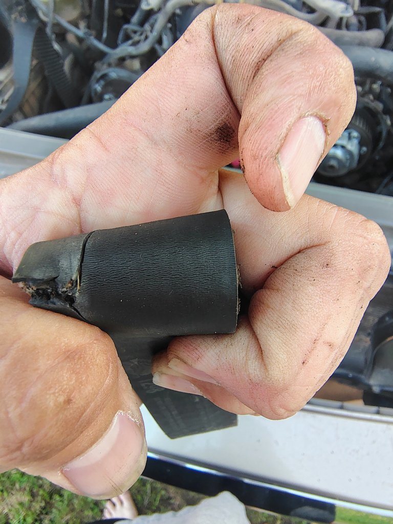

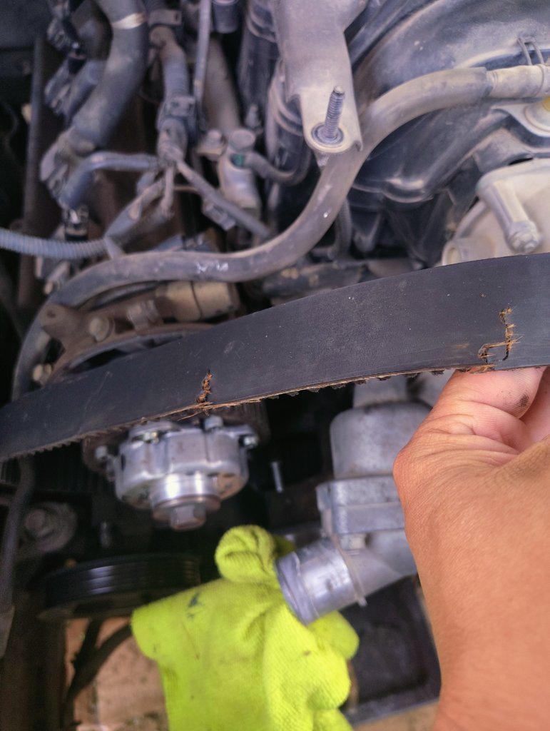

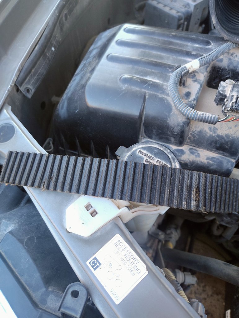

    This kinda goes to show that you can't trust a visual inspection of the timing belt to determine if it needs replacement. I've seen photos/videos from people who cracked open the timing cover, and the belt is absolutely riddled with visible cracks. And they were still driving the truck. "Yeah, looks like I ought to start planning on replacing it..."
    Yours, at least in that photo, looks fine. To me. I mean except for the fact that it's broken...

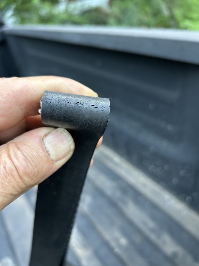

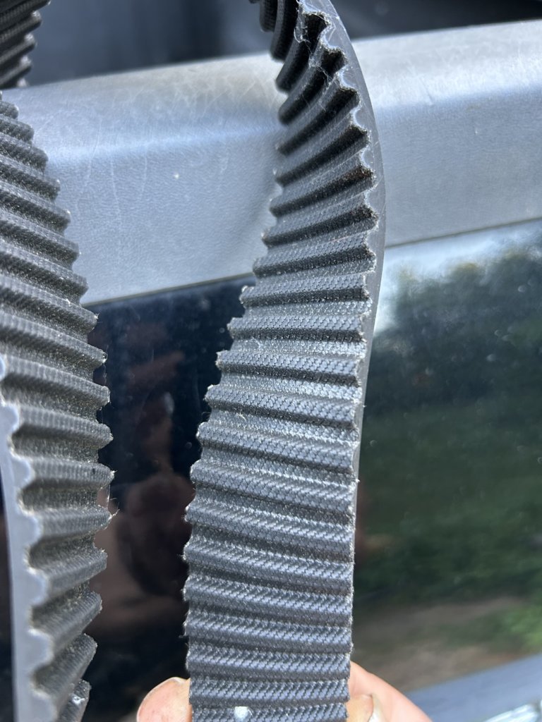

    I’d like to see other side of that belt.
    Wonder if someone put an aftermarket belt on.
    How many miles is on the truck?
    G_unit3000 and pirates712 like this.

    I would be shocked if that's a mitsuboshi or Toyota belt

    That would help explain it. We'd have to see more photos to know if it's full of cracks, but it looks fine in that photo.

    Under side of my old one looks good.
    Far as I can see by records I’ve been able to find its original with 186k miles on it.

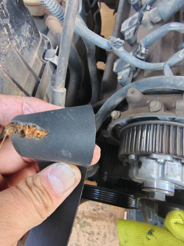

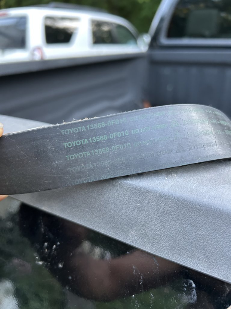

    This is it.

    Wow. I'm no expert, I only know what I've seen here and on youtube. With OEM Toyota belts, they're often full of cracks, and still holding together. With that Gates, there's very little cracking, but a few legit rips. Crazy. +1 for OEM.
