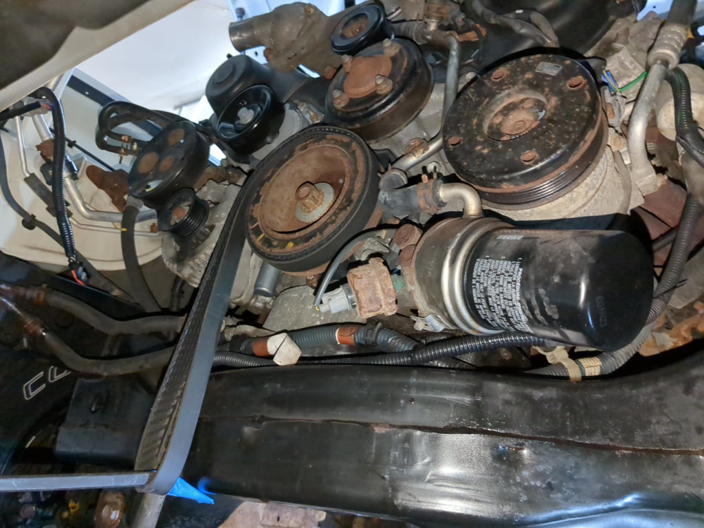

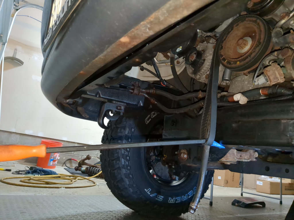

    Putting this here in case anyone else thinks 'I don't need the crank pulley holder tool 'cause I have an impact', and then gets to reinstalling the crank pulley and has second thoughts about snugging it down with an impact rather than torquing to spec.
    I wish I remembered how I did this last time, I don't own the tool (ordered one but it didn't show up in time) and I don't remember renting one...
    Anyway, take an old serpentine belt (must be old, it will be ruined) and wrap it around the crank pulley, then use a large pry bar to hold it against the crossmember.
    I don't think this will work for loosening the bolt, you can really feel the belt stretch and it's a tad sketchy, but it works.

    I used same technique to torque the harmonic balancer on my daughter Escape. Old belt is going in trash anyway.

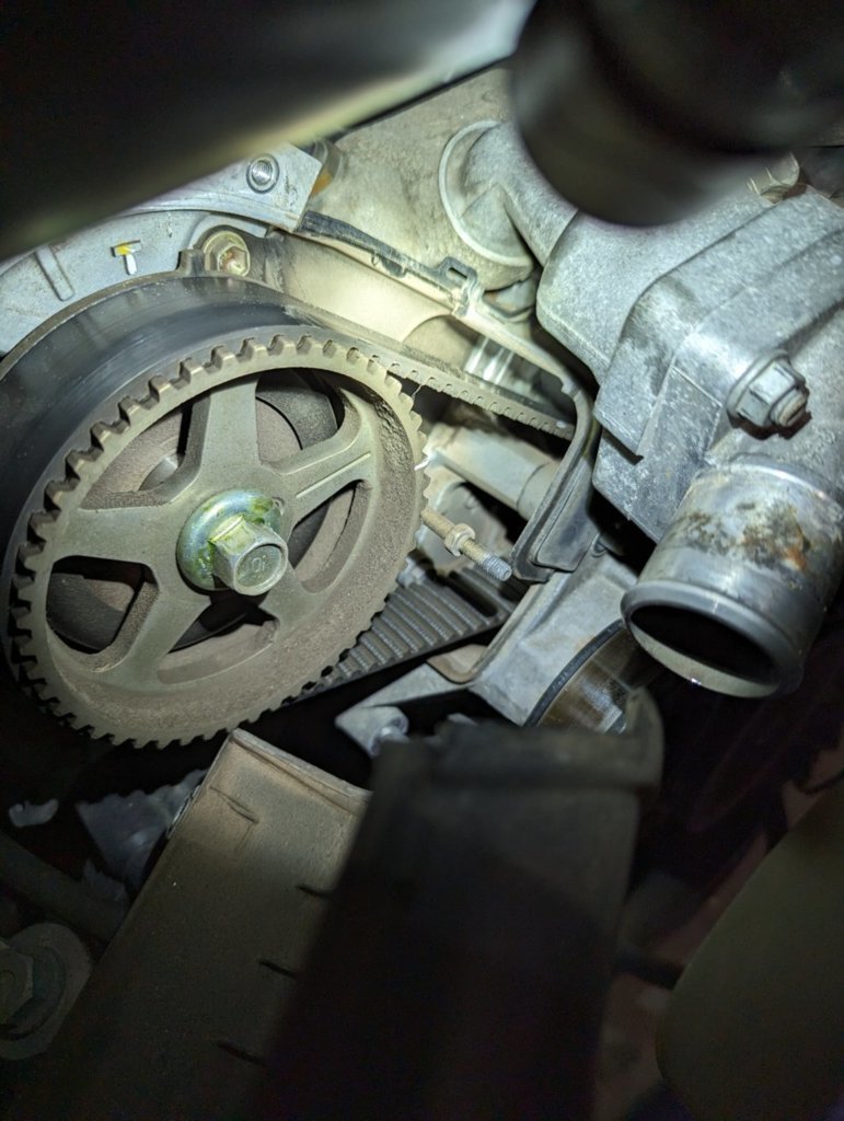

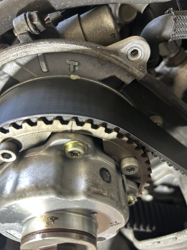

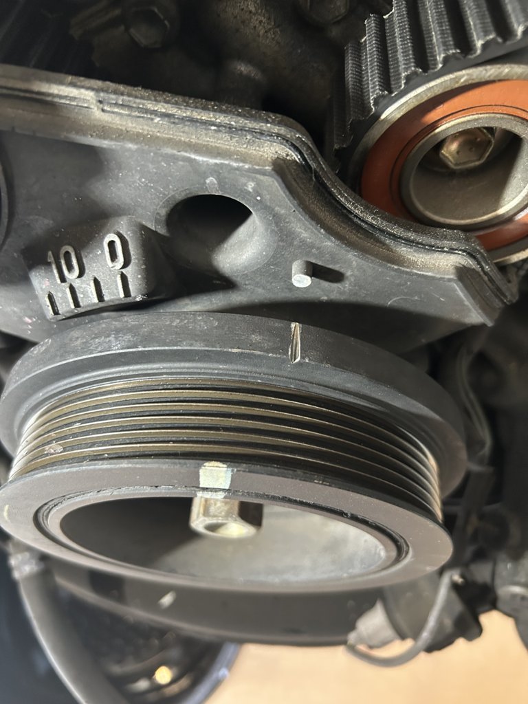

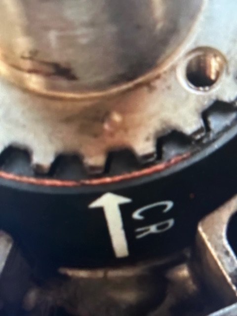

    Hi all - about to dig into replacing timing belt/water pump/radiator this weekend. I've watched and read all I can find but still nervous on the timing belt. On The Car Care Nut's video he shows the arrow on the crank but (call me crazy) that arrow is not lined up with the dot! What happens if the arrow is pointing at the tooth to the right of the dot? Total meltdown?? I need some encouragement!
    ATTACH=full]1124753[/ATTACH]

  10. Jul 10, 2025 at 6:09 PM
    #70
    Redoak
    Redoak New Member
    Nov 28, 2024
    #126549
    261
    Dave
    2006 Toyota Tundra DC, Limited 4x4, with LSD
    none
    Shows the marks pretty well.
    The Aisin kit will have some instructions, just make sure your looking at right one.
    https://youtu.be/Z46cM-Bw1rI?si=kb6MU-VDRah-6pUc
    The Black Mamba likes this.

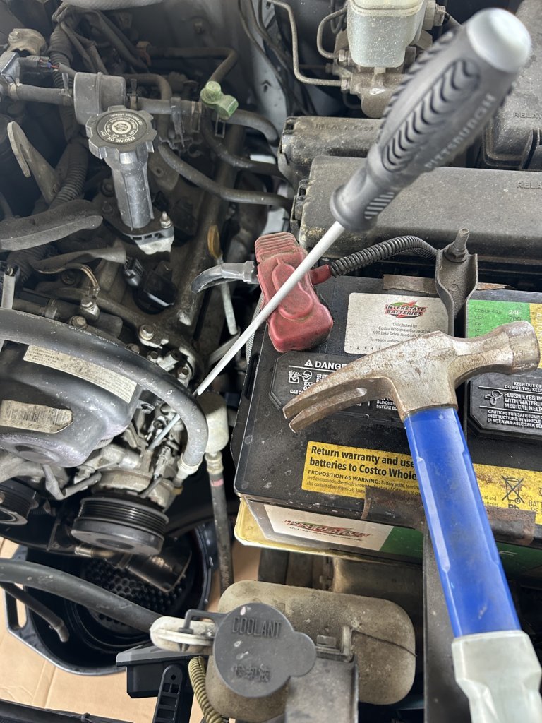

    Also - “pro” tip on the AC compressor screw. I used the 24” HF cheapo screwdriver. Tapped on it with a hammer for a while and the cheap steal on the screwdriver makes it kind of “springy”. Kind of acted like a super slow impact and broke it free.

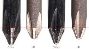

    Yeah, a lot of people get lucky. Definitely don't take a Phillips screwgun to it or you'll have a bad day.

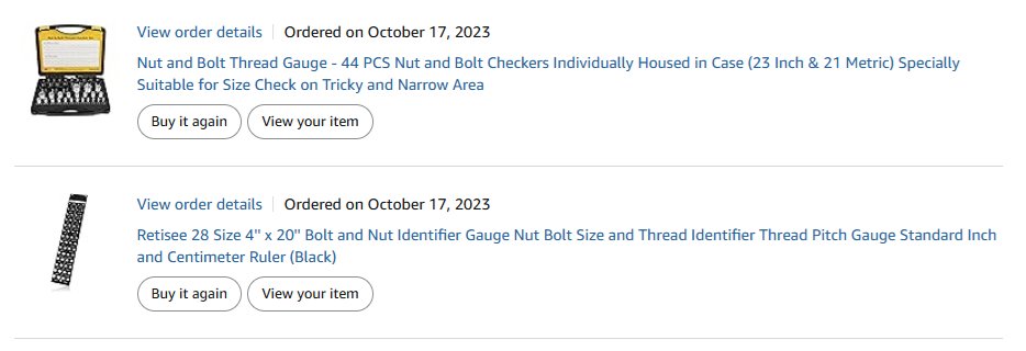

    Regarding the nuts for your fan, they are cheap from the dealer but you can take them to Tractor Supply or a similar hardware store and use their thread checker, then pick out similar nuts. They're probably M6 or M8 in diameter. I believe they are flange nuts with a serrated flange, so you want that exact type of nut to replace them if you aren't going OEM.
    shifty` likes this.

    Ace Hardware has similar nut/bolt checker. Sadly, I have to drive 35 minutes to the nearest TSC store, but I have an Ace minutes away.
    des2mtn[QUOTED] likes this.

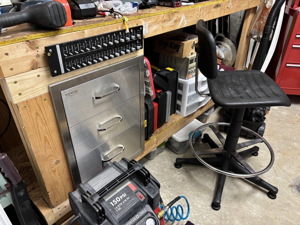

    When I was forced to downsize the shop in 2023, I updated the shop bench I build 20 years ago, and picked up these as bolt supplements. Pic of where I mounted the one similar to the one you bought follows.
    EDIT: I also got one like @des2mtn recommends, I wanted something in a small plastic case that was easily transportable, I have an older one that's on a string like his and it bugs the shit outta me, I feel like I'm dragging around anal beads or something ("painal" beads?). First item here is the kit I got, on the cheap. The VEVOR stainless drawers were retrofitted into my homemade shop table, I needed more integrated storage and got a really great deal on it @scAmazon.
    des2mtn and w666[QUOTED] like this.

    Be careful with that metal hammerhead so close to pos terminal and ground.

    Ha! Yep - I was real careful where I laid the hammer. Negative terminal is disconnected out of the pic.
