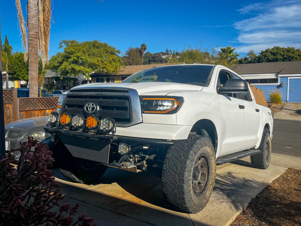

    Thumper_6119
    Thumper_6119 I've seen things you people wouldn't believe.
    Oct 14, 2019
    #37365
    287
    2011 Toyota Tundra SR5 Texas Edition (Crewmax) 4x4
    It is a Top Gun brand grill guard. It was already on the truck when I bought it, and I kind of liked it, so I kept it. It is time to replace it as it is starting to lose the powder coat, and it is starting to rust. A weld on one of the mounts has popped loose too. I tried to contact Top Gun to purchase another one, but it looks like they may be out of business now. I've sent multiple emails and made a few phone calls to the contact info on their website, but no response.
    I am planning on replacing it with this one: https://www.extremeterrain.com/barricade-tundra-hd-grille-guard-black-tu1050.html

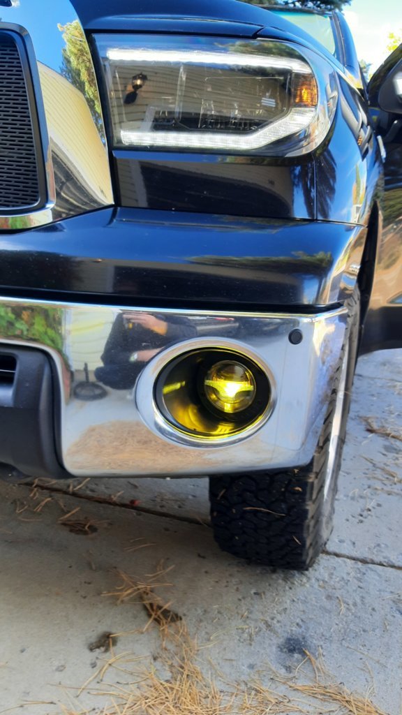

    COTundie
    COTundie Whoa Black Betty
    Jun 15, 2021
    #64339
    1,063

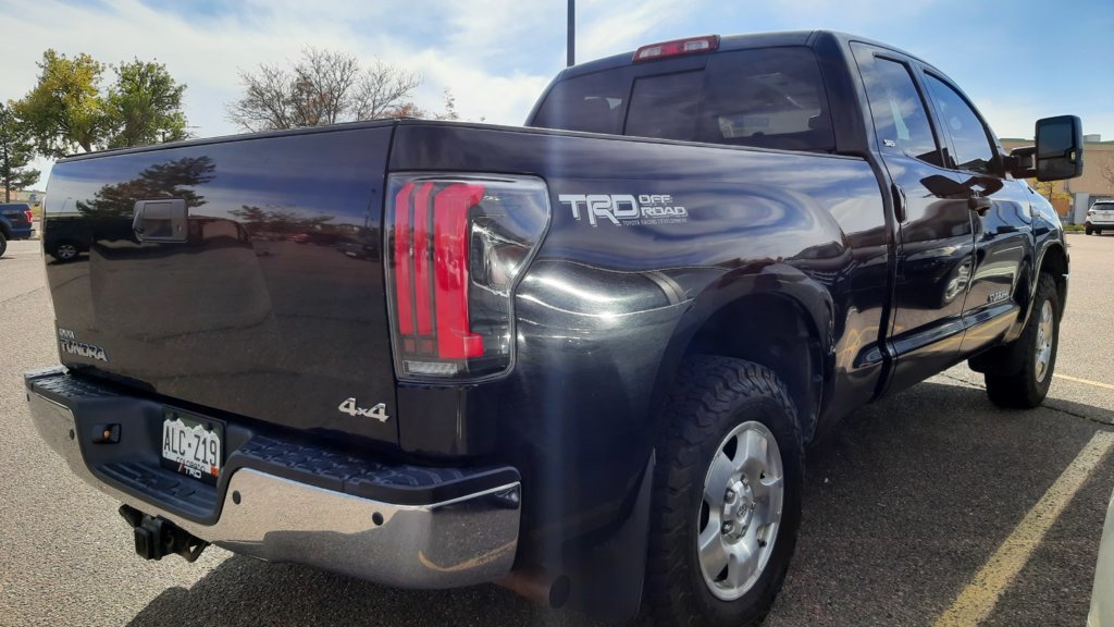

    Trey
    Black 5.7 DC TRD 4x4
    Pretty things
    Morimotos and Spec-D, full LED tails seem to be playing nice together.
    Full sequential on both and working flawlessly with no additional resistors.
    Gitcha some:

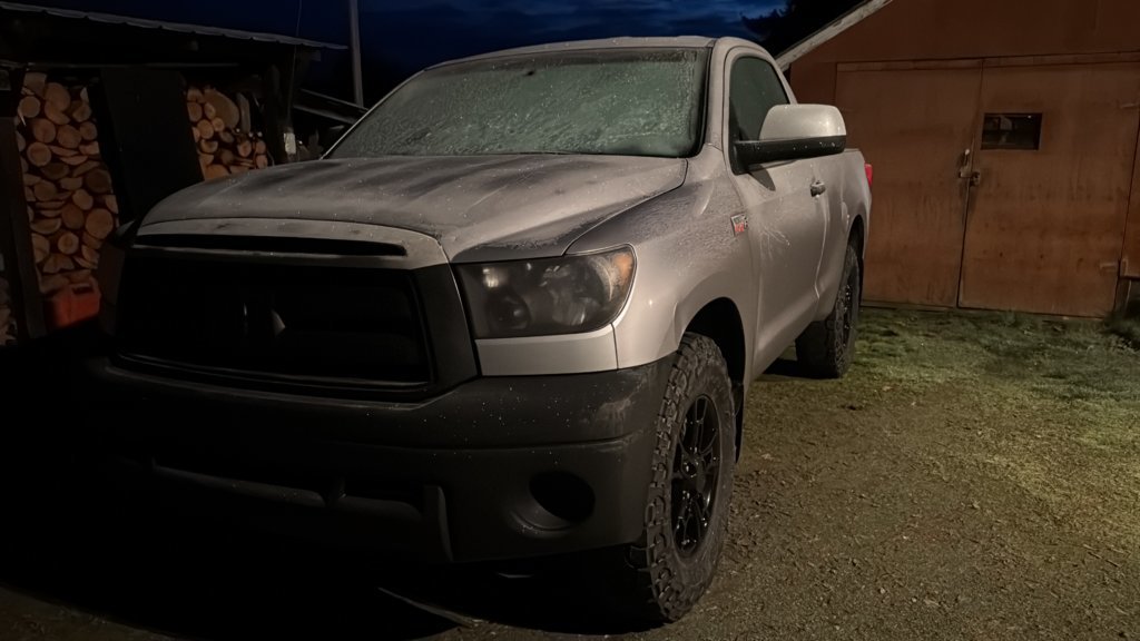

    -3 heavy frost this morning. Just wondering since I have Morimoto’s on their way. Do they create enough heat to melt ice on with high beam? 75B9A14E-A7AD-40EB-9D7D-44FD3215C84C.jpg

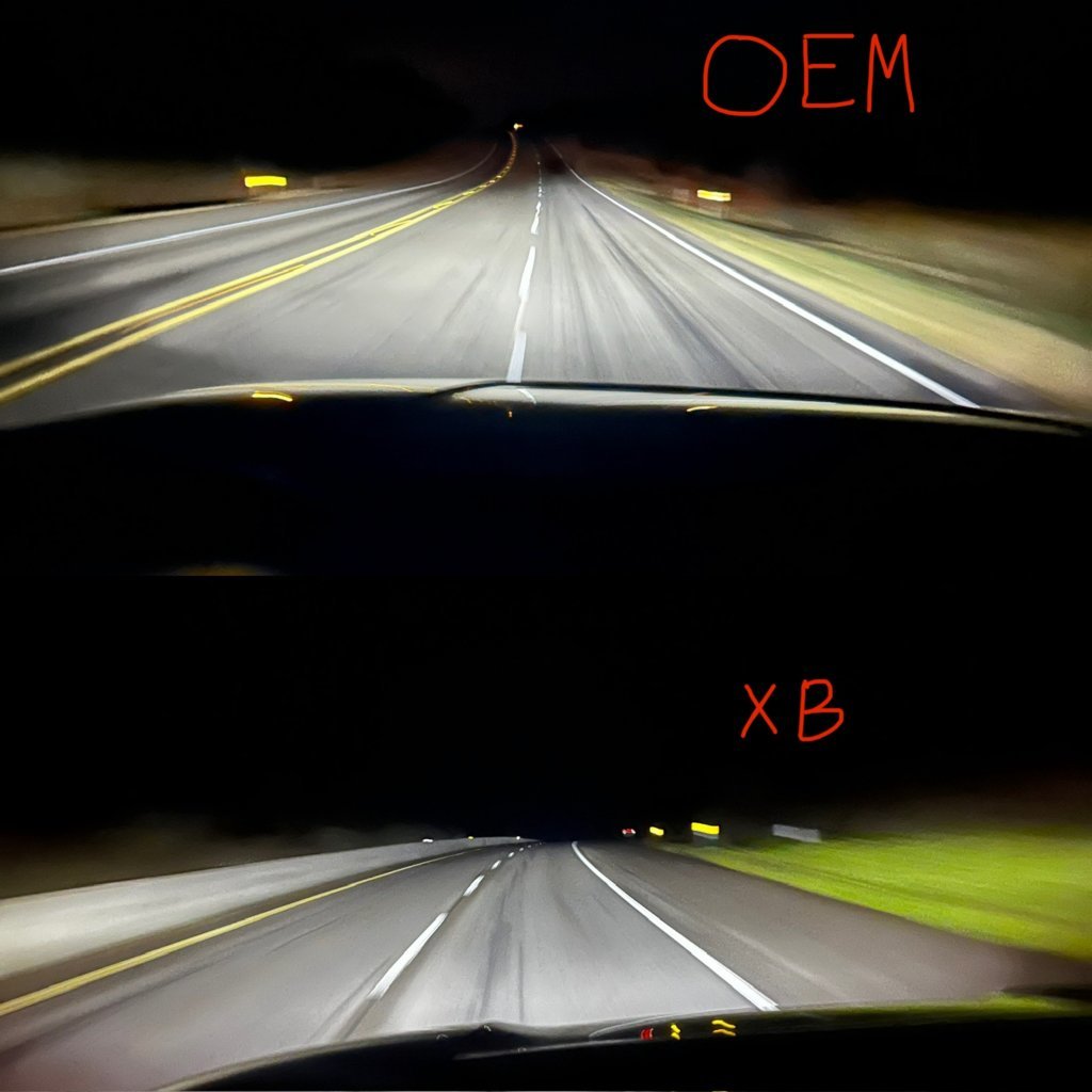

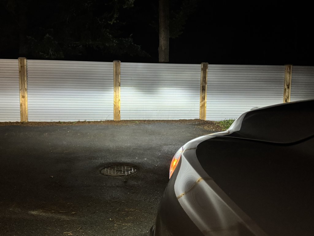

    eccracer104
    eccracer104 Dirty Paws Off-Road
    Dec 18, 2017
    #11593
    3,002
    San Diego, CA
    2011 Tundra 5.7 4x4 CM
    Pretty sure it was the same set I bought. With the holes in the lenses. Haha. Did a write up on my build thread to fix them. Turns out OE style lenses don’t fit the housings. Used a high uv resistant epoxy to fill them and put them back together. Working great now!

    They give off some heat, but not like an incandescent. I would say they are fine for preventing ice buildup, but will not be great for melting much existing ice.
    Ice isn't a HUGE problem in CO, but I've never had to Scrape my headlamps to date.

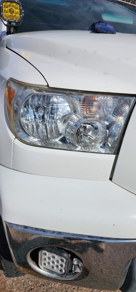

    AstroDude
    AstroDude New Member
    Aug 4, 2019
    #34135
    255
    Eddie
    2011 Toyota Tundra Double Cab 4x4
    Ironman 4x4 3.5" lift Stoptech drill and slotted rotors RRW 0 offset rims BMC 35" K02s TrailToys High Clearance Rear Bumper Steel and Kevlar braded brake lines Front diff drop UpTop Overland Rack RoofNest Falcon XL Roadshower 4L IronMan4x4 Awning IronMan4x4 Privacy Tent Custom built bed molle panel (because they don't make them for crew cabs)
    Well if you don't have the money to buy new headlights just to get them scratched up, go to harbour freight and pick up their headlight renewal kit. I used it on my truck and DAMN they look almost brand new.
    I'll send some before and after pictures.

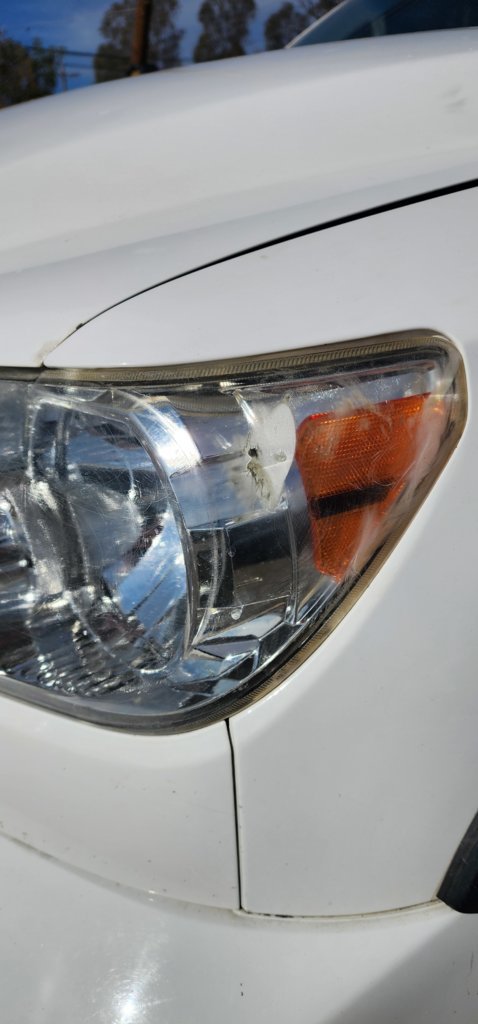

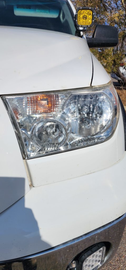

    AstroDude
    Aug 4, 2019
    #34135
    255
    Eddie
    Well I thought I had some old photos...but I don't. My lights were pretty yellow. If you decide to go this route, just don't sand it too hard or else you end up melting your lens like I did. I used water the second time around and the results came out better. 1st attempt (right side) 20241203_112240.jpg
    2nd attempt (left side)

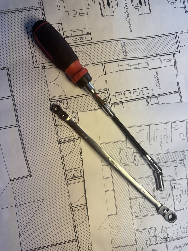

    My Morimoto adjustment "kit". (8mm)
    Vert adjustment are closer to the engine. (I use the driver and socket for those). Horiz adjustment are closer to the fenders. (I use the wrench for those). FYI

    Thanks for the help, makes that unknown a lot easier. I really should get a set of those extended flexhead ratchet ends. Probably
    the only tool I don't have yet.

    I actually started my flexhead ratchet collection from needing to adjust my Morimoto's. As a matter of fact, here is the link to the one pictured. https://www.amazon.com/dp/B0CNTTB92X
    T
    he horizontal adjustment can be a little awkward to get to, and that tool makes it a snap. :thumbsup:

    eccracer104
    Dec 18, 2017
    #11593
    3,002
    San Diego, CA

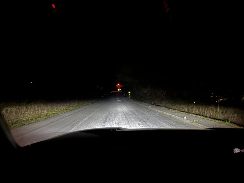

    Low beam output photo
    (High beams illuminated all the way to the sign at the top of the crest)
    Blown away with how great these Morimoto XB work!
    Comparison of OEM and Morimoto XB:
