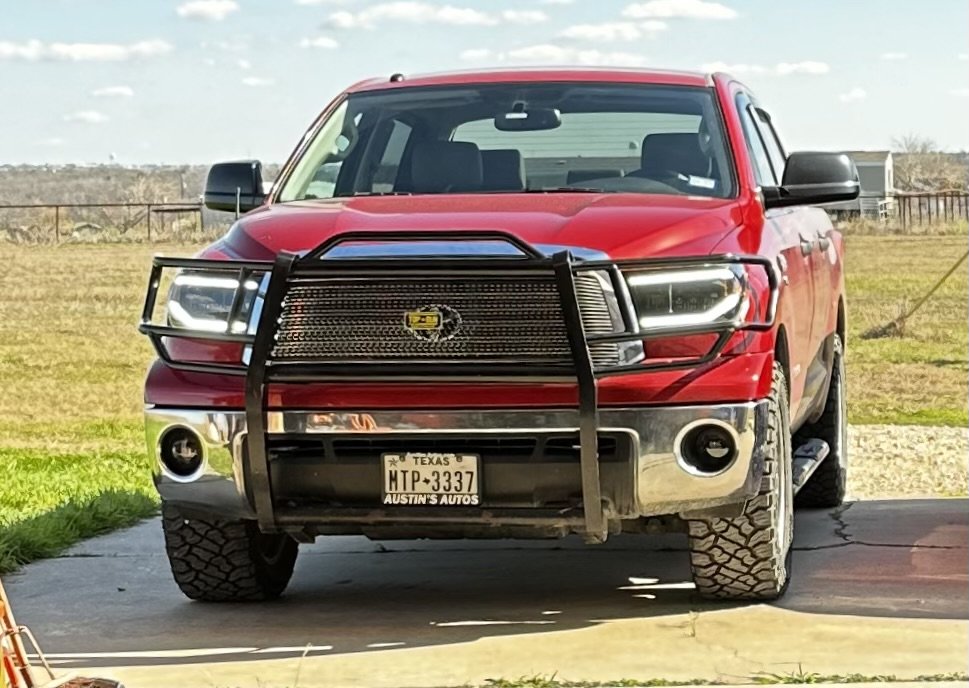

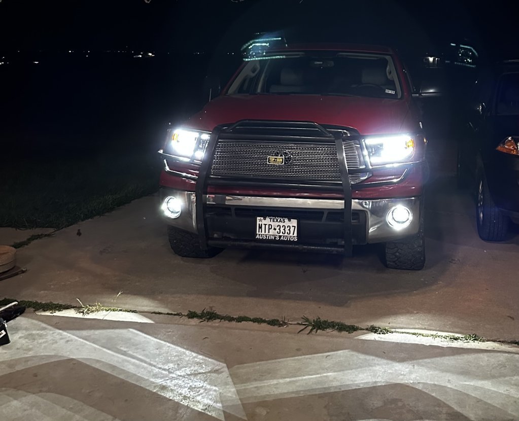

    I am a fan of Morimoto XB LED headlights. I put a set on my 2011, and I love them.
    The XB's have really bright DRL's, available in either white or amber. (The DRL's dim a bit when the headlights are engaged). The XB's also include the leveling motors to provide that functionality if your Tundra is so equipped. The illumination over the stock incandescent lights is impressive.
    Installation was easy. I followed this video and had no problems.
    https://youtu.be/kcxQssGld1o?si=J0s7vmVmBnc3vZgs
    Adjusting them is fairly easy so long as you have an 8mm wrench and an 8mm socket.
    I have had no issues with any ingress of moisture in the housings (so far).
    The XB's are a bit pricey. I shopped around quite a bit before purchasing, and I looked at several different makes/models of headlights. I've been very pleased with my purchase so far.
    (And those are the Morimoto XB LED foglights also).

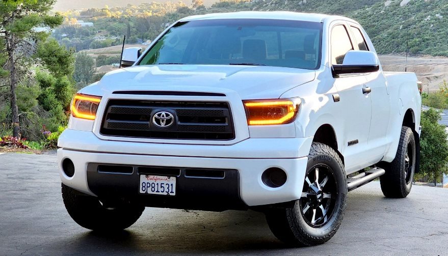

    I spent a lot of time looking at both the Morimotos and the AlphaRex headlights (all three Alpha models that fit gen 2.0 trucks). I have a 2008 also. The warranty was one of the things that pushed me to Morimotos. Five years on the XBs. Two years for the Alpha Luxx. There aren't any user replaceable bulbs in either headlight so if I was going to drop a bit of cash I wanted a good warranty.
    THe Alpha Luxx are projector headlights where the Morimotos are a reflector setup, but the Morimotos have a great cutoff. Black Friday will be here soon which is when I bought mine last year (20% off direct from Morimoto). I went with the slightly more expensive amber DRLs. The DRLs are very bright.
    Like Thumper_6119 says, the Morimotos come with height adjust motors built-in. Although that wasn't an option for our 2008s, it wasn't too hard to add the adjust feature since the Morimotos have the motor. I bought a cable/harness off Ebay and ran it to my cab and added the height adjust "switch". Works great.

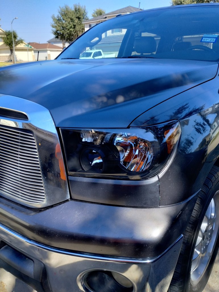

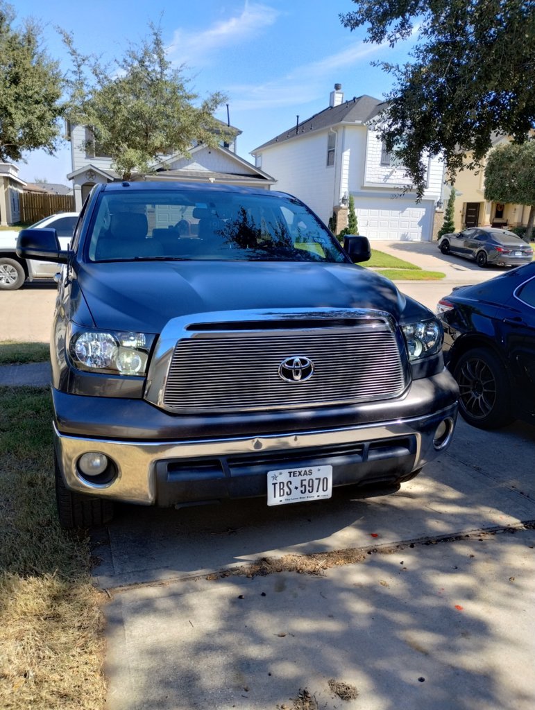

    You certainly have a waaaay higher budget $$ than I did Wich is good (options)
    My 11 Crewmax had the OEM
    motorized/leveling feature for towing duty but the surface in this Texas heat is hell on PVC lamp housings making them dull.
    I saw some on Amazon for 98$ I've used before on my
    Tacoma and they have lasted very well no moisture after 3 years... that and light distribution was also important to me being I installed some H11 LED Lamps for the Tundras housing. Aside from having elevation adjustment these came spot on out the box all the intensity shines down on the pavement about 10 to 15 yards or so with room to adjust as not to blind drivers or Johnny Law. With Morimoto on your mind I doubt you'll want these Poboy specials lol. But if you like I can post the lamp housing type for you.

    What kind of front crash bar is that?
