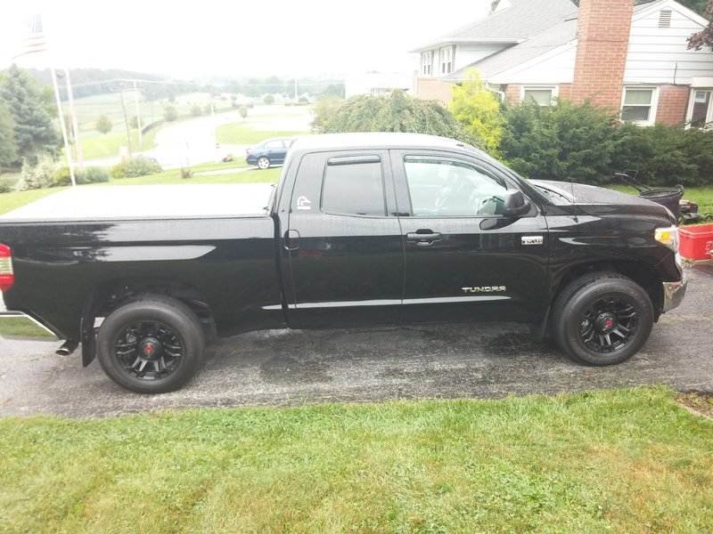

    I m leaning more towards the leveling kit
