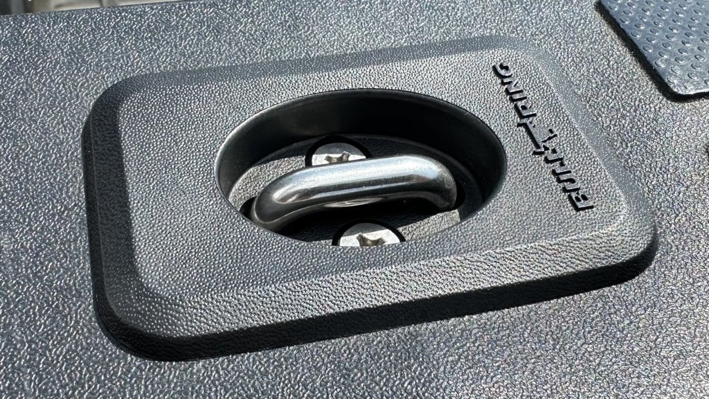

    Added some molle storage:

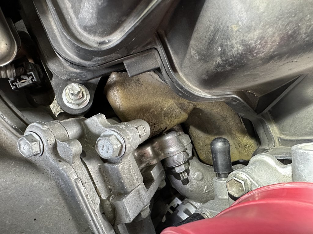

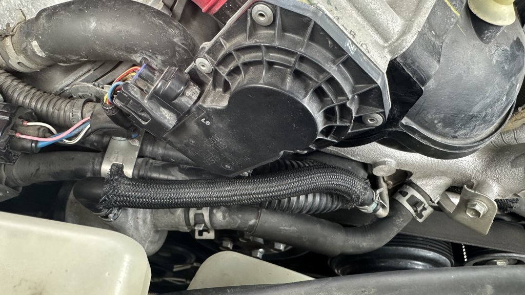

  11. Sep 30, 2023 at 4:31 PM

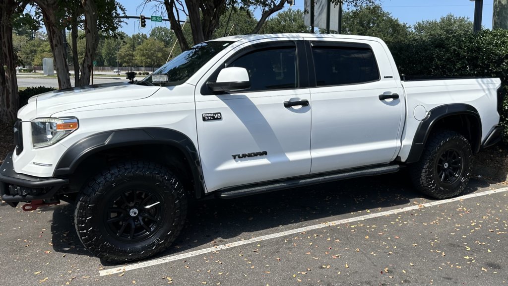

    Busy day! I replaced my W'd OEM leaf springs with a set of Alcans at 1.5" lift for 700 lbs., and bought their adjustable shackles and u-bolts too because I'm OCD when it comes to brand names! :rofl:
    Steps I took...I am nowhere near as mechanically inclined as others on this site, but it wasn't hard at all. Perfect example of me being only a part-time shade-tree...this was my first project using my new impact gun...holy schnikes, why haven't I been using one of these my whole life?!?!? :rolleyes: Took about 6 hours...yes I'm slow :D. I probably did a lot that didn't need to be done (like remove the lower shock bolts, some don't do that, even Alcan's install video doesn't remove the lower shock bolt o_O), but I wanted to be "better safe than sorry". Again, these are just the steps I took...I wouldn't call this a "guide" or anything.
    1) First thing I did was unbolt brake line brackets, speedo line brackets, every line bracket I could see that was attached to the axle. Better safe than sorry.
    2) Jack up rear end by diff as high as you safely can (don't forget tire chocks) until rear tires are off the ground, remove rear tires, put jack stands under the frame as far back towards the rear as possible, lower truck onto jack stands, then keep lowering jack until you see it come off the diff, then jack the diff back up a little to where it lifts the diff just a tad, to release pressure off the shocks.
    3) I did the driver's side first, then the passenger's side. I removed the driver's lower shock bolt. I kept the shock bolt on the passenger's side so I wouldn't get too much axle shift when the driver's leaf spring came off.
    4) I then lowered the jack once again to where it came off the diff, then raised it a tad again to get pressure off the leaf springs.
    5) Removed u-bolts.
    6) Removed front leaf spring bolt.
    7) Removed the two shackle bolts, then pulled the leaf spring out.
    8) Put the new Alcan leaf spring on my handy Griots Compact Sit-On Creeper and rolled it to as close to the rear axle as possible, then my wife (God bless her :)) helped me get the leaf spring on top of the axle on the perch. FUN FACT: Alcan does ship their leaf springs to where you need to pay attention to which spring you put on which side...the Alcan sticker will be closest to the rear shackle, and, the keeper bolt heads (keepers are the brackets that hold the leaf pack together) should be on the inside (so if a bolt happens to come loose, it'll be away from your tire minimizing risk of puncture).
    9) Greased up the front leaf spring bolt, installed it, and tightened up good, will torque later.
    10) Greased up the two shackle bolts, installed them, and tightened up good, will torque later. I chose the 1/2" setting, so with the 1.5" spring lift, I'll get 2" for a nice rake.
    11) Installed the u-bolts, tightened up good, will torque later.
    12) Reinstalled the lower shock bolt (had to jack up the diff a little to get the shock back into the mount), tightened up good, will torque later.
    13) Repeat process for passenger's side.
    14) Put tires back on, raise diff a little to get the jack stands out, lower truck to ground. For my wheels, torqued to 100 ft/lbs.
    15) Recommended by Alcan for their shackle bolts, torqued all four to 90 ft/lbs. For the front leaf spring bolt, I've seen so many torque settings for those...Alcan recommended the same, about 90 ft/lbs. Lower shock bolt 66 ft/lbs.
    16) Frankly, the toughest part...torquing Alcan's u-bolts to 130 ft/lbs! Torquing 8 nuts to 130 ft/lbs almost killed this old fat guy!! :rofl:
    Pics of the old springs, areas where you remove line brackets, finished product:
    And for dessert...installed a little "bling" :thumbsup:

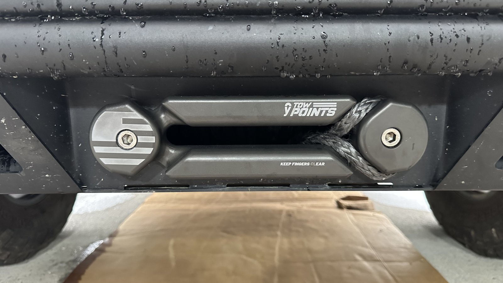

    Finally got ditch lights, purposely made it one of my last lighting mods. CBI Offroad brackets, and a pair of cheapo Nilights I had from years ago when I was using them as backup lights. Will upgrade to DD or other higher-end lights once these start to condensate or die.
