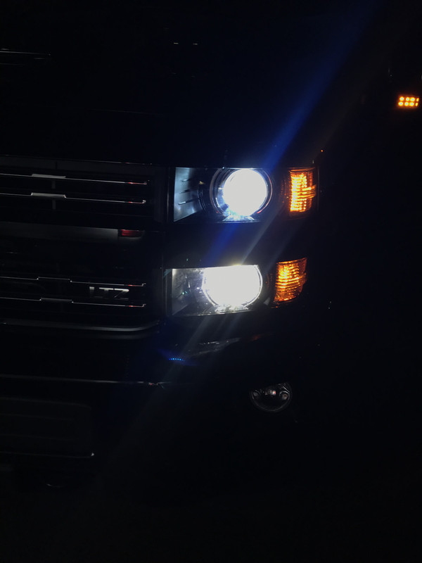

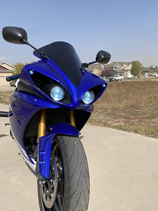

    Thanks for the reply. Curious, did you disconnect your DRL plug? A 2006 may have the separate bulb for the DRL, can’t remember.
    As I spoke with another member, I have had only one issue with mine with the fog light ballast. The connector got water in it and it shorted out. Xtreme vision sent me one free of charge under their two year warranty. I have Xtreme vision in my 2016 2500HD, ‘11 Yamaha R1, ‘08 Raider and my tundra. They have all been in for over a year and that is the only issue I have.
    Colors on the other hand can vary from brand to brand but these have been pretty consistent, at least for me. All my other rigs run 8k temp and the tundra has 6k.
    Hard to see in the daylight but 8k temp here.
    Again, 8k here.
    These are on my 2500HD. The top light (low beam) is 8k hid and the bottom light (high beam) is 6k LED. I chose LED for the high beams so when you flash them, the light comes instantly vs an HID that takes a few seconds to warm up.
    Same light, different angle
