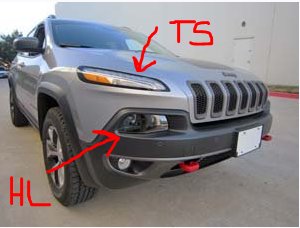

    FYI, the slivers that I believe you are referring to are turn signals, the headlights on that generation Cherokee are in the middle of the bumper. The headlights look to be standard projector style headlights from my brief search on google.
    shifty`[QUOTED] likes this.
  13. Nov 14, 2023 at 12:19 PM
    #253
    KNABORES
    KNABORES Sarcasm incoming
    Jan 1, 2020
    #40572
    14,242
    Arkansas
    Confirmed, my daughter has a 2015 Jeep Cherokee. DRL LED is the top sliver, the headlight bulb is a halogen projector in the middle slot and the fog is halogen reflector below it. I upgraded both her fogs and headlights to LED bulbs. works great.

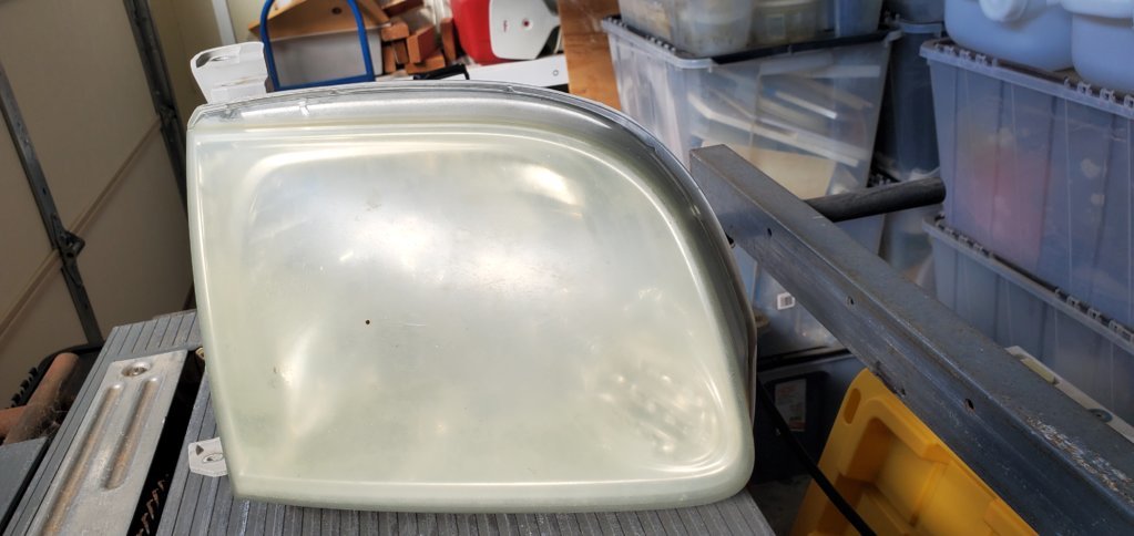

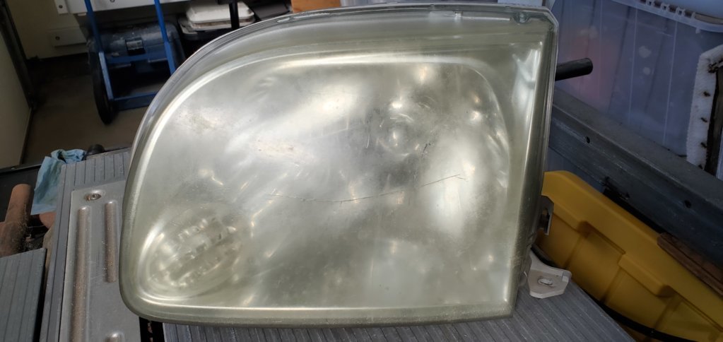

    this thread is nearing maturity, so I thot to re-kindle interest by referring anyone on the fence about modifying HLhousings for HID, LED, etc use that I have my old pair fr/my 06 SR5 AC up for adoption...Both are glazed over and Drvr sidehas a horizontal crack across middle, but short of extending all the way to left or right edges [see AD pics @ 'ForSale' page]. Otherwise, fully intact, operational w/oem bulbs in place [a bit dusty].
    Price: Whatever it costs to ship to you in the cardboard boxes my new ones came in [+ a 32oz Pacifico] Im in 92110. [San Diego].
    if interested, pm me?.
    Also, chk my AD [link below] for more pics...
    https://www.tundras.com/threads/oem-headlights-f-06-sr5-ac-v8-2wd.148007/
