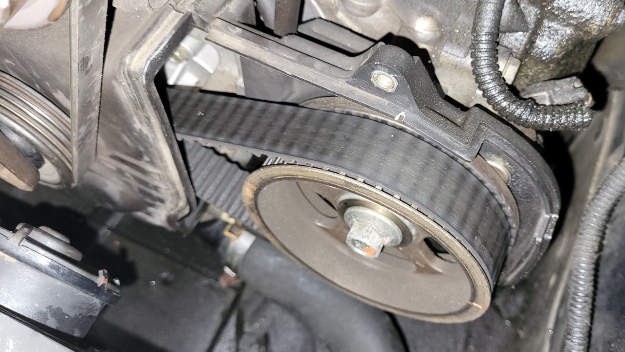

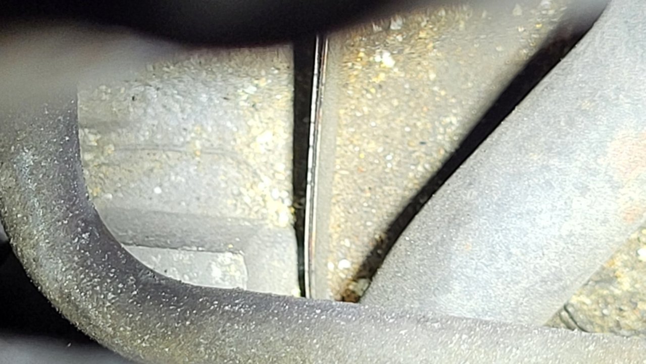

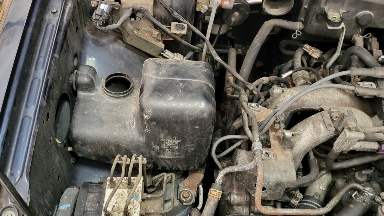

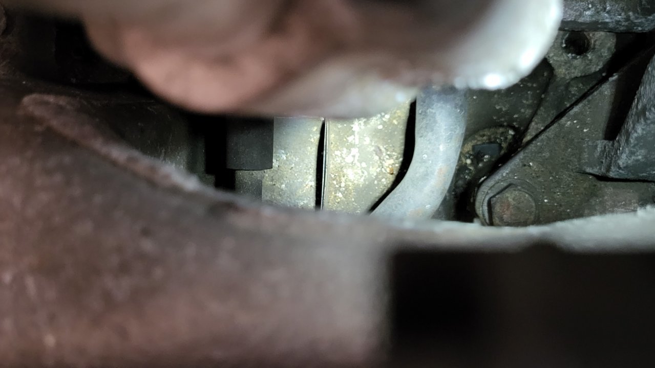

    I spent some time with the Subie in the Tent of pain today.
    Here's pictures of the head gasket on the drivers side. Cylinder 2/4. It appears to already be some sort of MLS gasket.
    So if so, that's a HUGE win!!!
    Popped the timing belt cover off on the drivers side. Yep. Just as I thought. Needs a timing belt.

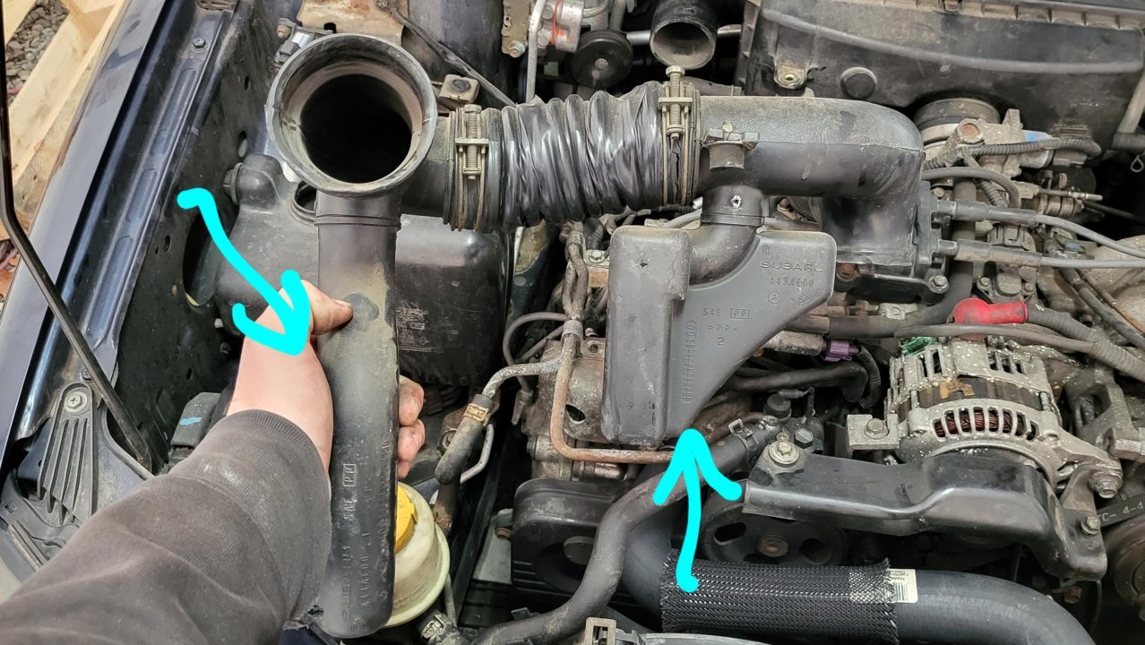

    I also pulled the passengers side air box/tube assembly/thingamajig off, and pulled both of those spark plugs. Cylinder 1, and 3. They looked good, but didn't take pictures.
    I don't know what these doodle danglies are dangling off the air tubes. They don't have openings, and are "sealed." I can't fathom what they're for. They are pre-engine air filter.
    I also don't know what this box is for either. The intake tube goes to it also, but again this box is "sealed." No vacuum lines or anything like that attach to the intake, or if there are supposed to be, there weren't. I can't figure it out myself. Any thoughts?

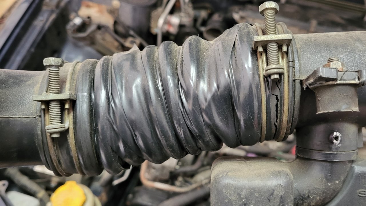

    Also, the intake tube is electrical taped up. Looks like a bunch of cracks all up on the "flex" part of it. I'm sure I can get a new one on rockauto. I gotta make sure this bitch will reliably start first.

    Those dangledoodles on the intake are resonation chambers. Each one quiets a certain frequency range, like the hemholtz resonators on DD exhaust.
