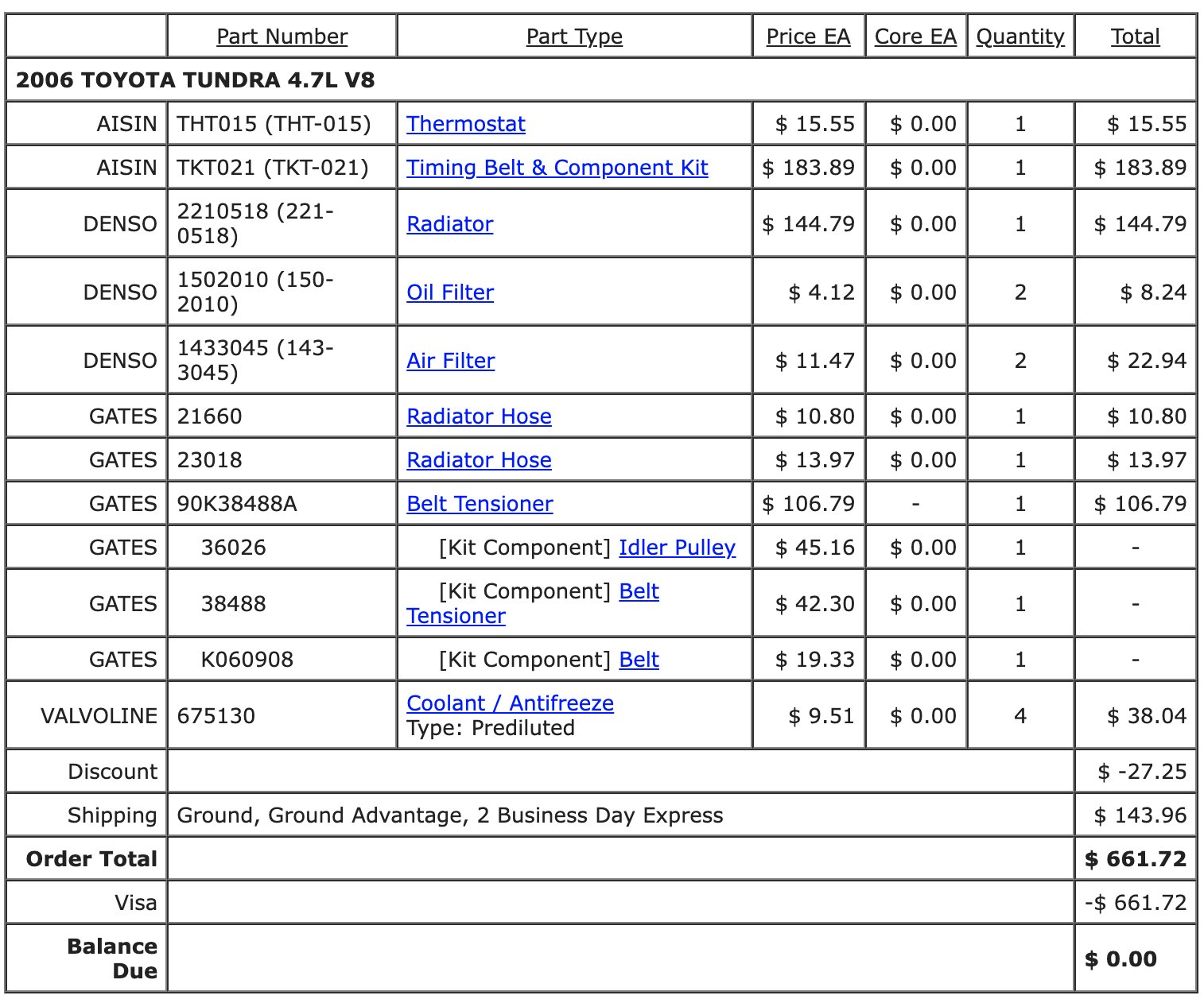

    So here's what I'm thinking so far:
    Included in the kit linked above:
    Timing belt
    Water pump
    pulley
    Tensioner pulley
    tensioner
    Additional stuff I should probably go ahead and do:
    Serpentine belt - thinking gates heavy duty because why not..https://www.rockauto.com/en/moreinfo.php?pk=1269362&cc=1432861&pt=8900&jsn=11
    Idler pulley and tensioner for the serpentine belt. Brand recommended?
    Thermostat - Aisin 180*
    Radiator - what brand would you guys recommend?
    Radiator hoses - what brand? and should I just do upper and lower or try to replace other stuff?
    Contemplating since I will be in there:
    Fan clutch
    Anything else? I would rather take the time and do it now because I hate spending time wrenching so if I'm going to I want to replace as many things that are reasonable to replace now. besides I'm gonna save a grand doing all this by myself so I got a bit of money for parts
  18. Jul 8, 2024 at 4:40 PM
    #48
    Jack McCarthy
    Jack McCarthy It’s always the fuel filter
    Nov 2, 2020
    #54409
    11,002
    Bill
    North of Boston
    02 Tundra AC SR5 V8 4x4
    Denso for the radiator. I’m not sure of the need for radiator hoses or who makes them for Toyota.
    Continental Elite which used to be the Gatorback serpentine belt. OEM has a tendency to start squeaking after 50k miles.
    Idler pulley and tensioner should be part of the Aisin kit, are they not?
    MTPatrick[OP] likes this.

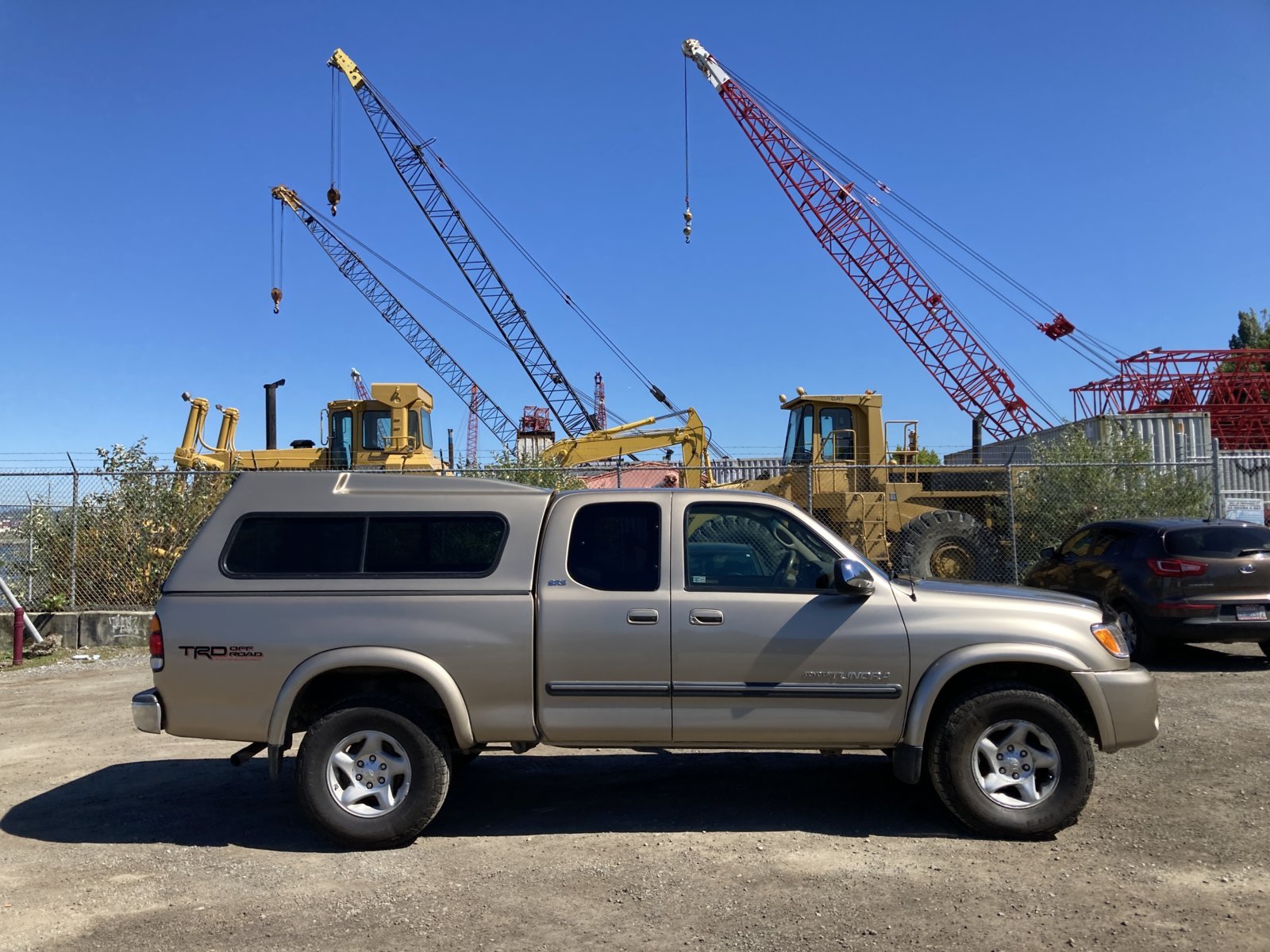

  24. Jul 8, 2024 at 7:16 PM
    #54
    MTPatrick
    MTPatrick [OP] New Member
    Jul 5, 2024
    #119441
    35
    Patrick
    SW Montana
    2006 Tundra DC 4X4 Limited
    Here's what I ended up ordering. It will all get here by friday :)
    Elevatorguy and Kimosabe like this.
  25. Jul 8, 2024 at 7:17 PM
    #55
    shifty`
    Jun 20, 2020
    #48239
    31,487
    ATL
    '06 AC Limited V8/4WD
    Carefully inspect the radiator and all bibbs on arrival.
  26. Jul 8, 2024 at 8:13 PM
    #56
    jimf909
    jimf909 Battery almost dead...
    Jan 18, 2021
    #57786
    404
    Washington or Idaho
    '03 Tundra SR5 AC 4.7 TRD w/LSD
    Dead stock with oem 16" starfish wheels. We'll see how long that lasts. :) Topper of unknown origin.
    1) That looks like a nice truck for the price. Well done.
    2) Good call on replacing the radiator. I wish I had ordered one since it's so easy to swap when doing the timing belt and the risk to the trans isn't worth not replacing it. I wasn't fully informed at the time.
    3) I didn't notice if you've seen the timing belt sticky. It was invaluable to me when I did mine: https://www.tundras.com/threads/timing-belt-master-thread-sticky.107240/
    4) Since this appears to be the ID/MT reunion thread, here's my Idaho Tundra. Originally sold by Parker Toyota (CDA) and lived it's life in Priest River. I got a good deal on it from a friend for $7K in 2021 with 225K on it. It does have some light frame rust from the chemicals they've been using on the roads up here the past 10 years or so.IMG_2742.jpg
