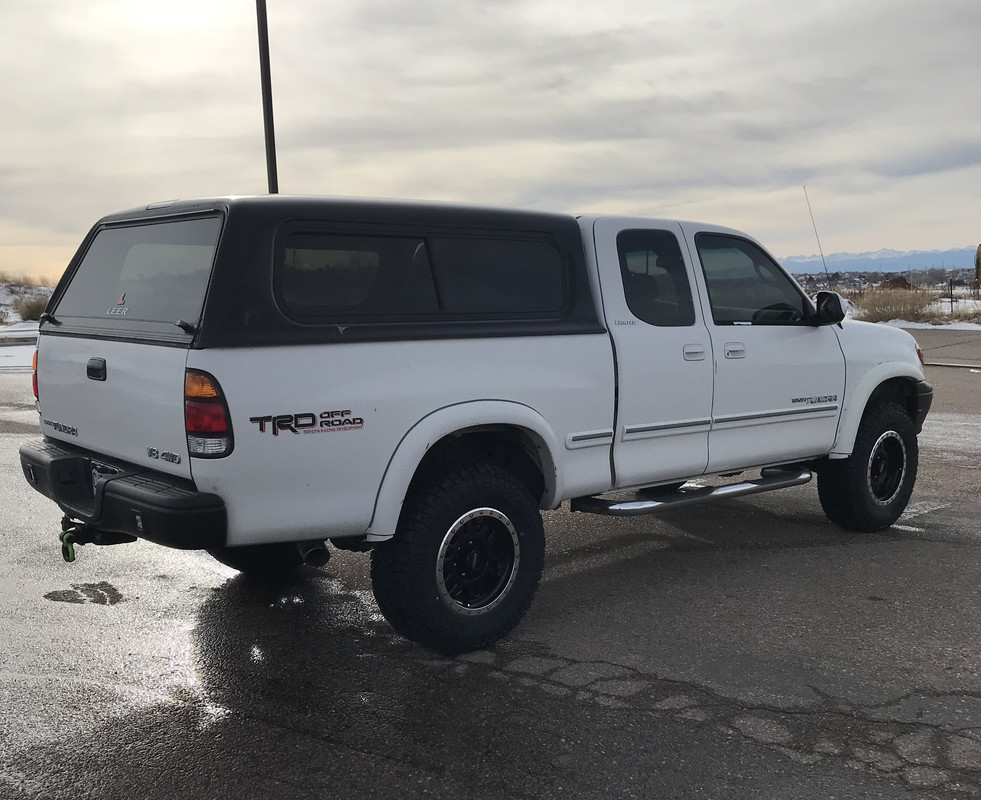

    I see you are a 1st gen owner.
    Can I talk you out of it? Probably not what you wanted to hear, but here is what I went through...
    Old man emu 2.5/1.5 with an add-a-leaf in the rear.
    Kit showed up, looked great, excellent quality, fun to install. Good stuff so far.
    I used a 1" diff drop to lessen the angle on the CV's. Also very easy to install.
    So I got everything together. The rear springs were saggy from 20 years on the road and the add a leaf packs didn't quite get the rear end up to the same height as the front. "Cali lean". It didn't look terrible, so I moved forward.
    I drove it for several miles to get a feel for it. Definitely a lot more body roll than I expected for such a modest lift. Poked my head underneath to check things out and both CV boots were spitting grease, again due to 20 years on the road. I now have to replace those.
    Off to the alignment shop... Went to a place with a good reputation. The alignment turned out terrible. I have been told that the cam bolts freeze into place requiring them to be cut out and replaced in addition to the lower control arm bushings. The shop called me and said everything was done, no issues. I picked the truck up and the camber still looked terrible, additionally the shop could not produce the alignment measurement sheet.
    I noticed there was a nearly identical 2006 on the alignment rack, same color, lift height and everything. Well, they got confused and gave me the alignment sheet with that truck's information on the header, but they insisted it was my truck (not buying that). SO, now I have to take the truck back in after I replace the CV's (also replacing the lower ball joints while I'm in there). The shop even tried to charge me a 12 dollar hazmat fee which I said I would not pay under any circumstances, it took them half an hour to delete the fee, but they were waiting for me to say "I'll just pay it." Well, no I didn't. It's pretty much a slam dunk that they are going to accuse me of changing parts and wanting a "new" alignment afterwards. Admittedly, the alignment situation is entirely my fault, I shouldn't have driven off until they reverified everything.

    Don’t feel bad about the alignment cost. I paid Les Schwab $89 the other day for an alignment. I swear a couple years ago it was only $60.
    Anyways yeah, I had the same problem with the cv boot spewing grease last week about after I put on a 2 inch leveling kit. I posted a thread about it not too long ago.
    All in all though your truck looks pretty good with all that. I would’ve given the alignment shop a harder time in your case.

    I feel like your truck would look pretty rad with some fatter tires with your lift
    Finnbear[QUOTED] likes this.

    Really my only reason for lifting it was to use v-bar tire chains without having to have an extra set of smaller tires so everything would clear under the fenders. I agree though, it would look much better with some stuffed wheel wells!

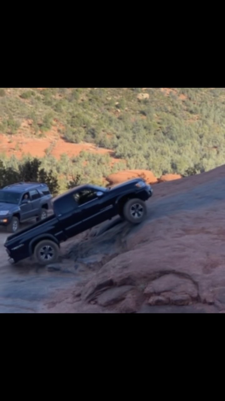

    5 inch TC Lift. Icon 2.5 Ext. travel coilovers- Icon Resi- shocks w/Firestrone air-ride 285/75/17 Toyo OC Ext. FN Overlander wheels Retrofit Projectors Kenwood H/U Natika Back-up camera
    I think you're UCA upgrade depends on what you really end up doing with the truck other than driving on the street. None of the better brands are necessarily cheap.
