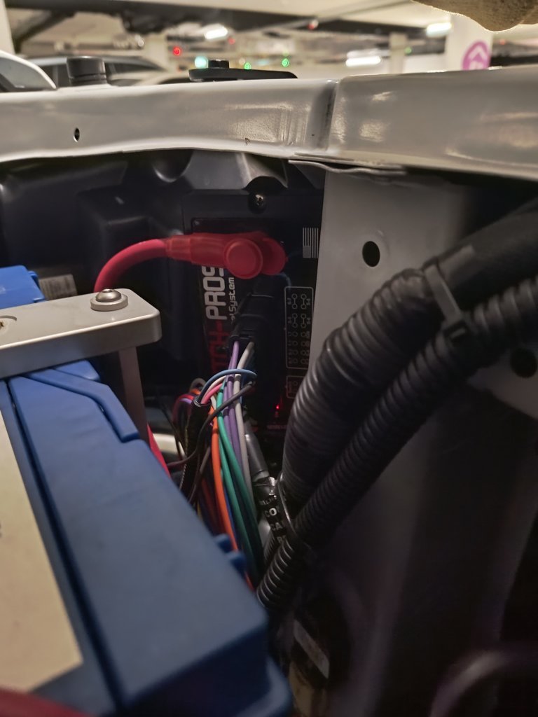

    I’d move it forward myself. Vibration could wear away the wire coating. I had to move mine once - just silicone up the old holes.

    Shouldnt be an issue, but you can put another harness cover over the loom for extra protection. The wire loom covers are pretty cheap.

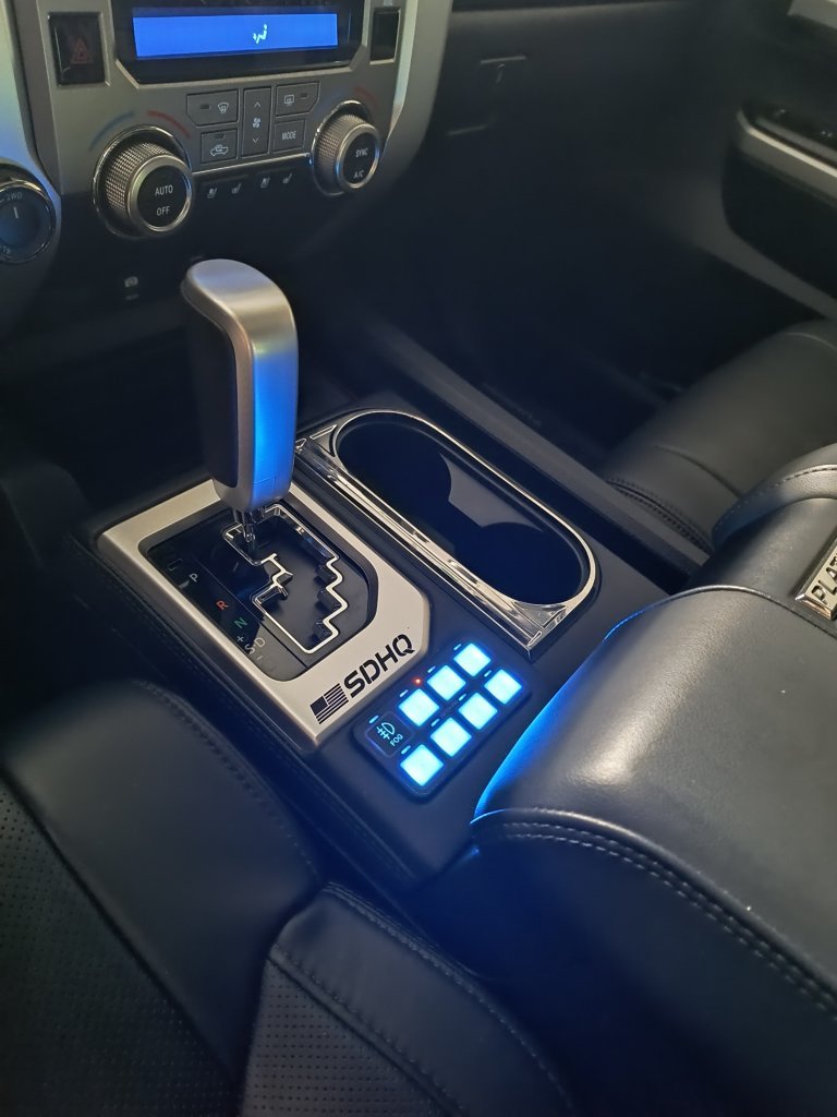

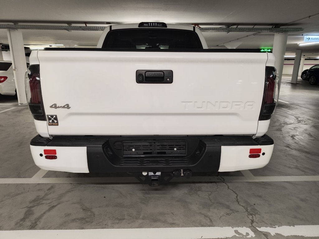

    Hello,
    This is how mine is mounted.
    Nothing Earth shaking.
    Currently only rear fog lights (mandatory at least one in Europe, switch must have a light and they can only be activated when the front ones are), as I like symmetry, there are 2 mounted on the rear. Another switch will be dedicated to the additional lighting and another one to the air compressor.
