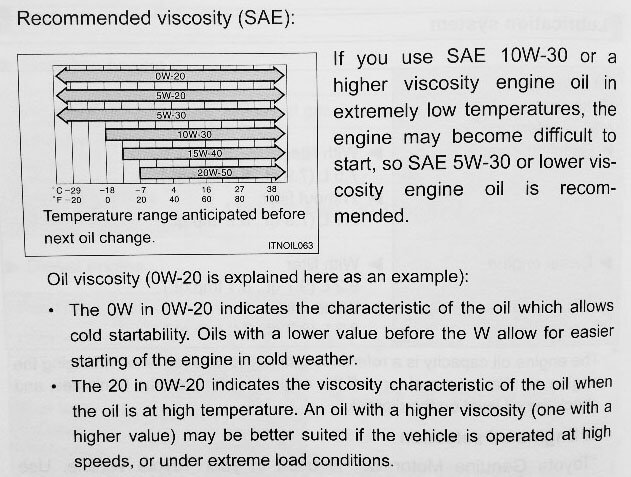

    If you believe that chart, 0W-20 is good to the same max temperature as the other weights.

    I’ve been tempted to switch to 5w30 especially being supercharged, but I keep coming back to the cold start. The majority of wear happens at cold start so the sooner you get any oil regardless of viscosity where it has to be, the better. This is where 0w20 would be beneficial.

    Yeah man, Siberia. All I know is it flows better when cold. That’s just the nature of a thinner oil. I can’t say how much better, I haven’t studied it. Maybe it’s negligible :notsure: Still a point worth considering.

    This is why I was considering 0W-30.

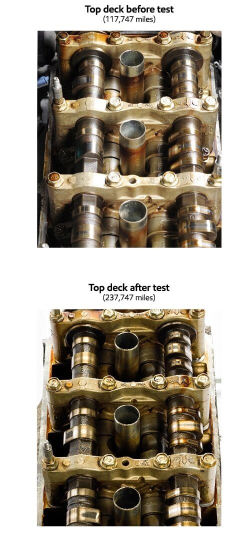

    Yes, but Mobil was using 20,000 mile oil changes for this test in order to showcase their Extended Performance oil, which is designed for 20,000 mile oil change interval. Quite likely there would be less varnish if the oil change interval was decreased.
