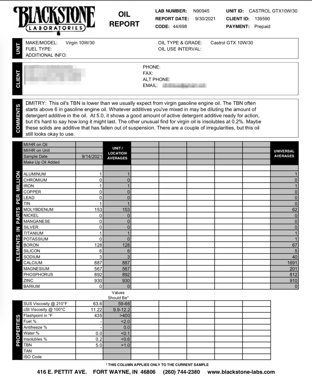

    I had one VOA done after mixing 8 quarts of Castrol GTX 10w30, 4 oz of graphite additive, 4 oz of ZDDP additive and 8 oz of PTFE. Insolubles at 0.2%? Lol
    Will do one with ZDDP 4 oz / PTFE 8 oz / graphite 4 oz / POE 6 oz next.
