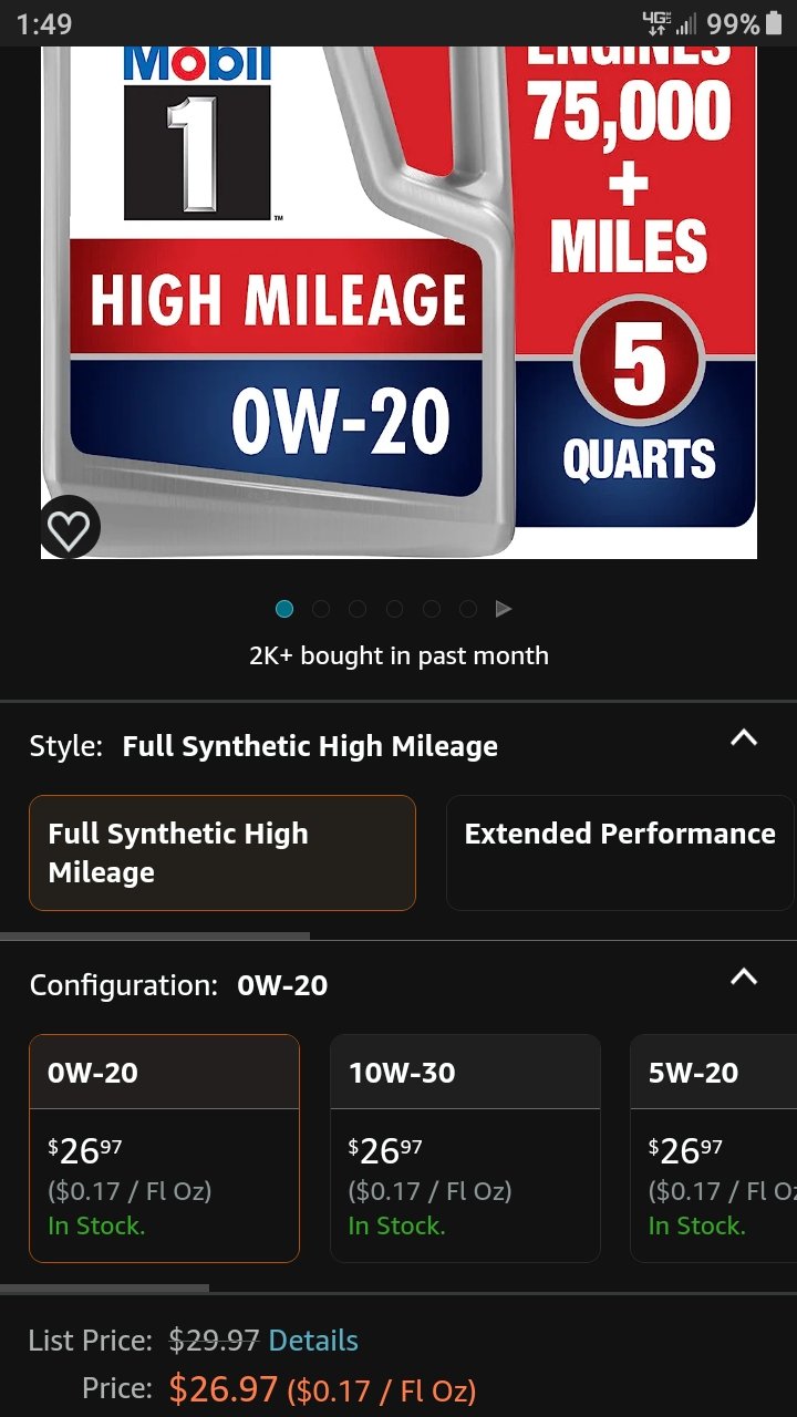

    Walmart July, 2023 5 qts of Mobile 1 "Extended Performance" $29.

    That's about what it cost me!

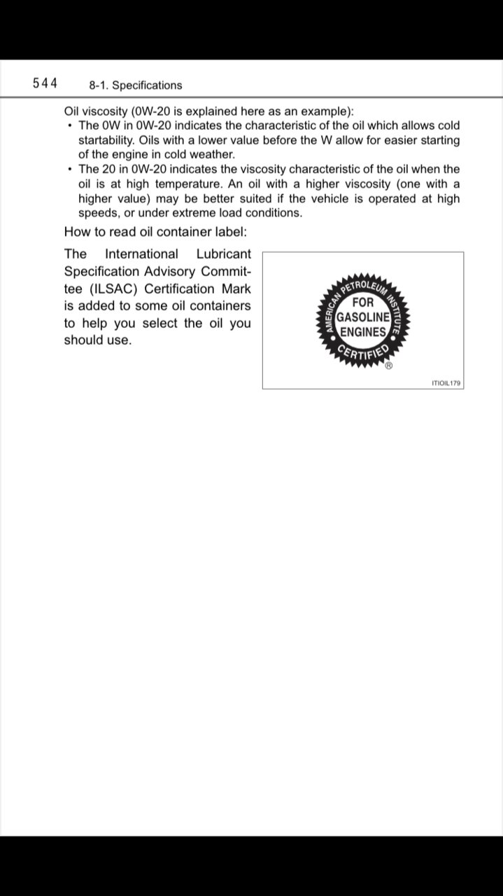

    I've noticed the transmission loves to keep the revs down in this truck. Tow haul and S4 for me.
    This line in the owners manual was the reason for my 5w30 switch:
    The 20 in 0W-20 indicates the viscosity characteristic of the oil when the oil is at high temperature. An oil with a higher viscosity (one with a higher value) may be better suited if the vehicle is operated at high speeds, or under extreme load conditions.

    Interesting, my 2021 manual states the same thing. “Extreme load conditions” is fairly ambiguous, I wonder if Toyota has anything written down elaborating on what the manufacturer would consider “extreme”.

    I’ll betcha a supercharger qualifies as extreme load. Hence 5w-30

    I'm considering pulling a 7000# trailer over mountain passes with a truck rated for 9800# extreme.
