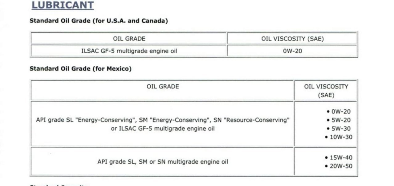

    Because it's not actually one of the approved oils by Toyota. I'm sure it will work just fine though. Personally i run 5w30 in the winter and 15w40 in the summer.

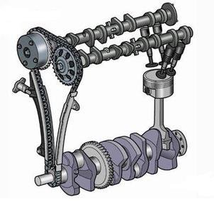

    Well, if it reaches metal to metal, then I doubt a film of oil is going to do a lot to stop it. If clearance is 0.00000, then oil or no oil, you'll have contact.
    My truck doesn't make any of those noises. Perhaps a borken 50k truck needs service tune up instead of heavier oil?
    RichterScale likes this.
  8. Jul 26, 2023 at 1:59 PM
    #488
    AZBoatHauler
    Aug 13, 2019
    #34576
    9,266
    So.Arizona
    I’d love to hear how the cam is supposed to open the valve without metal touching metal.

    This engine was approved to run several different viscosities of oil. When Toyota narrowed down the approved range of oils (in the USA) to just 0W20, the engine didn't change.
    Some manufacturers have only ever approved one viscosity of oil and that's were the difference lies.

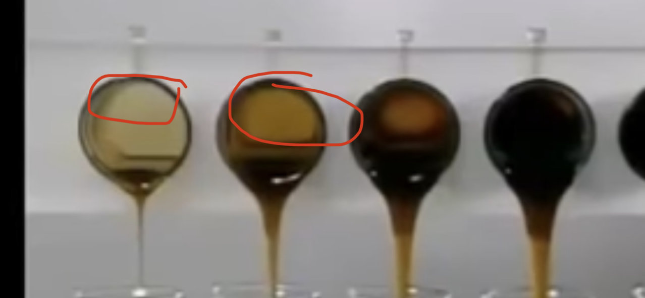

    The clarity of the empty jar is my argument against 0w. Pouring water.

    I’d bet his engine is 80* or colder on morning start so how is it 0w vs 5w makes no difference? You act like 95* is operating temp. The second number is the viscosity at 212*F - that’s a lot hotter than startup temp. The first number applies to viscosity at start up - even in Southern California.

    Either this doesn't make any sense, or I'm misunderstanding what you're saying.
    It's talking about how the oil flows in cold temps, when you start your vehicle.
    Have you ever started a vehicle that's been sitting in sub zero temps all night? You want the oil to move like sludge and not lubricate anything for the first 10 min until it warms up?
    You keep referencing "water". Well, yeah, that's the point. You want it to flow like water at start up, not like molasses. Btw, all oil flows like water at operating temp, when it's hot. If you're in AZ then you don't have to worry about start up at freezing temps.
    20 weight oil leaves a film like all the others. It doesn't run completely off like water and leave the parts dry.
    There's nothing wrong with running 30 weight. That's not my argument. But the comments about 0w20 being like "water", implying that it doesn't lubricate as well etc, tells me that folks aren't understanding the designations and how this multigrade lubrication thing works. The reasons I'm hearing for why people won't use 20 weight just don't make any sense. Conversely, the reasons I'm hearing for why anyone would run 40 weight in the north east don't make any sense either. Unless you're being funny. I can't tell.

    So.Arizona
    I like oil to stick around where it’s supposed to be doing its job - see the nice dark colored coating on the 5w-30 jar? It is thin enough to move but not completely runoff a surface.

    I know the oils in which it is approved to run, thats why included the screen shot with all the oils Toyota has approved for use in my post.
    Im not concerned that 0w20 doesn't lubricate well, its that it so thin that its much more likely to cause blow by and end up being burned by the engine which once your engine starts buring oil it wont stop. My previous vehicle, a 2014 Subaru called for 0w20 and by 60,000 miles it was burning a quart of oil every 3-5k miles. 0w20 only exists to improve CAFE standards by marginally increasing MPGs. Find me a snowblower that calls for 0w20 and those things literally only start in the cold and almost all take 5w30. Now maybe if you live in Alaska with constant below 0 temps then I would use 0w20 but in normal continental US winters 5w30 is fine.
