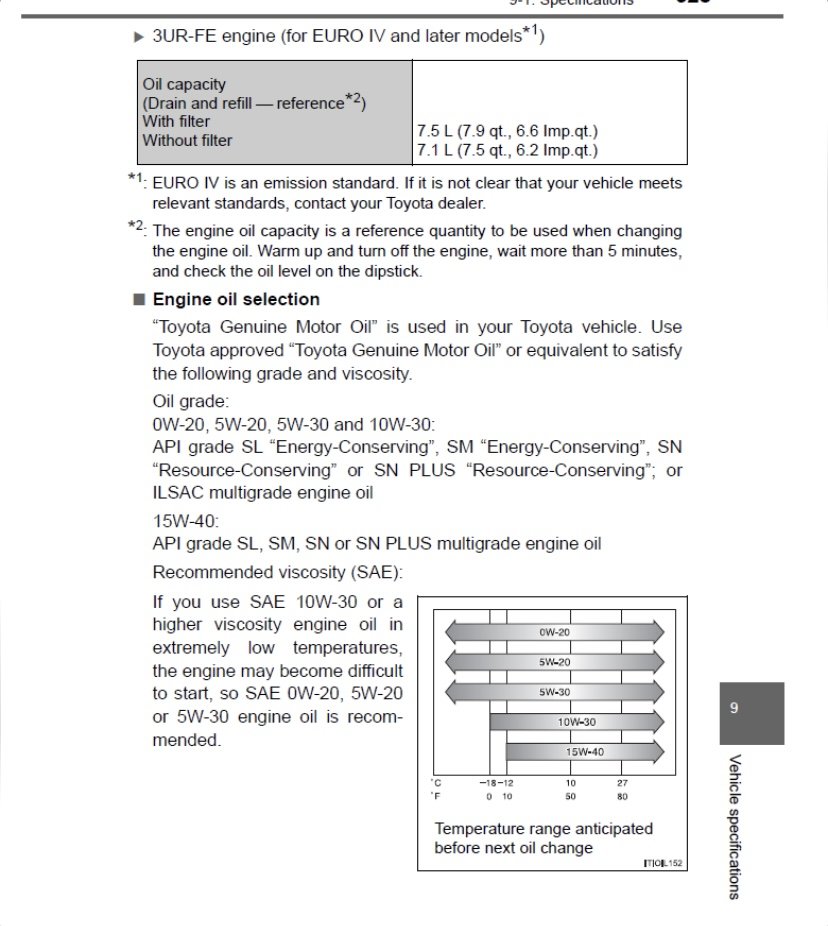

    If you keep reading, it suggest that a higher viscosity might be more suitable for hard use. That is why I switched.
    ATV25, Silver17 and 94537 like this.

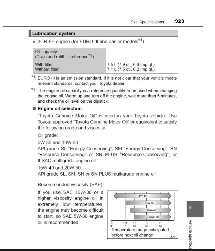

    Ok, I paraphrased. This is the actual text:
    "An oil with a higher viscosity (one with a higher value) may be better suited if the vehicle is operated at high speeds, or under extreme load conditions."
    This is quite the hint from Toyota. This what lead to me switching to 5w30 for towing.
    ATV25 likes this.
