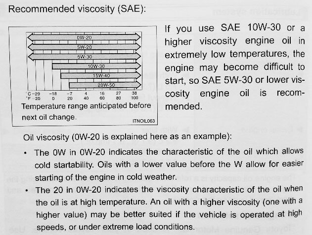

    Just noticed how it says "recommended viscosity", so its not that the 5.7 has to have 0w-20 or it will blow up, but more of a recommendation so its up to EPA/CAFE standards. Regardless, I will take their recommendations with a grain of salt and stick to 30.
