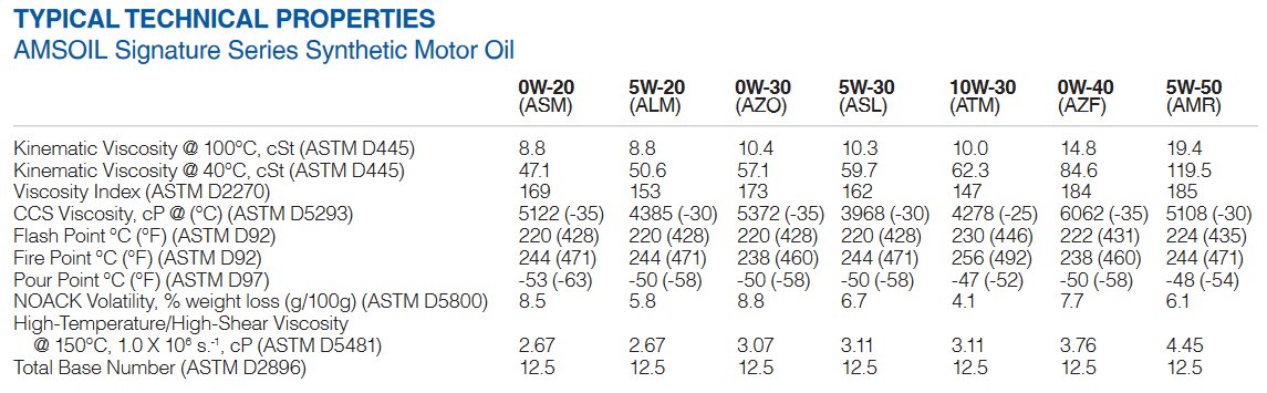

    I dont use Amsoil myself but their data sheets are great because it lets you compare the properties of their different weigh oils side by side. These a values you usually can't find from other oil mfgs.
    So the NOACK improves for heavier weight oils but also oils with closer numbers(IE the 0W-20 has worse NOACK than 5W-20, but 0W-30 also is not great because of the huge weight spread and 5W-30 gets better. 10W-30 is fantastic)
    HTHS improves as the hot weight increases.
    So if I used amsoil I would be running 5W-20 if I was insistent on a 20 weight oil, or 10W-30 unless I lived in Canada or something where I was constantly cold starting the truck in -40 temps. I rarely true cold start my cars since they live in an insulated garage that rarely gets below freezing so I don't mind running 10W.
    nobodyintexas and pursuit2550 like this.

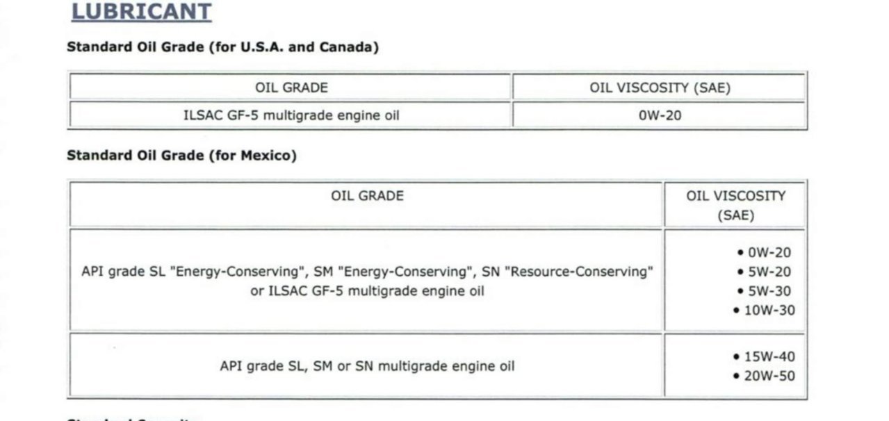

    This is what people used to go by -

    I follow him, he does know a thing or 2. But, I will say that when it come to what he's taking about, Toyota themselves advertise that the 5.7 can use all the way up to 15-40. I believe that the highest. It's been posted on here a time or 2. So if we go on clearances, then there is no issue with Toyota.
    While is interesting sometimes to have these discussions, one has to think does it really matter. I would venture to say that the majority of the people will never see the benefits of what fluids they use on their vehicles. If you keep your vehicles for let's say 100k, you will not see that Amsoil oil pay out. And the next guy used Walmart oil all those miles and nothing happened. Keeping up with maintenance is key.

    20w50 actually lol, not that I'd recommend that unless you're in death valley
