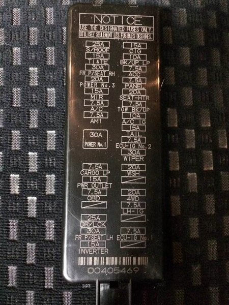

    I accidentally shorted the wires when installing my USB outlet and now none of the 12v ports work. I checked/replaced the cigarette and power fuses under the dash and in the engine compartment. Any other suggestions?

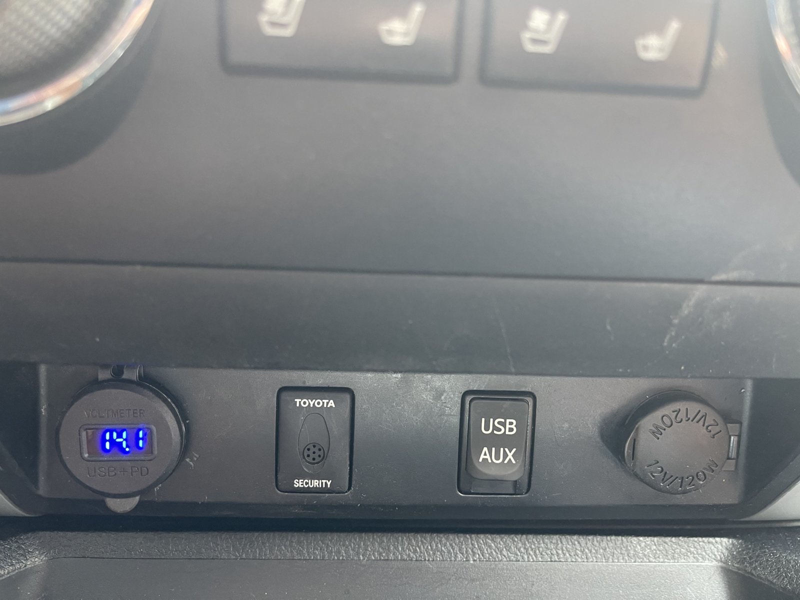

    Slightly OT but my 2010 Grade DC has two front 12V ports. One has been dead since I bought it (I haven't looked into why) the other is hot all the time and pulls out of the dash with the accessory ( :mad: )...
    Is it factory to have two up front or did PO add one (sorta).
    I use this (picture att.) but had planned to use an empty filler block but the Amazoo USB/digital VM didn't fit (Don't buy this).
    This 12V cigarette to dual USB volt/amp meter does work well. Screenshot_20230302-154822_Chrome.jpg

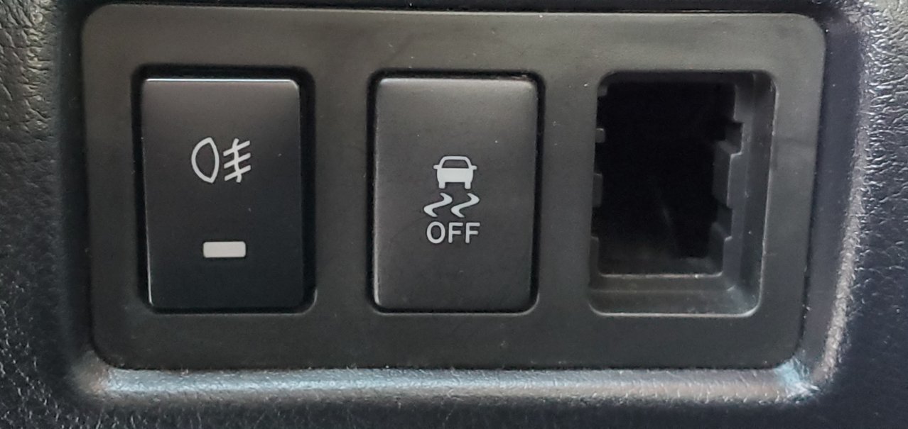

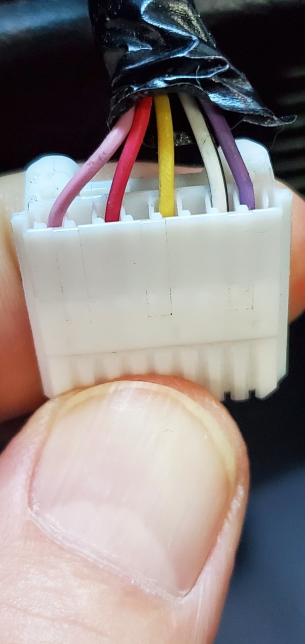

    Last little bit on accessories. The rectangular filler plugs are approximately the size shown. Although I wish I'd measured it before I shoved it in there.
    Claim is, this fog light switch fits Toyota and it does. Now to finish project when it warms up!
    Anyone know what this connector is?
    It was lurking behind the block panel I put the switch in.

    You sure you have them wired properly? Meaning negative/ground to negative/ground and not to positive? I shorted both front 12v outlets and it was the fuse, but the fuse I replaced I recall it wasn't your typical cig/12v outlet fuse. It was a different fuse...can't remember off the top of my head.

    07 Tundie

    they're miniature fuses

    my apologies. I had the same issue and it was 15 amp "Power Outlet" miniature fuse.
