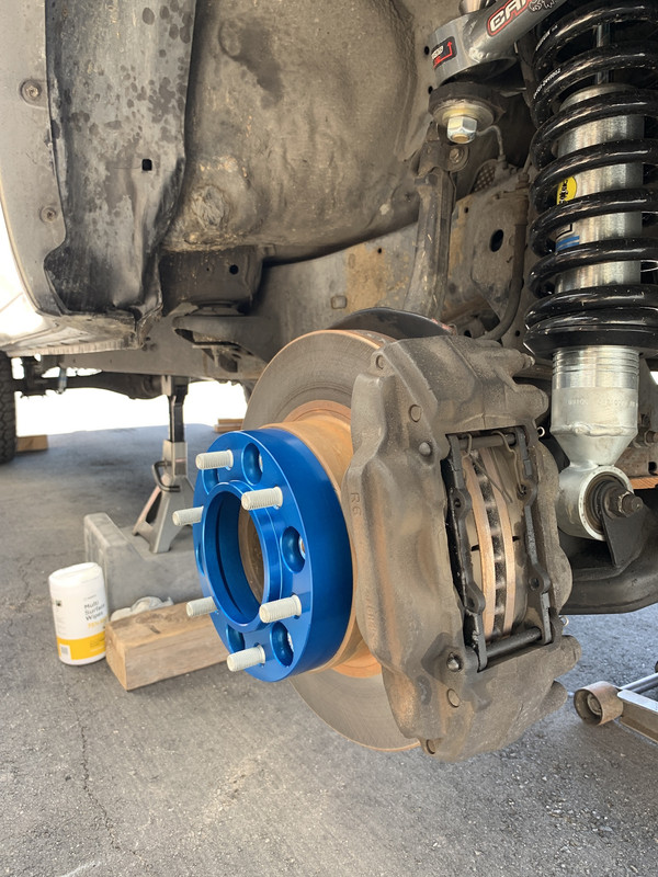

    Looks like they're holding the weight fine. I wouldn't be afraid to bump up a clip or maybe even two.

    I was actually thinking the same thing but I'm not as knowledgeable about this as you so I was holding back. It looks normal to me. The only concern I see is that mangled ABS wire.

    Dropped it off over lunch and asked them to bring it up 1” (Driver Clip 5/Pass Clip 3).
    They mentioned having to rebuild shocks. So sounds like another $220 for that before they even align it.
    I feel better knowing other V8 DCs are happily running 650# coils, plus getting the Darkness Seal of Approval.

    Just $425 later and we have the shocks rebuilt to clip 5/3, the precision alignment done. And definitely only a receipt. No alignment specs.
    Driver is 20” center to fender. Passenger is 19” center to fender.
