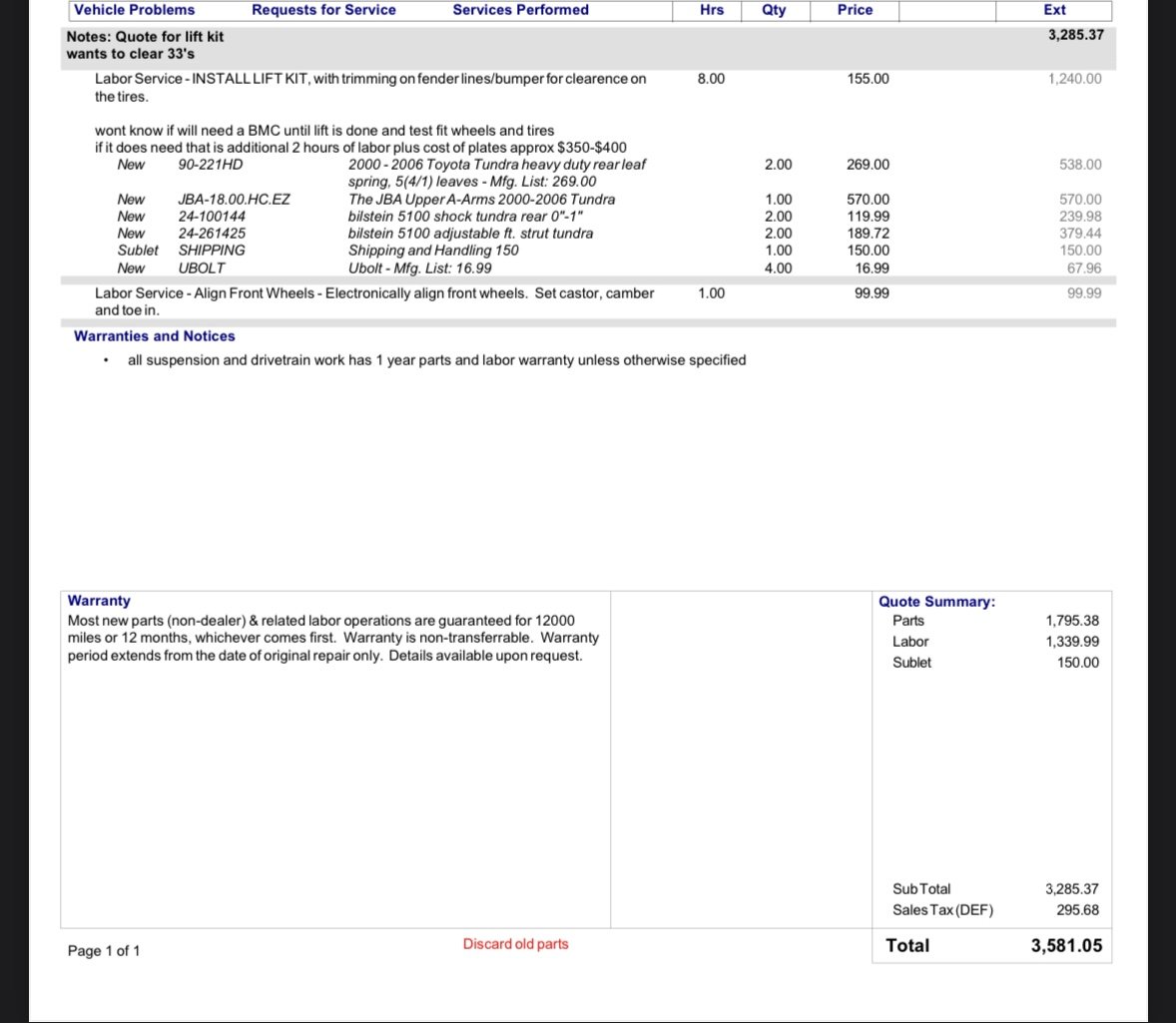

    Hello all, i am planning on changing out my suspension from the TRD to something a little taller. Right now its sitting on 33s and spacers front (2.5”) and rear (2.0”). My goals are to go up trails nicely and i want to also tow a 5k trailer. Just had the local suspension shop look and they quoted me $3581 and they said that they will have to trim the body and possibly do a body mount chop. Does anyone know a way i can tuck the tires without having to cut and chop and maybe have it a little cheaper? Also am thinking about doing the fox racing shocks instead of the bilstein 5100s. Any additional info is helpful thanks.
    PS could i just remove the blocks in the rear for now and replace with the HD leaf springs in order to tow? Will attach quote.

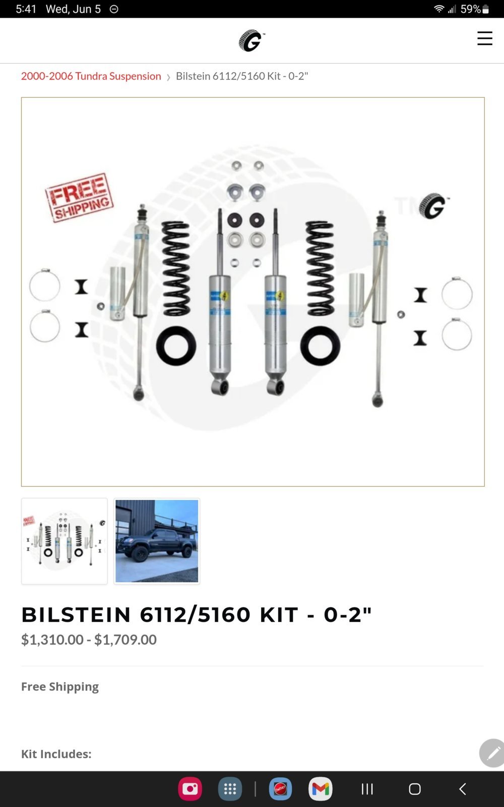

    If you are on a budget you should look into the Bilstein 6112 in the front. Since you are in between the 5100 and the fox.

    Hey Jerry, i had the ball joints inspected and shop said they were good for the time being. Do you still think i should replace em to avoid a later headache? Also i have read that thread a bunch trying to soak all the knowledge i can. The wheels i have on have a -12 offset and 4.5 back spacing. Tires are 285/70R17 BF goodrich KO2s…
    As for trails I live in washington so im hoping to do some of the BDR routes out here.
    ill check out the 6112s and that is the leaf pack im looking at.
    What i am unsure of is if those leafs with 5100s, 6112s, fox, etc. will achieve enough lift without chopping the body.
    also what tools would i need to do this job. Im not opposed to doing it myself ( and would prefer to) just dont really know what im doing.

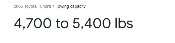

    You need a bigger truck or a smaller trailer. Stock form the best tow rating is only 5400 lbs, and it would be miserable. Adding lift and other mods will only make it worse.

    Godzilla, my owners manual states that with the tow package capacity is 7k. It does say without that it is less though

    That's quite a thing they told you, considering I'm on 33s with about 1.5-2" lift up front and none in the rear. I barely rub. Why the hell do they wanna chop your truck up? Don't go back there.
    Jerry hit the nail on the head.
    https://www.1stgenoffroad.com/store/p793/TundraBilstein61125160.html#/
    If you don't know the history of those LBJs, replace them. OEM only with new bolts. As for tools, your basic hand tools, a bfh, a prybar, a torque wrench, and a 2nd set of hands should suffice. If you go much more than 2" consider aftermarket UCAs like SPC or JBA.

    It is 7k. Make sure your brakes and trans are in good working condition.

    It would seem the reality is, the shop obviously isn't super familiar with these trucks based on their commentary, although they picked all the typical stuff one would use.
    For now, I'd do exactly what you said: Get the new leafs, but also get a LSPV relocation bracket kit. Yoink the blocks and install the springs. Instructions (written) are here: https://www.tundras.com/threads/wha...-gen-tundra-today.2558/page-1707#post-3334239
    Then start thinking about and planning the rest. Does this height look about like what you're hunting for, but keeping your 33s?
    Think about it. You've said you already have a 2.5" spacer in front. If you're running that tall without UCA, then throwing in new 5100s up front with OME 2885 springs will get you in that same ballpark, but I think you'll find (by moving the lift point from above the strut), you may "feel" taller. You shouldn't rub any more than current with the 2.5" puck.
    Granted, I *would* recommend going with either the JBA UCA or SPC (wiht Eibach branding to save $$) to help with alignment, knowing the SPC/Eibach arms will allow for waaay more adjustment, assuming you can find a shop confident working with them. Just know what you're up against for install. And if you're planning to do this work yourself, make sure you have a decent quality torque wrench that does up to 100lbft.
