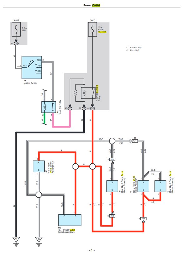

    Anyone know where the fuse is for the back of the center console's socket/12v cig port ??

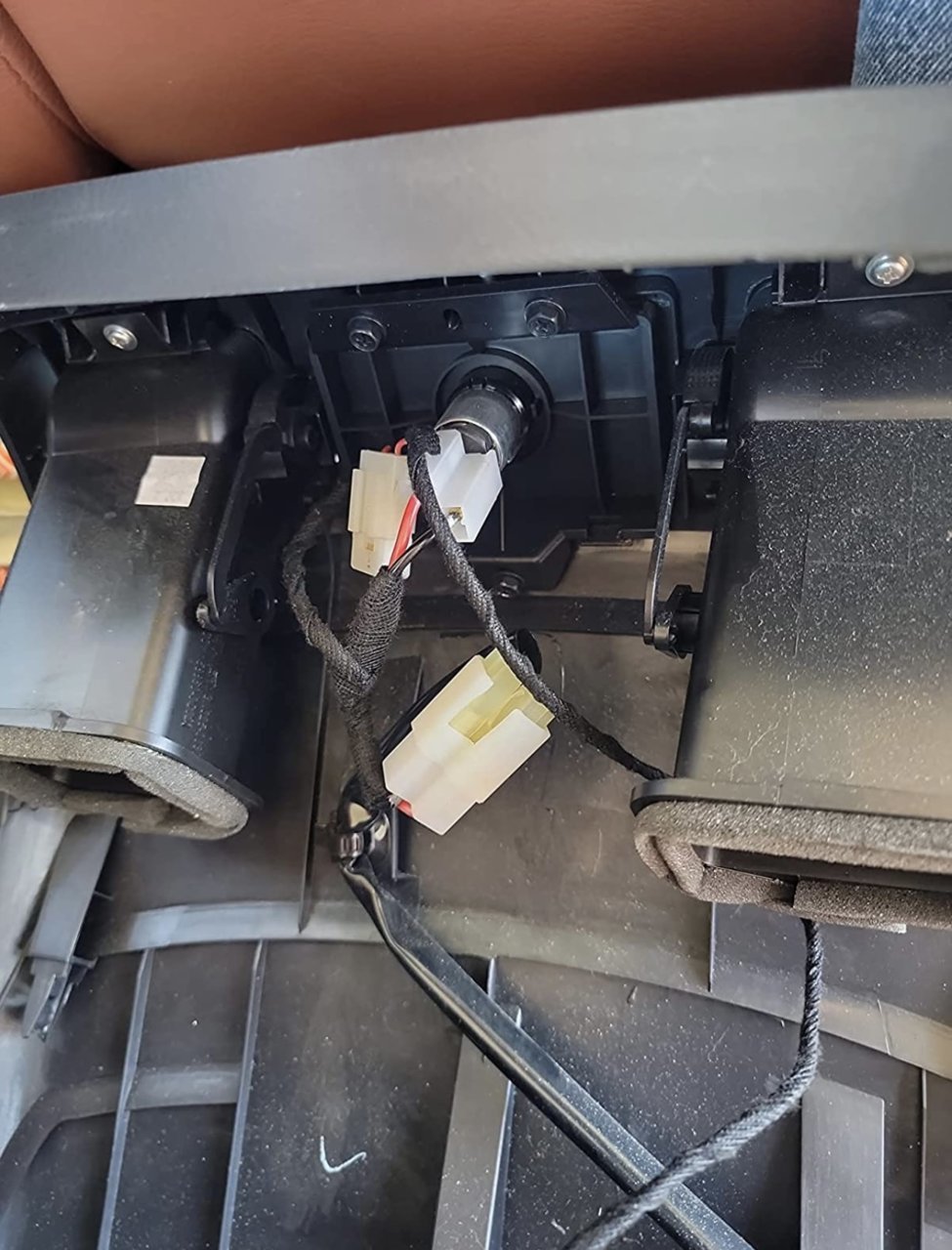

    I added the wireless charger to the top of my center console and piggybacked it off the 12v socket.
    The pigtail has a fuse but it isn't shorted
    I've checked every fuse under the dash drivers side
    Neither the charger nor the socket are getting powa
    And both were working for months

    It's crazy
    I've literally checked every single flipping fuse in all 3 fuse box locations and not one has been shorted/burned
    Every single one is perfectly fine
    Going to take apart the console again in a bit and check all the wiring. Perhaps a rat has chewed something off

    Are the front dash sockets getting power?

    Yes

    That's odd.
    Maybe you have a bad connection in the adapter for the charger.
    It plugs into the existing wiring for the rear outlet.
    Pull the console back off and check those connections..
    Maybe even check the OEM plug for voltage and then the adapter end that plugs into the outlet..
    Also, make sure the ground is good.

    You’ll likely have to test continuity at each fuse that supplies the console; many have had similar instances where the fuses looked fine but when testing continuity found that they were blown
