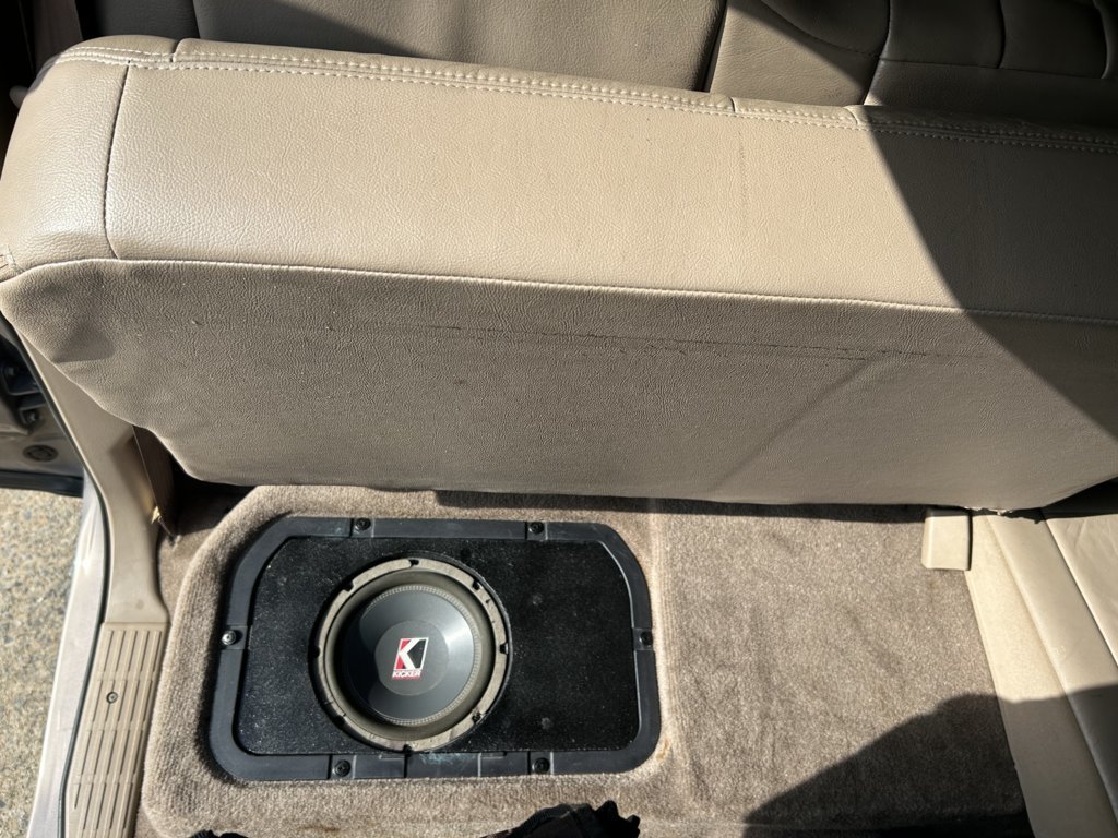

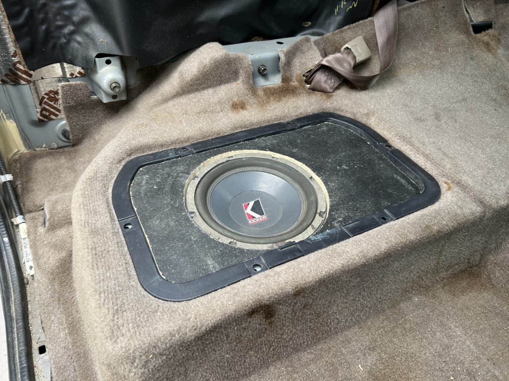

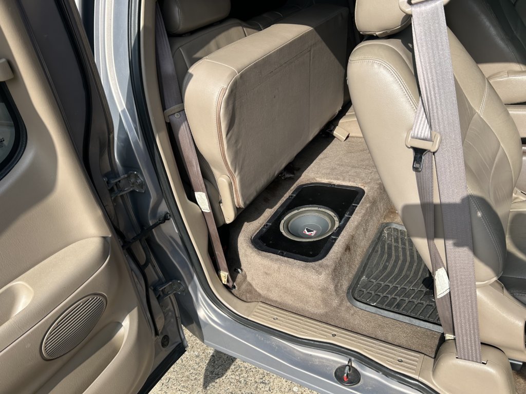

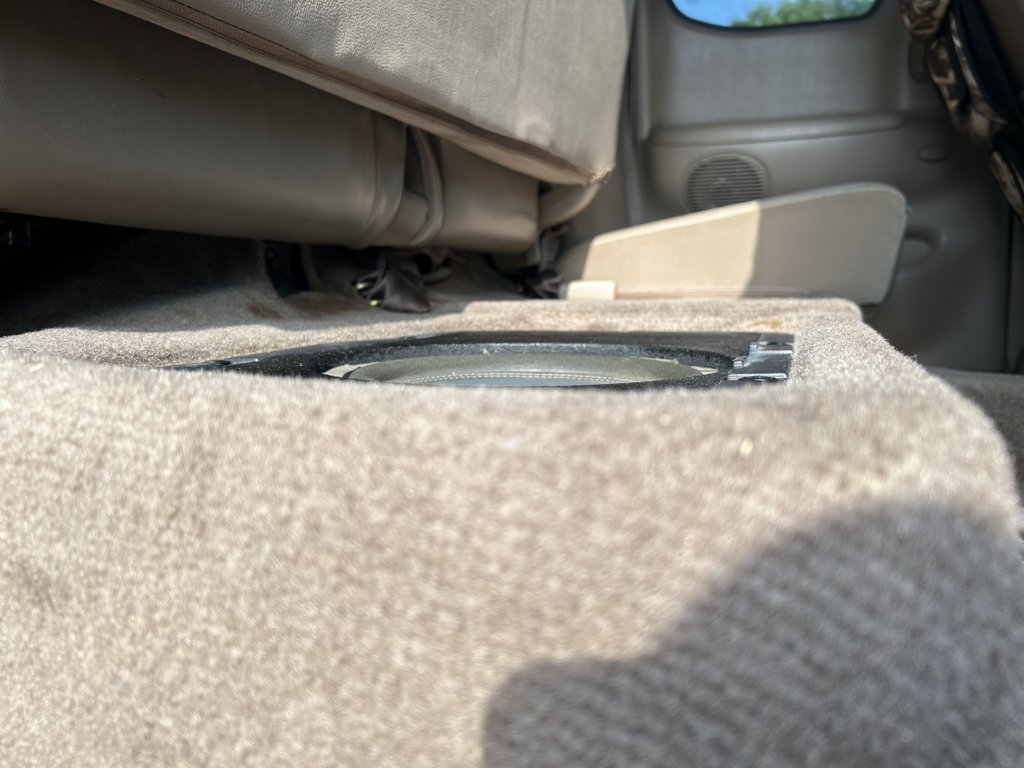

    This is a quick little thread showing you how to fit a 10'' subwoofer under the rear seat of a 1st gen access cab. This has been done before but really hasn't been covered in detail.
    These trucks have no room whatsoever, so I had to get a little creative and throw it in the passenger side storage compartment, with the amp under the seat. This actually turned out pretty good, and sounds fantastic, but does get a tad annoying if you are constantly hauling more than 3 people around. If I could go back in time I would have just bought this. But if you are on a budget, the way I am about to explain is the way to go.
    Here's everything you need. A shallow mount sub and amp of your choice, 1/4" MDF, some wiring (copper if you want the best sound) and, most importantly, a decent amount of sound deadening mat. Generic works fine, here's where I got mine. Also going to need some stainless hardware, and some felt and spray adhesive, and fiber filling. I had an old amp laying around, and everything else cost me about $200.

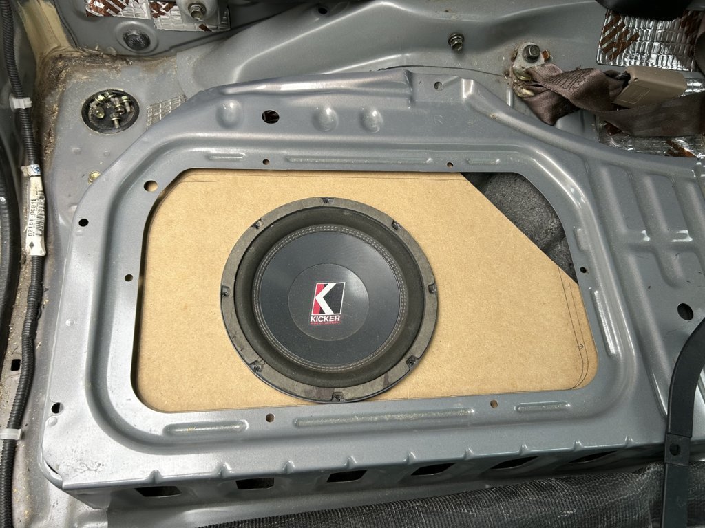

    First step is to cut the MDF to the size of the storage compartment lid. Then cut the hole in for the sub. After you have the cuts and sized perfect, you can cover the MDF in felt or carpeting. I got mine from JoAnns. Also, if you want be a little bit extra, you can get some foam tape and put it around the bottom edge for a better seal.IMG_8553.HEIC.jpg
    Now here comes the hardest and most time consuming part. After pulling back the carpet, you will see that the "compartment" completely littered with holes. YOU HAVE TO COVER EVERY SINGLE ONE WITH THE SOUND TAPE IF YOU WANT THIS TO SOUND GOOD. There are gaps everywhere, even towards the back where you can't see. Use a pencil and poke around to find all the gaps. Fill them with the sound deadening tape. This is honestly the step that made me regret doing this whole thing. However, if you have the time, and have limited budget, this is still the way to go.
    Now I ran my wires to the other side of the truck, because I only had a power cable long enough for the amp to be under the drivers side. You can really run it to either side, under the carpet, then under the plastic trim, and out to wherever it needs to go. There are countless videos on YouTube that can help teach you how to wire a sub and amp. Just give yourself a little slack.

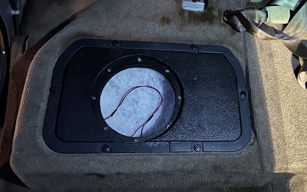

    Now you can start putting everything back together. Carpet gets tucked back in under the the floor trim, and then pack the compartment with fiber filling. The filling makes the subwoofer operate like it is in a larger enclosure. Connect your wires to the actual sub, and then use your hardware and screw down the MDF. You can use the existing holes, and drill a couple more if you want.
    Here's the final product. I ended up taking the grate off because it was digging into the seat when it was down. Now I just turn the sub off if I have people sitting on it. Turned out pretty decent, and the sound is great. Most importantly, it looks like it somewhat belongs there. No exposed wires or any other loose ends. This was my main concern when beginning this project, and is why I took the extra steps to make it come out better.

    Good content. As someone who went with the Q-Logic dual 8 setup (pics of my install), but I'd love something more like this.
    Some questions for you, if you have time:
    As far as airspace goes, what is your actual vs. recommended on the sub?
    Is there a reason you didn't under-mount the sub on the bottom of the MDF so the cone has more cone travel ....
    Or any reason you didn't under-mount the baffle board inside the compartment vs. outside ...
    Or under-mount the baffle board and the sub for extra-extra throw and allow the seat fully down?
    I realize you're sacrificing airspace with any of these steps, but you can easily remove the metal cage, so bolting the baffle to the cage and/or under-mount would be no big deal if your 10" sub was made shallow-mount and-or shallow overall profile as-is.

    It's hard to see in the pictures, but the bottom of the compartment is angled. I thought about mounting the sub or the wood under instead of over, but there is absolutely no room. Even with it mounted how I have it, the end of the sub is like 3mm from touching. As for airspace, I did this about 4 months ago, so I don't remember exact numbers, but the weird shape of the box made it hard to measure. I am pretty sure it was something close to .75cu ft. The sub states it needs 1.0-2.4 cu. ft. to operate properly. But even with the lacking space, it works just fine.

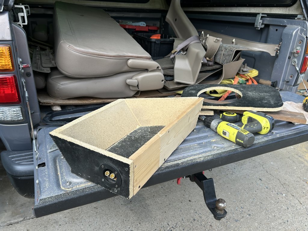

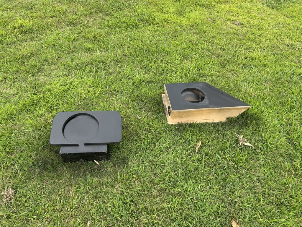

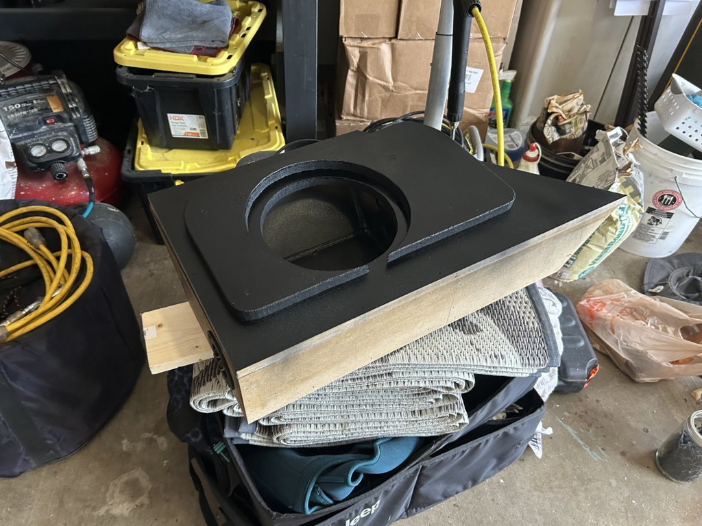

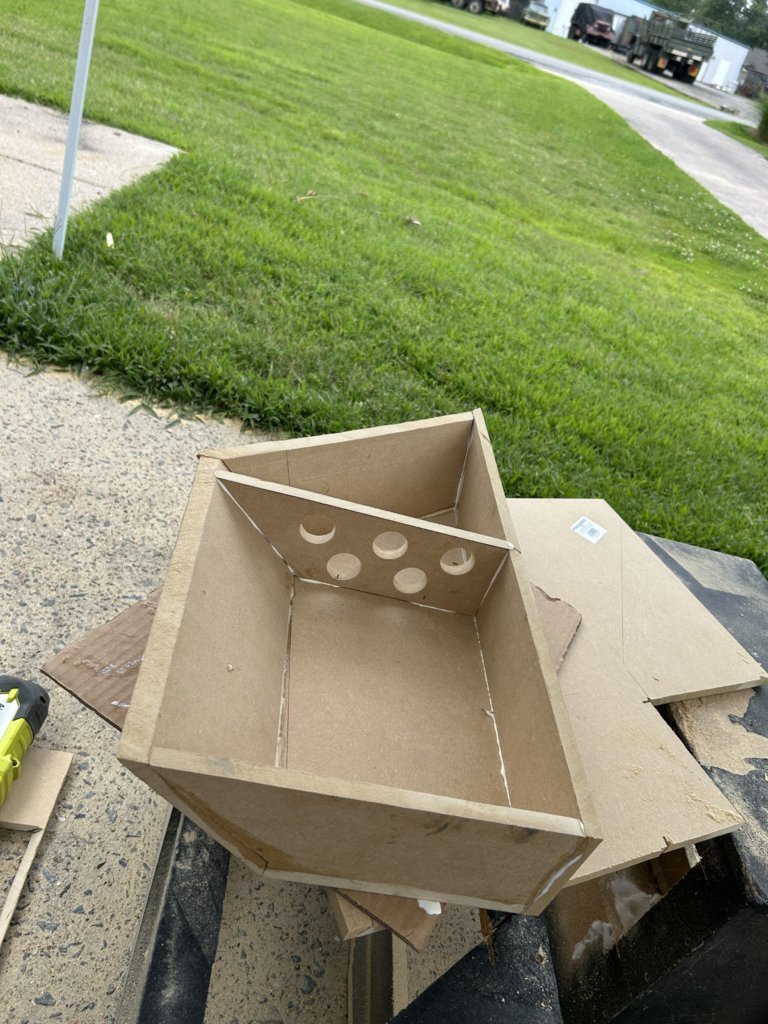

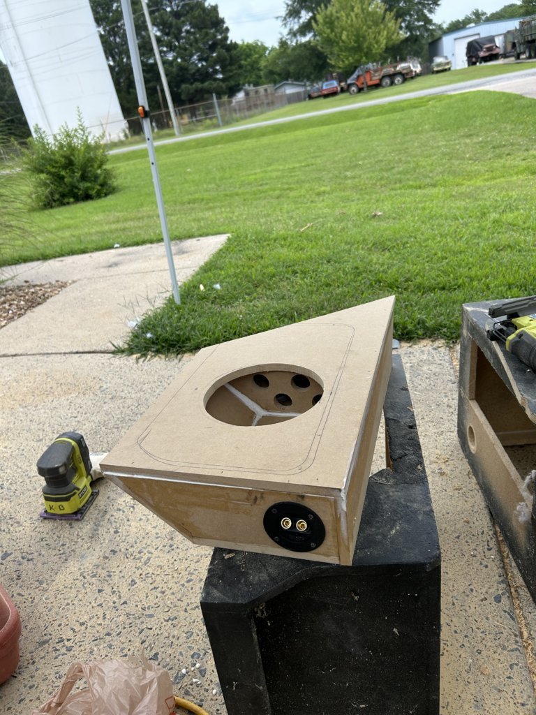

    Adding my storage compartment box build here as the "right way to add a sub to an AC". I actually built a box to fit in the space. Journey starts here and walks through all the steps, I'll list them here as well.
    https://www.tundras.com/threads/ode-to-fgt-a-refresh-story.144308/page-12#post-3945718
    I finished my sub box today, waiting for the glue and caulk to dry before firing it up. Went ahead and installed it after the finish dried. Will load the sub tomorrow. This has been 15 years in the making. Always wanted to build a box in the storage cubby. This Solabaric 8 is a good candidate. Needs 0.44cuft of airspace. I used caveman math and trial and error to build this box. Old skool with my skillsaw and jigsaw. One 2x4ft sheet of 1/2” mdf, some glue, brad nails, caulk, bedliner and a speaker terminal.
    Started with leftover materials from 3 previous speaker boxes and came up with a box that wasn’t using the space very well, so it was short on cuft, and it also looked like ASS.
    Not that anyone will be able to see it, but I hate doing shitty work, so I grabbed a sheet of mdf and started over. Improved the angles to use more of the space and added a brace to the inside of the box to help with flex since it’s only 1/2” material
    built a “trim piece” of sorts to fill in the space of the opening and flush the speaker to prevent damage when the seat is closed.
    Then pulled all of the pieces and finished them in bedliner.
    Install complete, interior back together, carpet cleaning at a later date. Sounds great! Better than the other box, which I discovered was smaller than recommended. The box Crutchfield forced you buy with the Solobaric cause they knew you would screw it up.
    Fits great in the cubby with no movement and utilizes the factory trim ring for that OEM look. Best part is, no Tundras were harmed in the making of this box. I can lift the carpet, unbolt the storage compartment frame and remove the box if wanted returning to stock.
