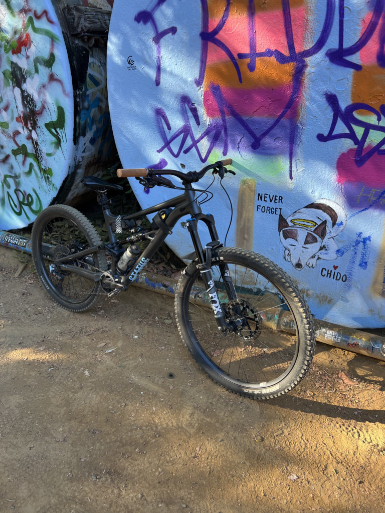

    Blang805
    Blang805 New Member
    Jul 10, 2020
    #49135
    388
    Brian
    Central Coast California
    2010 CrewMax Platinum 4x4
    Build in Signature
    Just stumbled across this thread. Mainly over on TW bikes and trucks thread bsin around but i do ride, just the red headed step child of the stumpy, a 160 status.
    Here it is in all of its aluminum glory minus carbon bars and rear hoop :hattip:

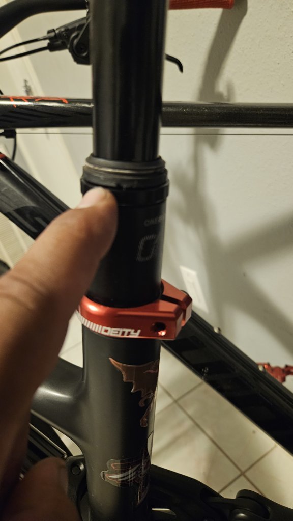

    50,813
    Just gave mine a bath last night, need to put fresh sealant later today, the OneUp rubber seal at the bottom of the dropper post keeps slipping out, the DP doesn't rise up quickly as it should, any suggestions on what to do???

    Outside of improper tension, the majority of the time that I've had problems with dropper post being slow to activate was due to the shift cable. I've used bike grease (and even white lithium grease) on the cable and that tends to do the job. I also had a kink on one my dropper post shift cables which caused it to stick, and same solution took care of it.
    My rule of thumb, if you can "feel" the cable moving or hear it traveling through the cable housing when you activate the lever, it's time to grease that sucker.

    100% agree and I'll add that the seal at the bottom of the dropper post is definitely a wear item. If it's slipping out, then in my experience it's time for a rebuild with fresh seals. Or super glue it in place, either way lol

    I just realized @TXRailRoadBandit73 mentioned the OneUP seal (I admittedly glazed over that when I first read the post). That might actually be the issue in this case, simple fix to disassemble and replace if it's worn, but might need additional grease.

    Yeah this deal keeps popping off and not staying seated
