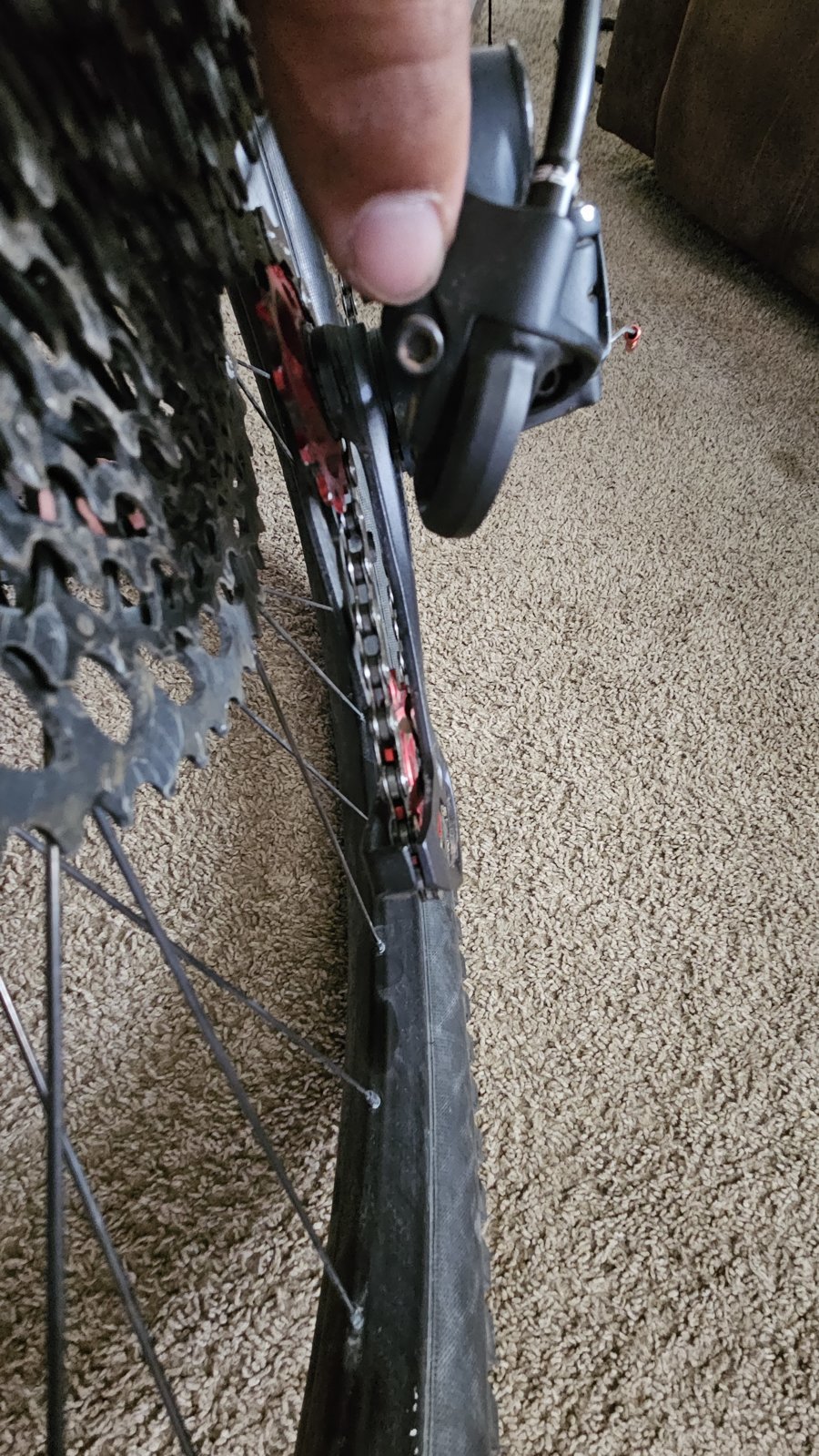

    Must need a science degree or something lol, I got it shifting all gears high to low, if I back pedal all gears chain won't come off until biggest cog
    What's this screw?
    I found the H L screws, I'm assuming this like the barrel adjuster?
  7. May 23, 2024 at 10:00 AM
    #37
    BreyTundy
    BreyTundy Big 4Lo Guy
    Sep 4, 2019
    #35600
    1,132
    Andrew
    Colorado Springs
    2016 White DC TRD
    That's your B Limit screw. It controls how far the chain wraps around the cassette. Generally that adjustment isn't as sensitive as your H&L Limit screws. If your drivetrain is running smooth now, I'd leave it and ride it and see how it goes
